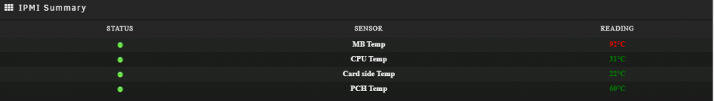

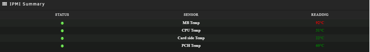

This time it might be a different sensor. @Hoopster which sensor are you seeing in System Temp plugin? It looks like it is still correlated to AUXTIN3 whatever that is. I believe we saw this last time, as I was going back through the thread to remember what we were seeing previously.
