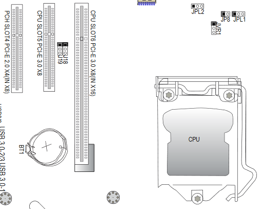

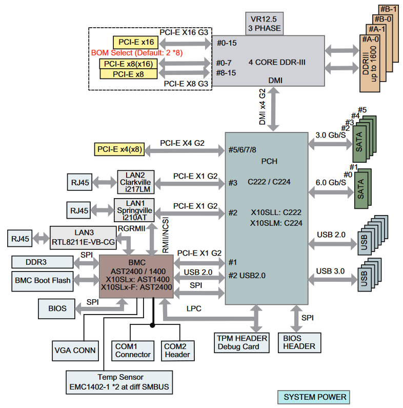

Depending upon your motherboard's design, and which slot you have the card installed, the card may be communicating with the CPU through the southbridge chipset (PCH), which might be the bottleneck. Often the PCH has a smaller pipe to the CPU, which is shared with all southbridge devices, commonly including SATA ports. If the southbridge connection is the limiting factor, then even moving a drive from the H310 to a motherboard SATA port might not make any difference if the motherboard SATA port is also going through the southbridge. I followed the link you provided to your current Unraid server (hopefully it still is current), and downloaded the manual for your mainboard. I see that there is one x16 slot (electrically x8), and two x8 slots (one x8 and the other electrically x4): It looks like the two electrically x8 slots both connect directly to the CPU, so as long as you are using either of those, I think you would be okay. The electrically x4 slot, furthest from the CPU, connects to the PCH - you should not be using this one. Looking at the system block diagram, I see that all 6 SATA ports are connected through the PCH. If the PCH is the bottleneck, and if you have the H310 correctly installed in one of the two x8 PCIe slots connected to the CPU, then moving a drive from the H310 to the motherboard may actually further slow down speeds. In that case, you may want to try the opposite, and move an array drive from the motherboard to the H310, so that you have 8 drives connected directly to the CPU, and only 4 drives connected through the PCH. Lastly, the PCH connects to the CPU via a DMI v2.0 x4 link, which is good for 2GB/s. That should be more than sufficient for 4 array drives (I'm not counting your cache), but if you have the H310 installed in the PCH connected PCIe slot, then you have 11 drives going over this link. 11 drives * 130 MB/s * 1.36 overhead = 1945 MB/s, which is suspiciously close to the 2000 MB/s limit of the DMI connection between the PCH and the CPU.
unraid-tunables-tester.sh - A New Utility to Optimize unRAID md_* Tunables
The speeds seem artificially low. My 3TB 5400 RPM constrained array can hit 140 MB/s, and your 4TB drives should be marginally faster. While 130 MB/s is close, I think you have a bottleneck somewhere. With 7 drives on your SAS 2008 controller, let's check and see if that could be the culprit. 7 * 130 * 1.36 (this is an easier version of the formula I detailed above) = 1237 MB/s going through your controller. PCIe 1.0 x8 and PCIe 2.0 x4 both support 2000 MB/s, and PCIe 1.0 x4 supports 1000 MB/s. None of that lines up with 1237 MB/s, so it doesn't seem like this is a PCIe bus related constraint. That doesn't rule out the SAS 2008 controller, though - maybe it is just slow... Perhaps you have something about your build that doesn't show up in the report. Expanders? Maybe when using all of your SATA ports on your motherboard (sdb, sdc, sdd, sde) you are hitting some kind of bus limit? 4 * 130 * 1.36 = 707 MB/s, which again doesn't really seem like a common bus limit. I think you should try @jbartlett's DiskSpeed testing tool. Other thoughts: You have one of those servers that doesn't seem to react to changing the Unraid disk tunables. Except in extreme edge cases, you get basically the same speed no matter what. On the repeated tests, most seem to be withing +/- 0.9 MB/s, which is a fairly large variation, and for that reason your fastest measured speed of 129.7 is essentially the same as anything else hitting 127+ MB/s. Also, on at least one repeated test (Pass 1_Low Test 2 @ Thresh 120 = 127.8, and Pass 2 Test 1 = 116.6), the speed variation was 11.2 MB/s, which is huge. Perhaps you had some process/PC accessing the array during one of those, bringing down the score. For that reason, I say pretty much every test result was an identical result, and you probably won't notice much of any difference between any values. There's certainly no harm in using the Fastest values, as the memory utilization is so low there's no reason for you to chase more efficiency. Keep in mind if you use jbartlett's DiskSpeed test and find the bottleneck, and you make changes to fix it, you would want to rerun UTT to see if the Fastest settings change.
