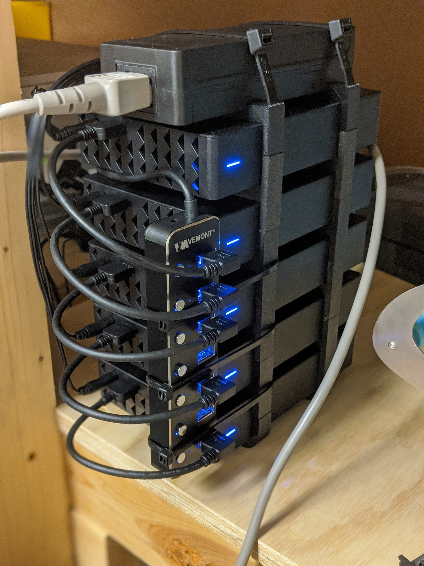

Thanks Johnnie this is exactly the info I needed. I have created a "Frankenstore" backup solution (pic below), using 5 USB 16 TB drives. These are cheap drives, at ~$310 each, and even with 3D printing an exoskeleton for portability, wiring up a single power supply, and using a 7-port USB 3.0 hub with toggle switches, my total cost for an 80 TB backup solution is under $1700. The final solution is extremely portable, making it easy to take offsite for security. The 10A 12V power supply could easily support 6 drives, and possibly even 7, so I have a bit of room to grow to 96 or even 112 TB of backup capacity in the future, though for the next year 80 TB is plenty. The toggle switches on the USB hub are really cool, as it allows me to control the power-up order and get the same disk ID each time, though I'm not sure if that matters with the BTRFS pool. Of course, at such a low cost, I am expecting drive failures. Since this is primarily just an offline backup for my main array, I'm cool with taking that risk. When I read through your linked instructions, you talk about replacing a drive, but not specifically replacing a failed drive. Is the process the same, or will it be different? I'm assuming with a JBOD, I only lose the data on the failed drive, plus any files that might have been split across two drives onto the failed drive - I don't suppose there is a way to prevent splitting files across drives in a pool, is there? Also, with Unraid v6.9 in the wings, is using UD still the right way to go? I'm running 6.8.3, and do not run beta or even RC on my production server. Do you know if my UD BTRFS JBOD pool will migrate to v6.9's new multi-pool functionality, or would I have to recreate it from scratch and re-do my backup? Thanks! Paul -
