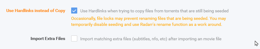

  5. Just confirming, but both the /mnt/user paths are set to /data and that you have hardlinks enabled in Radarr/Sonarr (under Settings --> Media Management)

  9. Did some further digging/testing and I think I've been able to figure out how to fix hardlinking. I think for some reason rclone is thinking of the mergefs as another filesystem (maybe because it's mounted?) and it seems setting up remote path mapping in Sonarr/Radarr fixes this: I followed the below guide: https://docs.usbx.me/books/sonarr/page/initial-setup#bkmrk-remote-path-mapping My mappings for Sonarr as follows: Within Sonarr --> Settings --> Download Clients

  11. Scrolling through this topic and noticed that I am now also having the same issue as others with Hardlinks being removed randomly (as per below post) Not 100% sure what's doing it. Possibly my mappings? I have Plex/*arrs and my Qbitorrent docker all point /cloud to /mnt/user/mount_mergerfs/gdrive_media_vfs/. Do you think I should change this and have it pointing to /mnt/user instead? Just noticed I've lost about 2TB of seeding torrents is all
