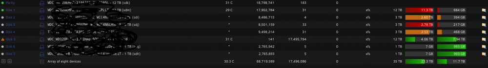

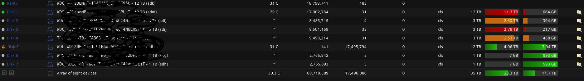

  2. I'm doing xfs_repair -v /dev/sdl do you know how long it can take on a 12tb disk with 4tb used? The strange thing is that this disk has the new partition and reconstruction from parity since it is a new disk and it dragged the same problems as with the previous disk
  3. Well tonight after rebuilding the data on the disk and rebooting unraid and for more than an hour I have been able to access the data normally but now I am back with the same error also I realized that when this happens apart from I can't see the data on disk 5 I can't write to any shared resources attached new diagnosis unraid-diagnostics-20220111-2332.zip
  4. Tonight when I open the reconstruction, I remove the usb that gives problems, restart and I get a new diagnosis, thanks

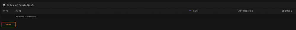

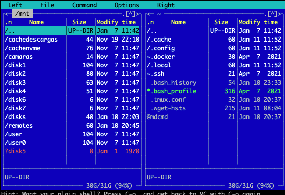

  5. Hello, first of all excuse my English, I found a week ago that I was missing many files from the array (4TB to be exact) unraid in the last parity check I found some errors, 35, which I corrected. In the list of disks, none of them marks any error for me, the smatr either, but when I access from the webgui using the folder icon to see what is inside each disk, I see that disk 5 does not show me anything. I stopped the array, I turned it on again, I went in again and for a moment all the files are seen but after a few minutes they disappear again. I changed cables and did not solve anything, now I decided to change the disk to a new one, it is doing the reconstruction but I see that the same thing happens to me they do not appear and for mc I can not access the data on disk 5 or with the new disk. Within my tests I connect the unformatted vijo disk to a linux vm within the same unraid server and I can access the data. Let's see if you can help me attached diagnosis and some capture unraid-diagnostics-20220109-1135.zip

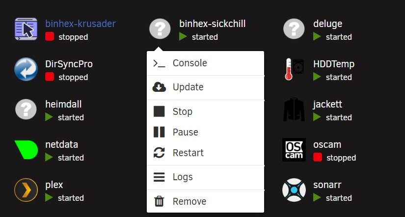

  10. Hello, I am having problems installing new apps from the community plugin, it seems that they are installed well, but in the dashboard the logo does not load and the WebUI button does not appear nor half of the options you know that it can be attached capture EDIT:a few days ago I moved the system to cache prefer before doing this I could install without problems I don't know if it will have to do

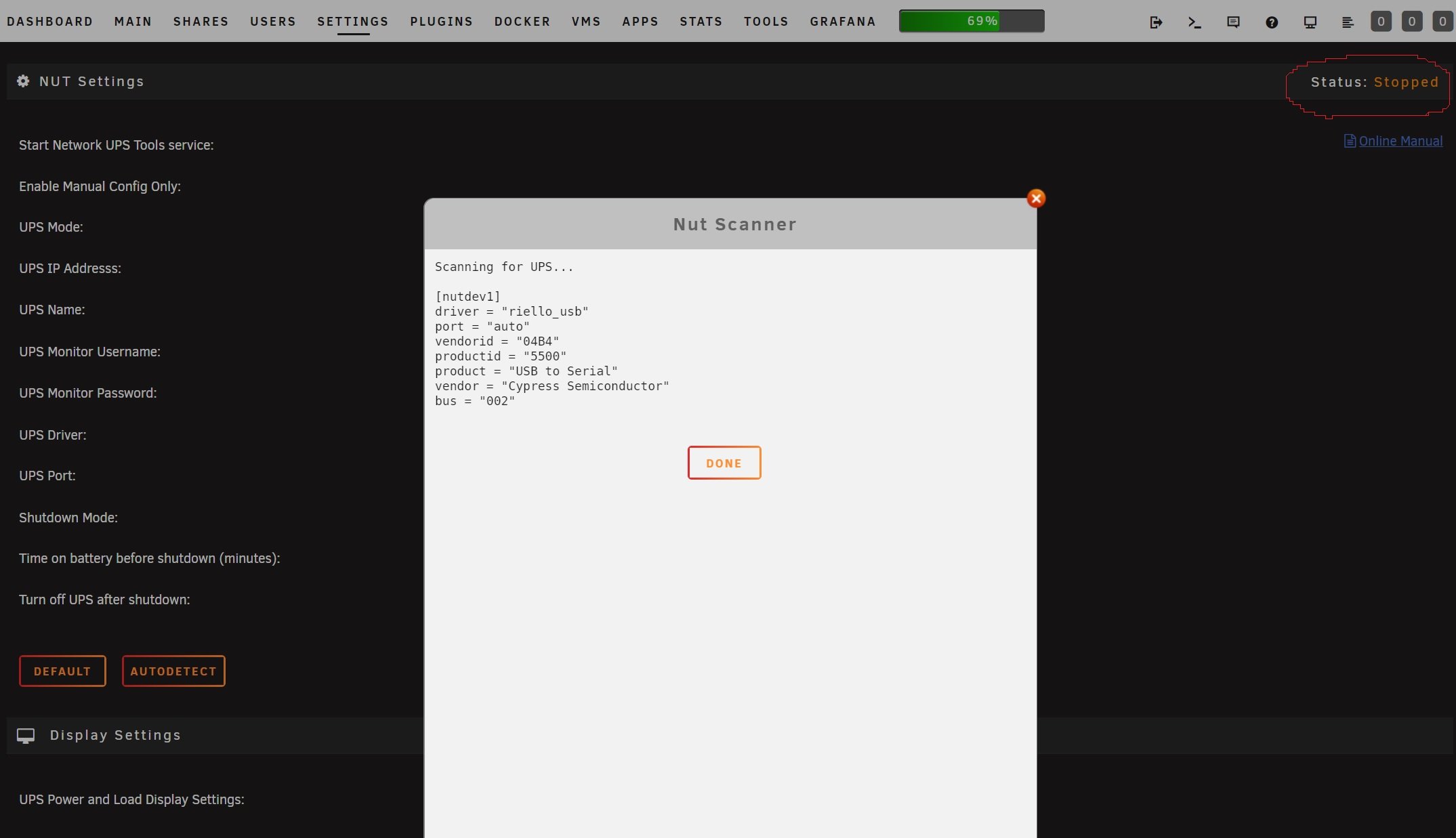

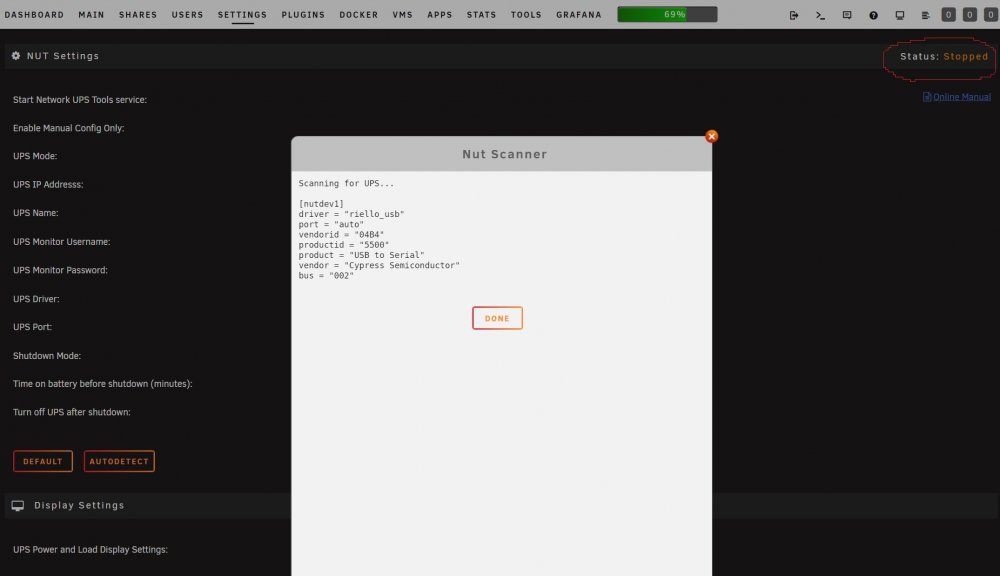

  11. Hello good, could you tell me why the NUT service does not start me, the autodetec detects the sai well but I do not want to start the service and put the generic UPS configuration as indicated and tried to restart the server and nothing attached screenshot PS Excuse me my inlges I use the translator
