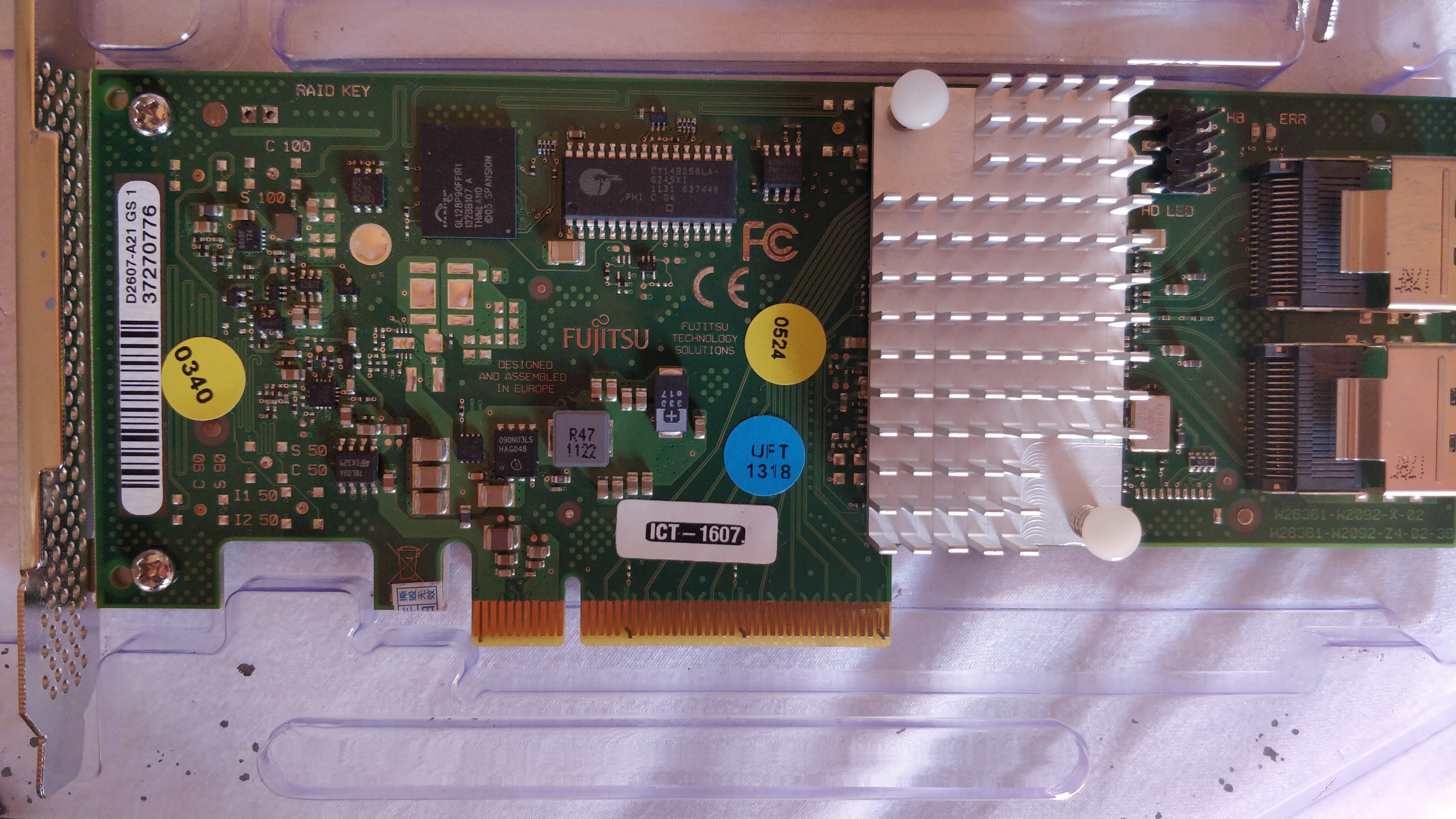

  9. I will first make sure I have the right "forward breakout" cable. But here is a picture of the card:
  10. Okay thank you. I just checked the cable I was using at is was reverse breakout, so that is definitely one reason it is not working. I have another cable lying that I think might be "forward breakout", but all I can find is, that it says "crossover". The cabel is: https://www.computersalg.dk/i/2104570/supermicro-ata-sas-kabel-md BR Mads

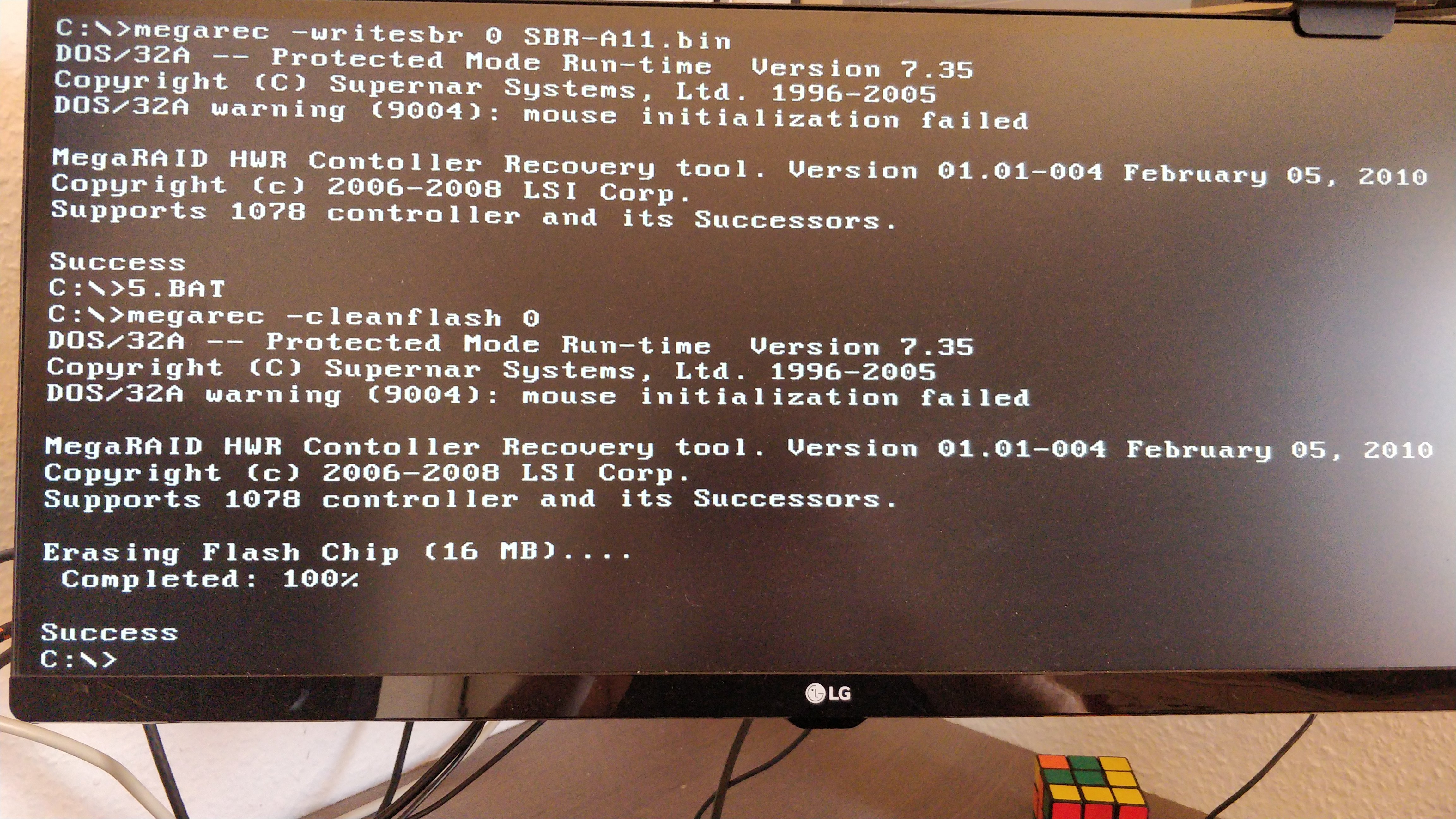

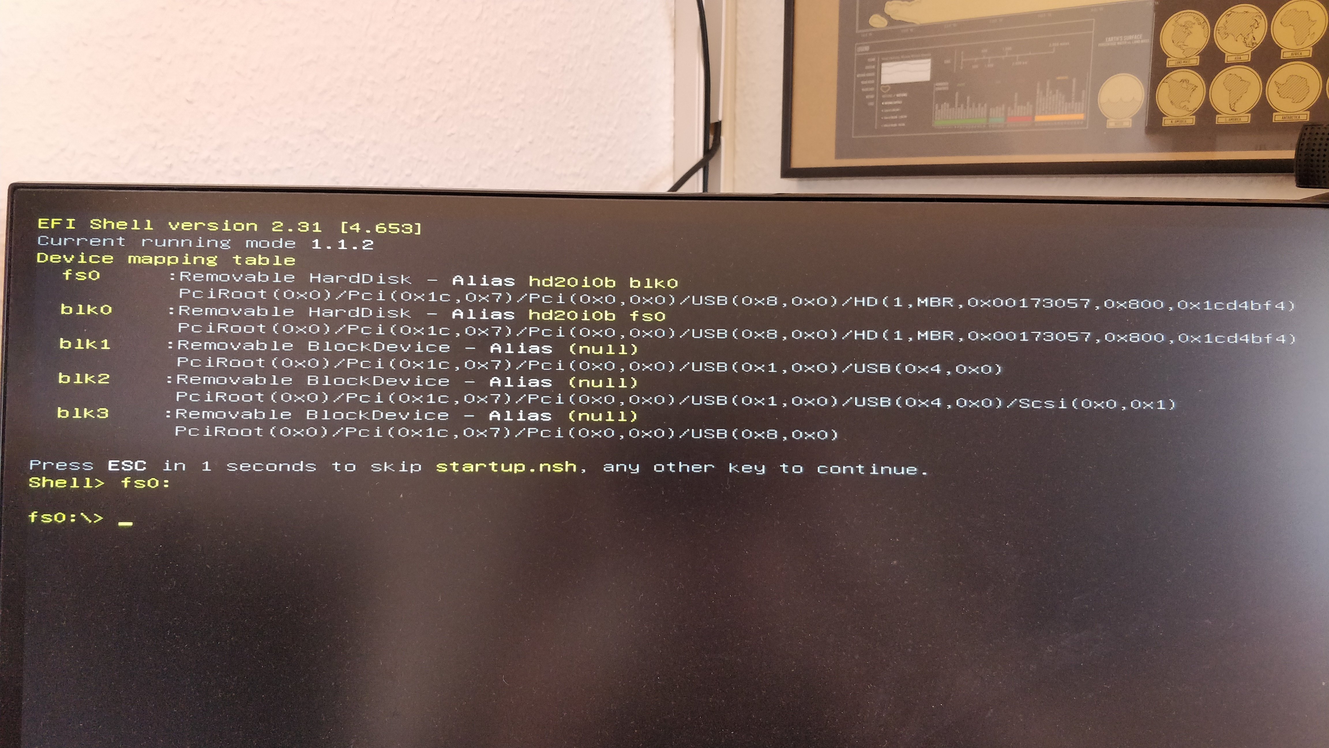

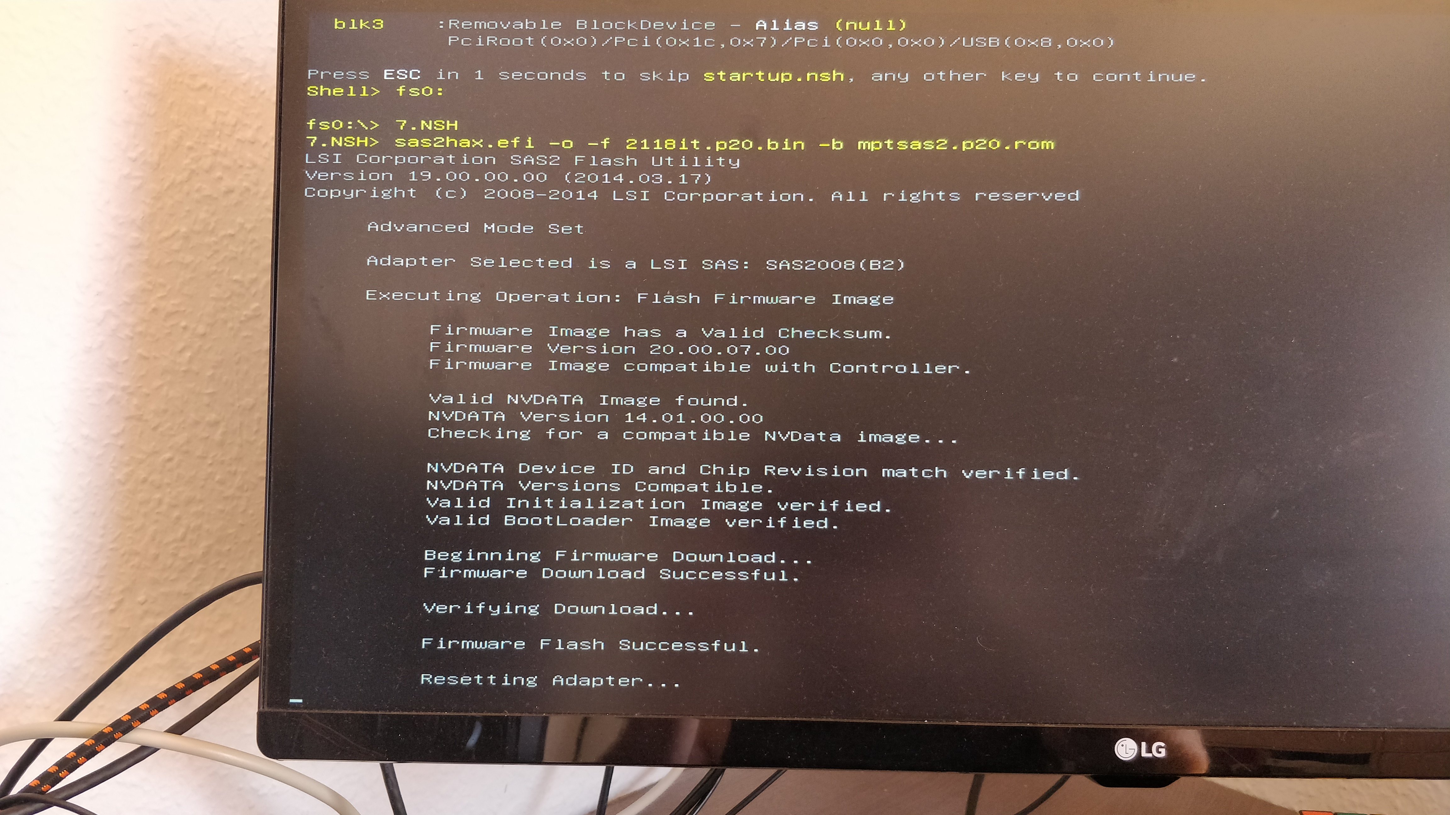

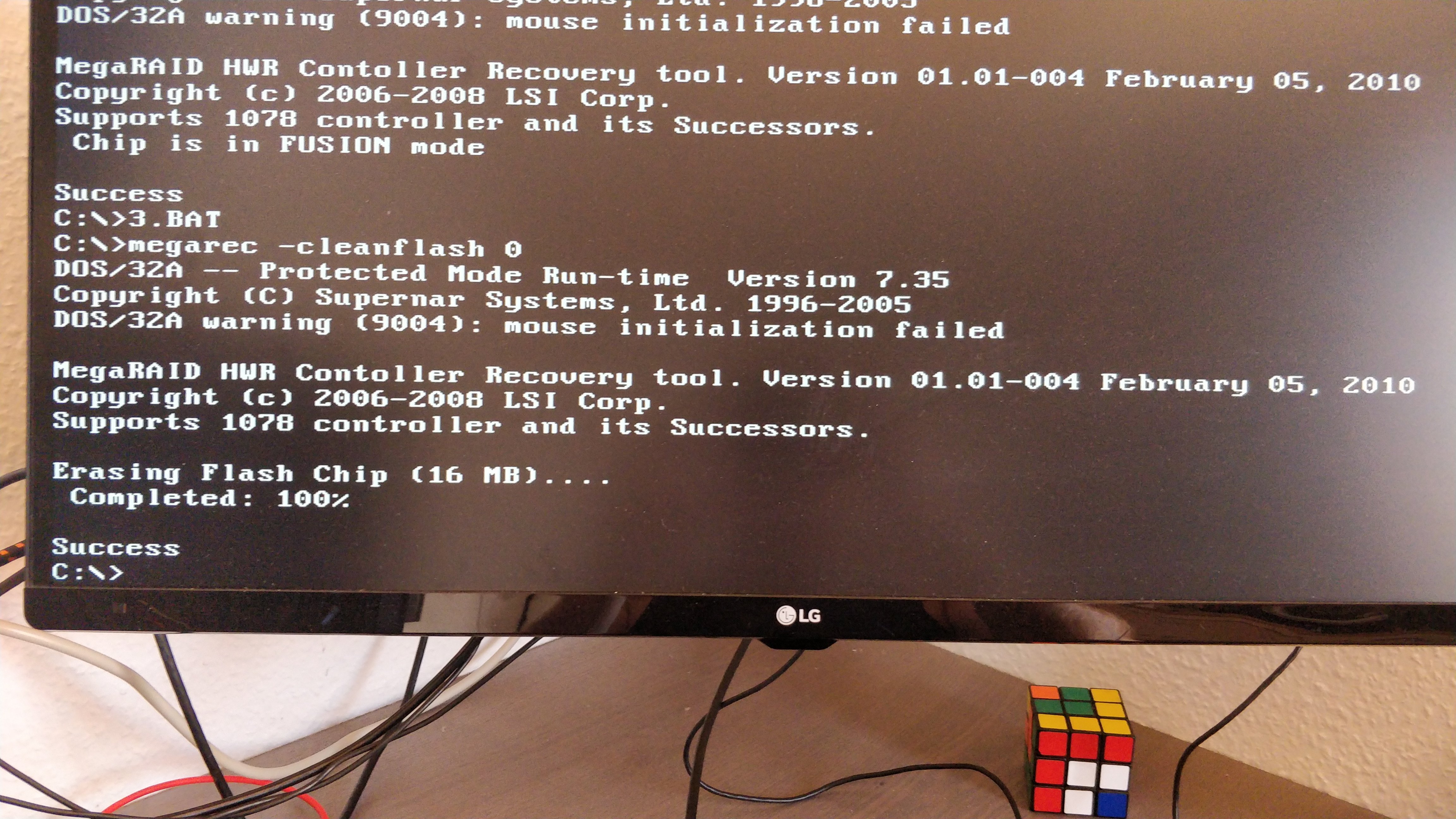

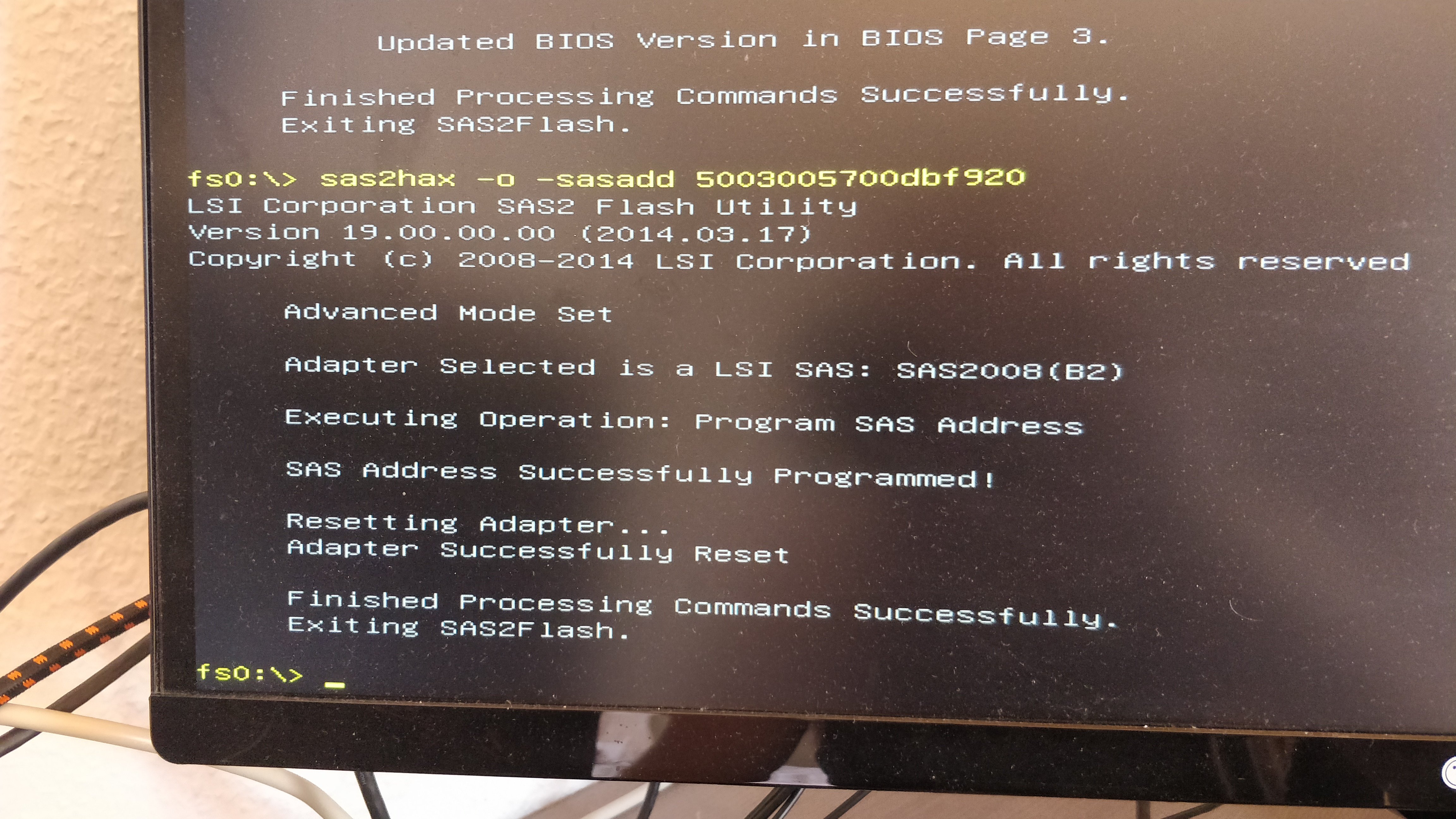

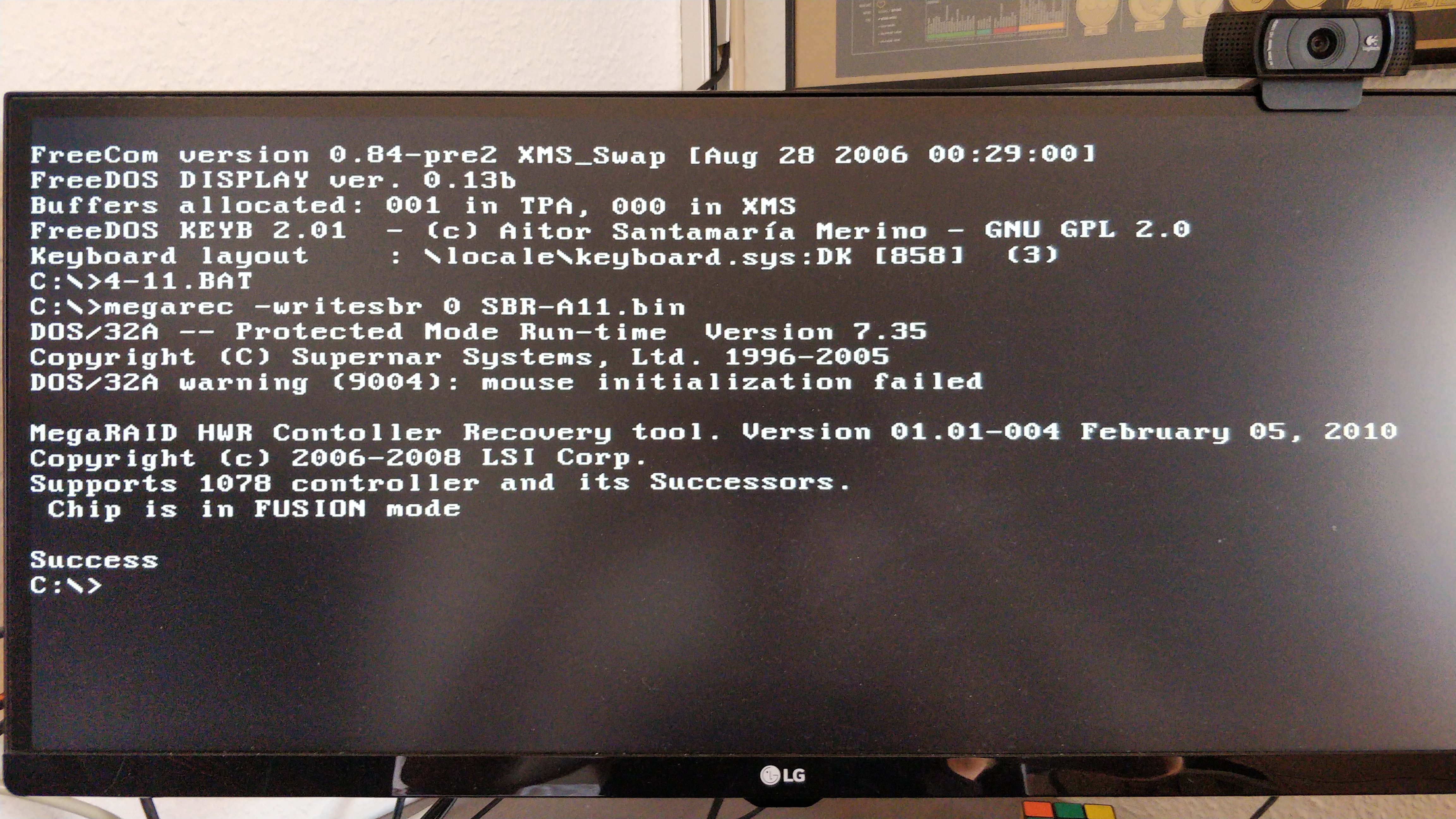

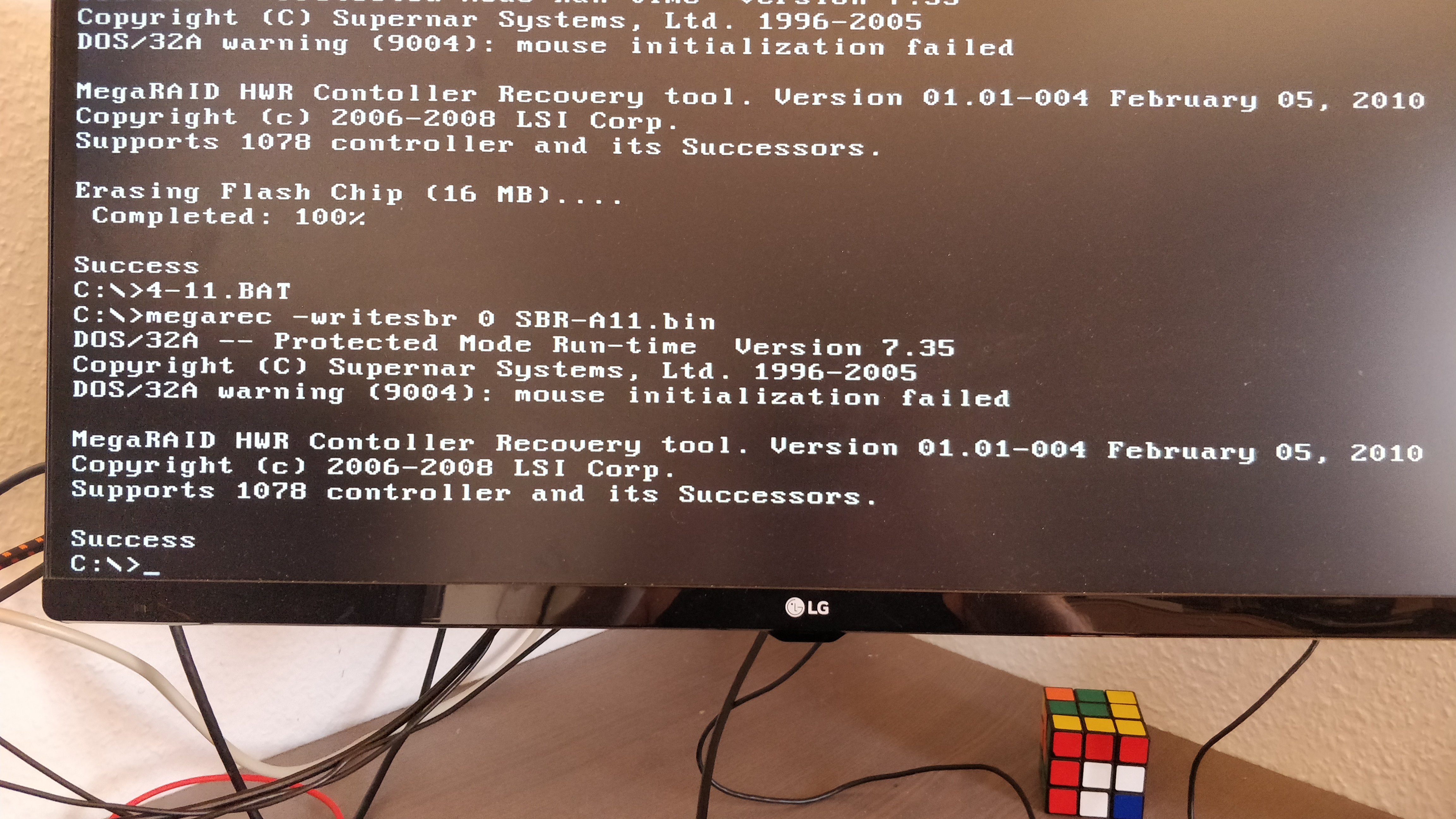

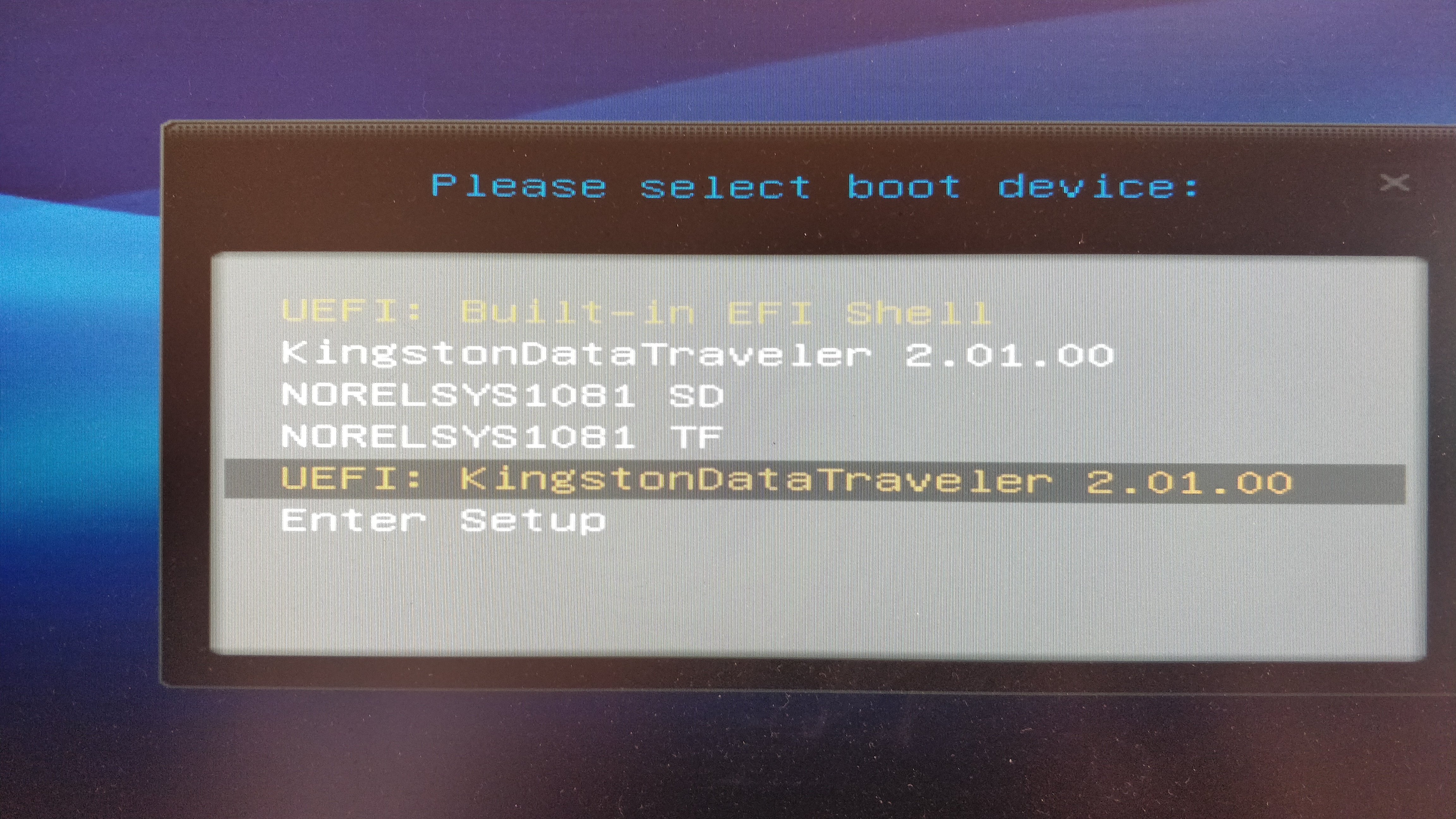

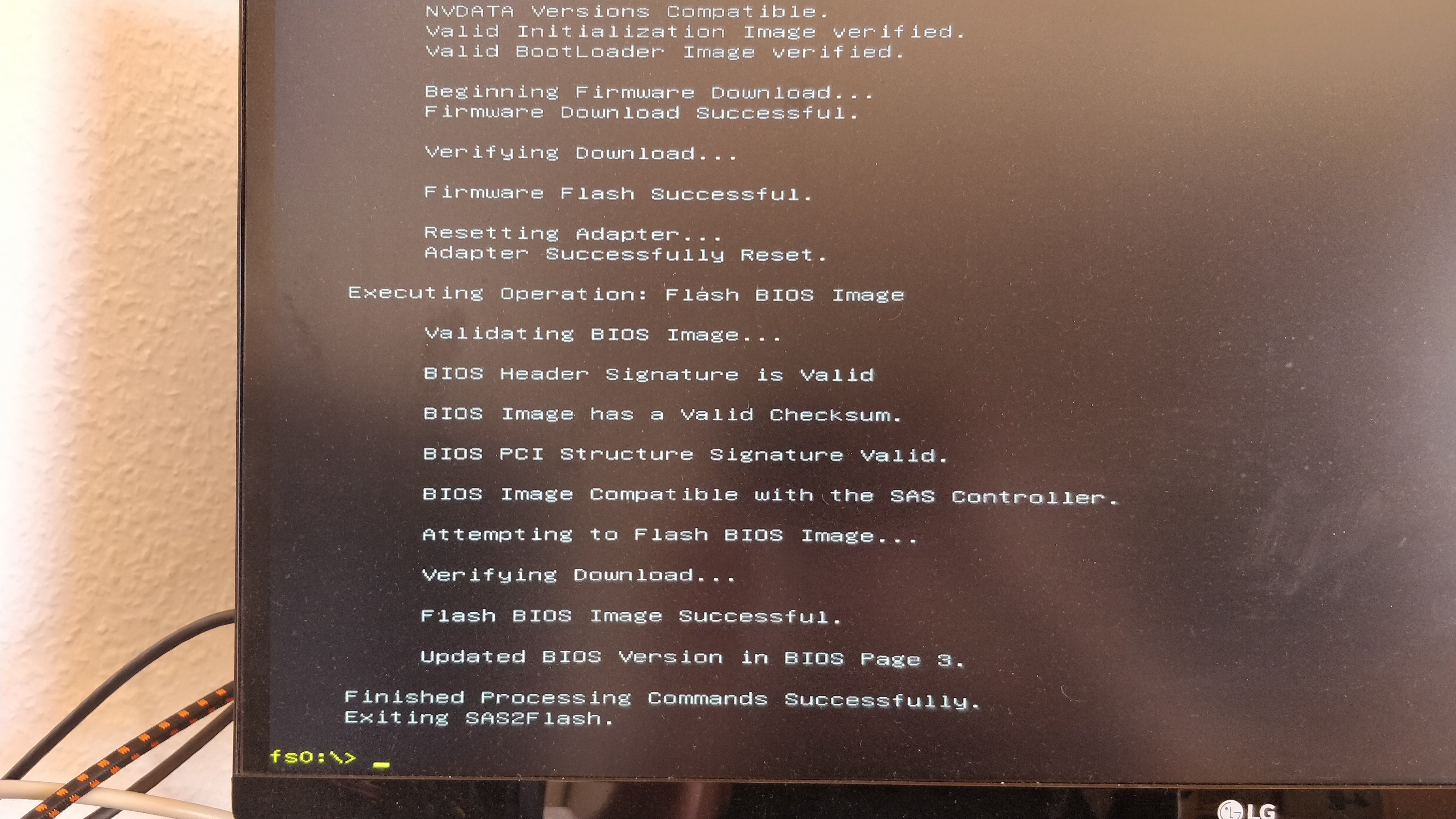

  11. Yes, I am using a SAS to SATA breakout cable. I only tried with one SATA connector, before, but now I have tried all four, with both SAS ports. None showed up. I also tried to flash it with A-11, and again tried all combinations of SAS ports and SATA connector, and again nothing showed up. I did these test on Windows 10 only. Just to make sure, that I'n not missing a step in the guide, here is how I did it: First I run "1.BAT" and "2.BAT" in DOS. I then run "3.BAT". Then "4-11.BAT" Then "5.BAT" I then reboot by pressing "Ctrl-Alt-Delete", and booting from the BIOS, where I chose to boot the USB as UEFI Inside the UEFI i choose the "fs0", since all other devices are disconnected expect fore som USB-hubs. I then run "6.NSH" It fails the adapter reset, but as per the guide, this was to be expected. Again using "Ctrl-Alt-Delete" I reboot into the UEFI, and run "7.NSH". I then program the address, and just use the one you use in your example. Last I again reboot into DOS, and run "4-11.BAT" a last time. After this, I just attach my normal boot SSD again, and test each of the SAS + SATA configurations, but to no avail. I'm sorry for the long post, but I hope that it may help to spot the problem. BR Mads

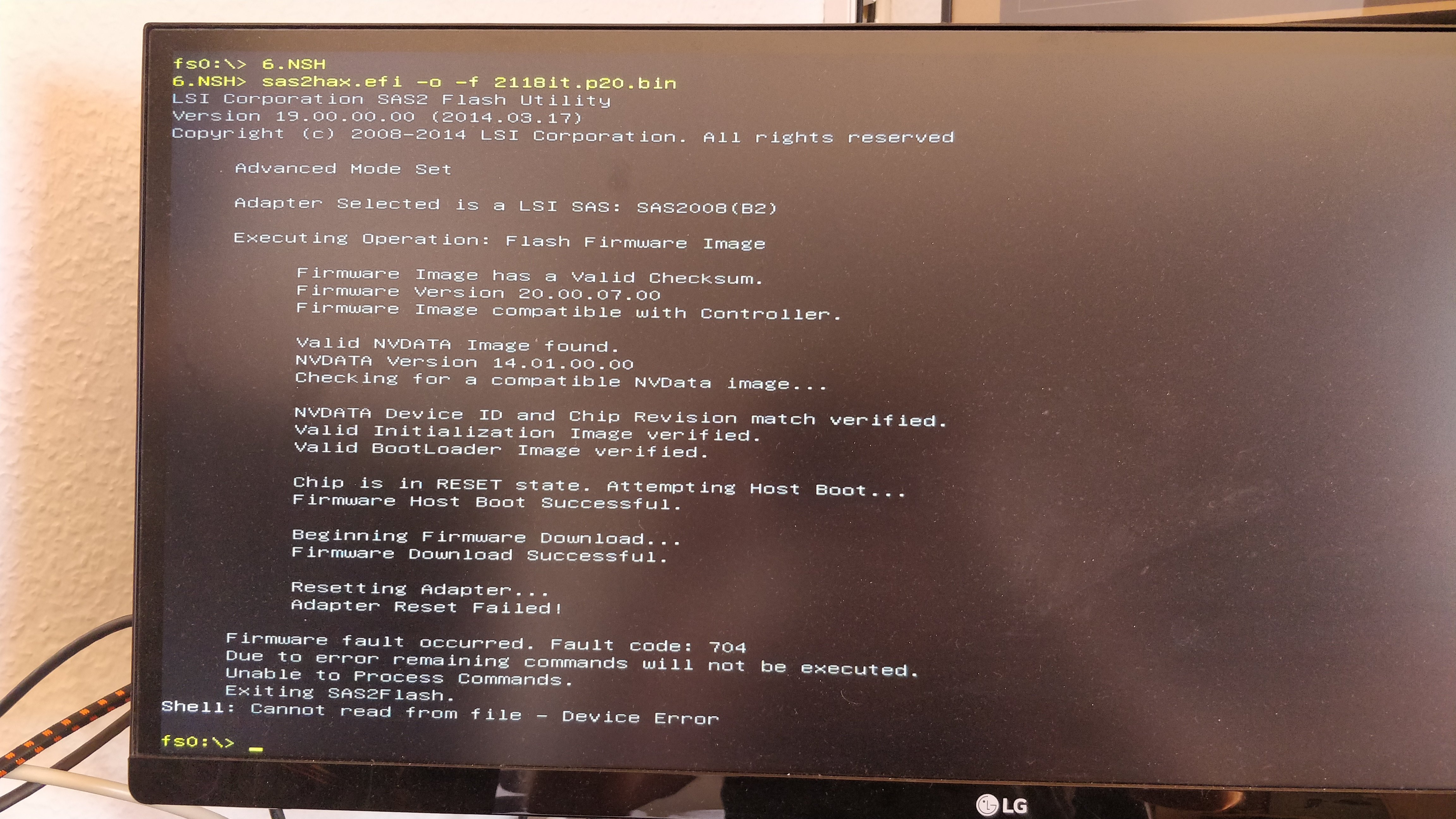

  12. It did't work unfortunately. I tried moving to another SAS port, and it did nothing. The sticker says D2607 A21, so I haven't tried the A11 yet, as I still expect it to be a A21. I've tried to move it to my unRaid server, just to see if that helped, but neither Windows og unRaid see the HDD's connected. They do however see the controller, as I can see it under "System Devices" on unRaid and under "Device Manager" in Windows. When starting on Windows it is now initializing, but just before starting is flashed the message, that "Avago MPT ROM, no supported devices found". I have another HBA card of the same model I could try, to see if it is the specific card that is something wrong with? Also is there a reason for the commands in the .bat files to not include the ".exe" extension? BR Mads
  13. Thank you for a quick answer. I'm am very new to this. I've now set the address, and run the 4-21.BAT a last time from DOS. As I understand it should now be flashed to IT-mode, and I should be able to connect HDD to it, and the computer will register them as normal drives. I'm currently testing in on Windows 10 before moving it to my unRaid server, but the harddrives are not showing up. Is it because it ONLY works on unRaid, or have I made a mistake somewhere (most likely senario). BR Mads

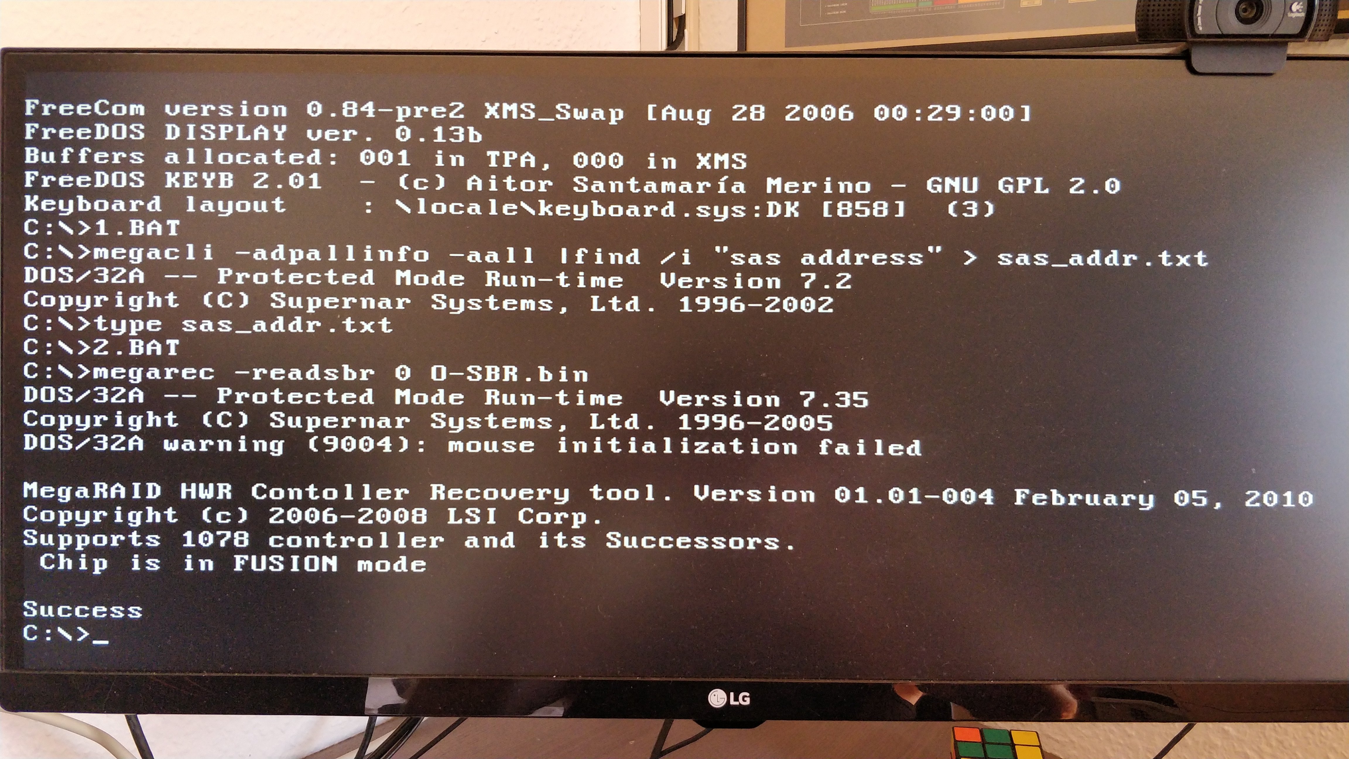

  14. Hey I moved through the steps, and it all seemed to work, but then I got to the part, there I needed the address from the .txt file, and it was empty. What do I do? BR Mads
