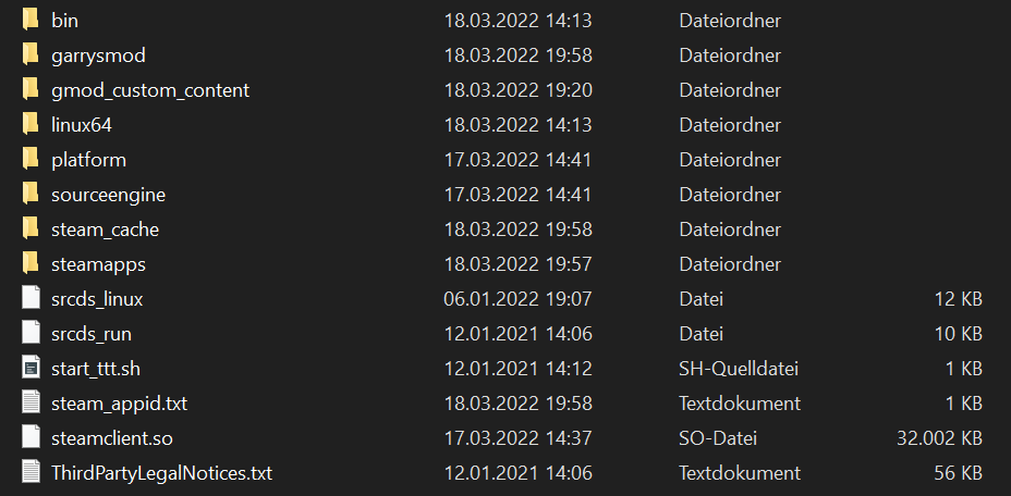

  5. So after a little bit more talking the solution was found to be moving the data folders of the needed games to the appdata/garrysmod folder with the server install and change the mount.cfg to /serverdata/serverfiles/data_folder_name for each game. Thanks again btw
  6. "mountcfg" { "cstrike" "/gmod_custom_content/css/cstrike" "tf" "/gmod_custom_content/tf2/tf" "hl2" "/gmod_custom_content/hl2/hl2" "episodic "/gmod_custom_content/hl2e1/episodic" "ep2" "/gmod_custom_content/hl2e2/ep2" "hl1mp" "/gmod_custom_content/hl_deathmatch_source" } gmod_custom_content is a folder at the root of the gmod folder Everything has been downloaded on my old ubuntu server using Steamcmd. It has been moved using Windows though. Used TheForest for a while, but completely removed all files before installing garrysmod, including the steamcmd folder
  7. Everything else works, maps are downloaded, settings are working, but the css files dont seem to work
  8. I took my old settings and config files and put them into the gmod install in the container, adjusted the start parameters and then downloaded the cs:source files and moved them to a separate folder. i then created a path that linked to it and set the path in the mount.cfg
  9. So I Installed your GarrysMod Docker but i cant seem to get the CSS Files mounted. Everything else is working just fine, except for that. Any help on how to do the mount.cfg setup in the container?
