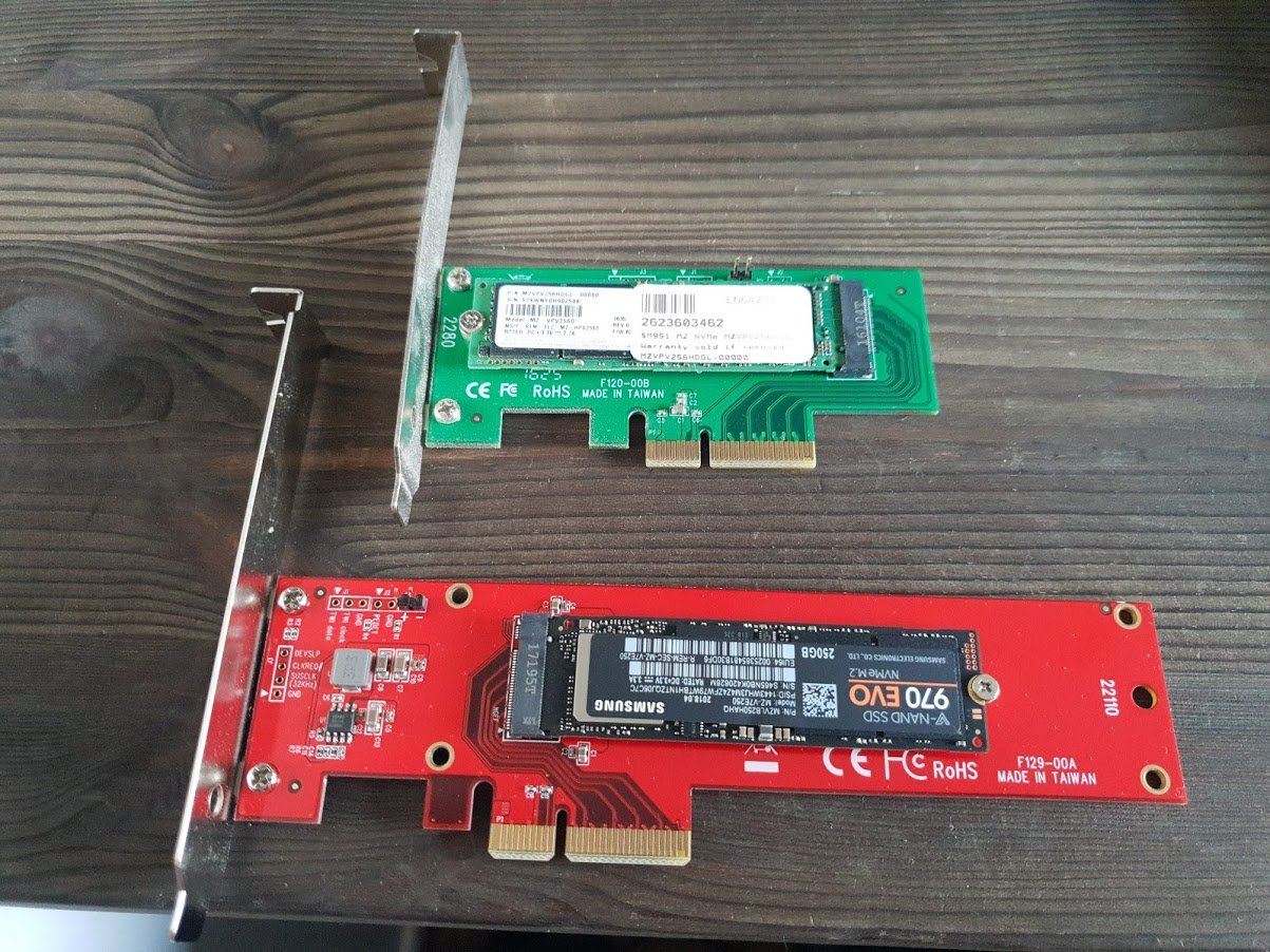

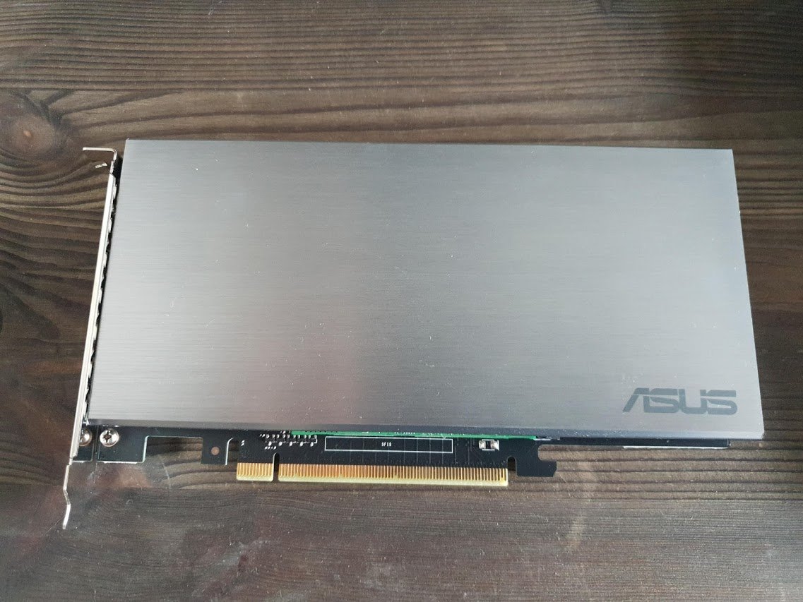

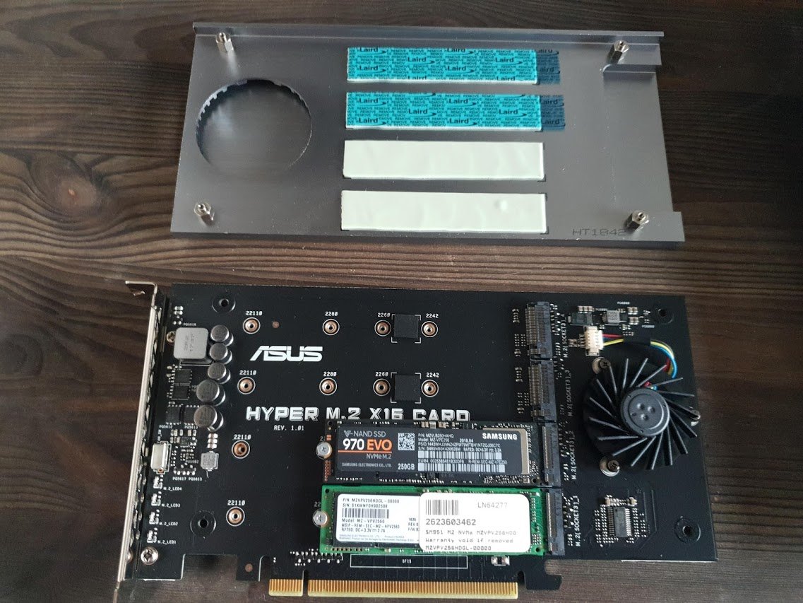

  24. So its arrived and fitted, and.. Success! You DO NOT need an x299 based motherboard for this card to work, only a montherboard\cpu capable of splitting an x16 slot into 4x4x4x4x. This was found in my PCIe settings in the BIOS. Even better, each NVMe device is still in its own IOMMU group: IOMMU group 47: [144d:a802] 81:00.0 Non-Volatile memory controller: Samsung Electronics Co Ltd NVMe SSD Controller SM951/PM951 (rev 01) IOMMU group 48: [144d:a808] 82:00.0 Non-Volatile memory controller: Samsung Electronics Co Ltd NVMe SSD Controller SM981/PM981 Only thing i had to to after installing was to update a VMs XML which has the 970evo passed through to it with the new PCIe address. So, ive free'd up a PCIe slot, and have the option to add 2 more NVMe devices in the future without much hastle at all.
