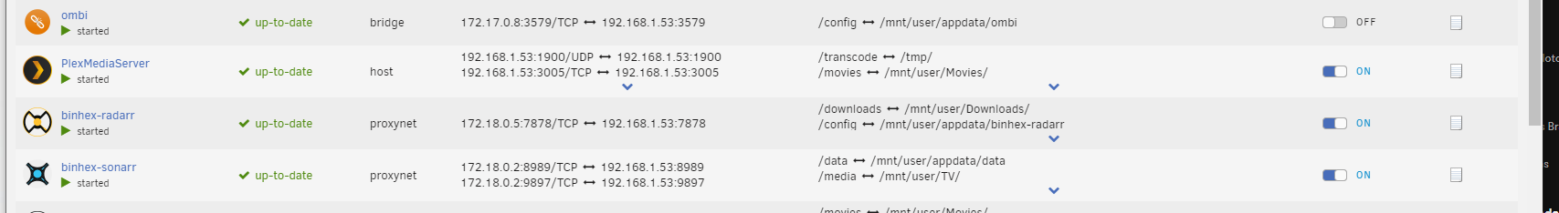

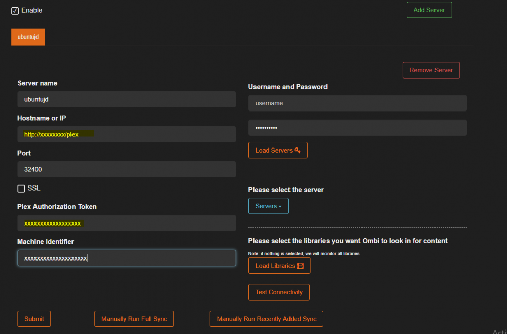

  8. Hello, I've installed the linuxserver/ombi docker and i'm having a hard time with the Plex auth process. No matter what i try, i cannot reach the Plex server and load the libraries. Below you can see the dockers network config: Inside Ombi config page I entered Plex login credentials, select the server and I overwrite the hostname with my Plex reverse proxy docker. I also tried to insert the Plex auth token from the XML view from a Plex file in the server: Any suggestions would be appreciated. Thanks in advance. Ombi's docker log: Could not test Plex System.Net.Http.HttpRequestException: An error occurred while sending the request. ---> System.IO.IOException: The server returned an invalid or unrecognized response. at System.Net.Http.HttpConnection.FillAsync() at System.Net.Http.HttpConnection.ReadNextResponseHeaderLineAsync(Boolean foldedHeadersAllowed) at System.Net.Http.HttpConnection.SendAsyncCore(HttpRequestMessage request, CancellationToken cancellationToken) --- End of inner exception stack trace --- at System.Net.Http.HttpConnection.SendAsyncCore(HttpRequestMessage request, CancellationToken cancellationToken) at System.Net.Http.HttpConnectionPool.SendWithNtConnectionAuthAsync(HttpConnection connection, HttpRequestMessage request, Boolean doRequestAuth, CancellationToken cancellationToken) at System.Net.Http.HttpConnectionPool.SendWithRetryAsync(HttpRequestMessage request, Boolean doRequestAuth, CancellationToken cancellationToken) at System.Net.Http.RedirectHandler.SendAsync(HttpRequestMessage request, CancellationToken cancellationToken) at System.Net.Http.HttpClient.FinishSendAsyncBuffered(Task`1 sendTask, HttpRequestMessage request, CancellationTokenSource cts, Boolean disposeCts) at Ombi.Api.OmbiHttpClient.SendAsync(HttpRequestMessage request) in C:\projects\requestplex\src\Ombi.Api\OmbiHttpClient.cs:line 61 at Ombi.Api.Api.Request[T](Request request) in C:\projects\requestplex\src\Ombi.Api\Api.cs:line 38 at Ombi.Api.Plex.PlexApi.GetStatus(String authToken, String uri) in C:\projects\requestplex\src\Ombi.Api.Plex\PlexApi.cs:line 97 at Ombi.Controllers.External.TesterController.Plex(PlexServers settings) in C:\projects\requestplex\src\Ombi\Controllers\External\TesterController.cs:line 272 [40m[32minfo[39m[22m[49m: Ombi.Schedule.Jobs.Plex.PlexContentSync[0] Starting Plex Content Cacher Recently Added Scan [40m[32minfo[39m[22m[49m: Ombi.Schedule.Jobs.Plex.PlexContentSync[0] Starting to cache the content on server ubuntujd [40m[1m[33mwarn[39m[22m[49m: Ombi.Schedule.Jobs.Plex.PlexContentSync[2008] Exception thrown when attempting to cache the Plex Content in server ubuntujd System.Net.Http.HttpRequestException: An error occurred while sending the request. ---> System.IO.IOException: The server returned an invalid or unrecognized response. at System.Net.Http.HttpConnection.FillAsync() at System.Net.Http.HttpConnection.ReadNextResponseHeaderLineAsync(Boolean foldedHeadersAllowed) at System.Net.Http.HttpConnection.SendAsyncCore(HttpRequestMessage request, CancellationToken cancellationToken) --- End of inner exception stack trace --- at System.Net.Http.HttpConnection.SendAsyncCore(HttpRequestMessage request, CancellationToken cancellationToken) at System.Net.Http.HttpConnectionPool.SendWithNtConnectionAuthAsync(HttpConnection connection, HttpRequestMessage request, Boolean doRequestAuth, CancellationToken cancellationToken) at System.Net.Http.HttpConnectionPool.SendWithRetryAsync(HttpRequestMessage request, Boolean doRequestAuth, CancellationToken cancellationToken) at System.Net.Http.RedirectHandler.SendAsync(HttpRequestMessage request, CancellationToken cancellationToken) at System.Net.Http.HttpClient.FinishSendAsyncBuffered(Task`1 sendTask, HttpRequestMessage request, CancellationTokenSource cts, Boolean disposeCts) at Ombi.Api.OmbiHttpClient.SendAsync(HttpRequestMessage request) in C:\projects\requestplex\src\Ombi.Api\OmbiHttpClient.cs:line 61 at Ombi.Api.Api.Request[T](Request request) in C:\projects\requestplex\src\Ombi.Api\Api.cs:line 38 at Ombi.Api.Plex.PlexApi.GetLibrarySections(String authToken, String plexFullHost) in C:\projects\requestplex\src\Ombi.Api.Plex\PlexApi.cs:line 120 at Ombi.Schedule.Jobs.Plex.PlexContentSync.GetAllContent(PlexServers plexSettings, Boolean recentlyAddedSearch) in C:\projects\requestplex\src\Ombi.Schedule\Jobs\Plex\PlexContentSync.cs:line 577 at Ombi.Schedule.Jobs.Plex.PlexContentSync.ProcessServer(PlexServers servers, Boolean recentlyAddedSearch) in C:\projects\requestplex\src\Ombi.Schedule\Jobs\Plex\PlexContentSync.cs:line 152 at Ombi.Schedule.Jobs.Plex.PlexContentSync.StartTheCache(PlexSettings plexSettings, Boolean recentlyAddedSearch) in C:\projects\requestplex\src\Ombi.Schedule\Jobs\Plex\PlexContentSync.cs:line 130 [40m[32minfo[39m[22m[49m: Ombi.Schedule.Jobs.Plex.PlexContentSync[0] Finished Plex Content Cacher, with processed content: 0, episodes: 0. Recently Added Scan: True
