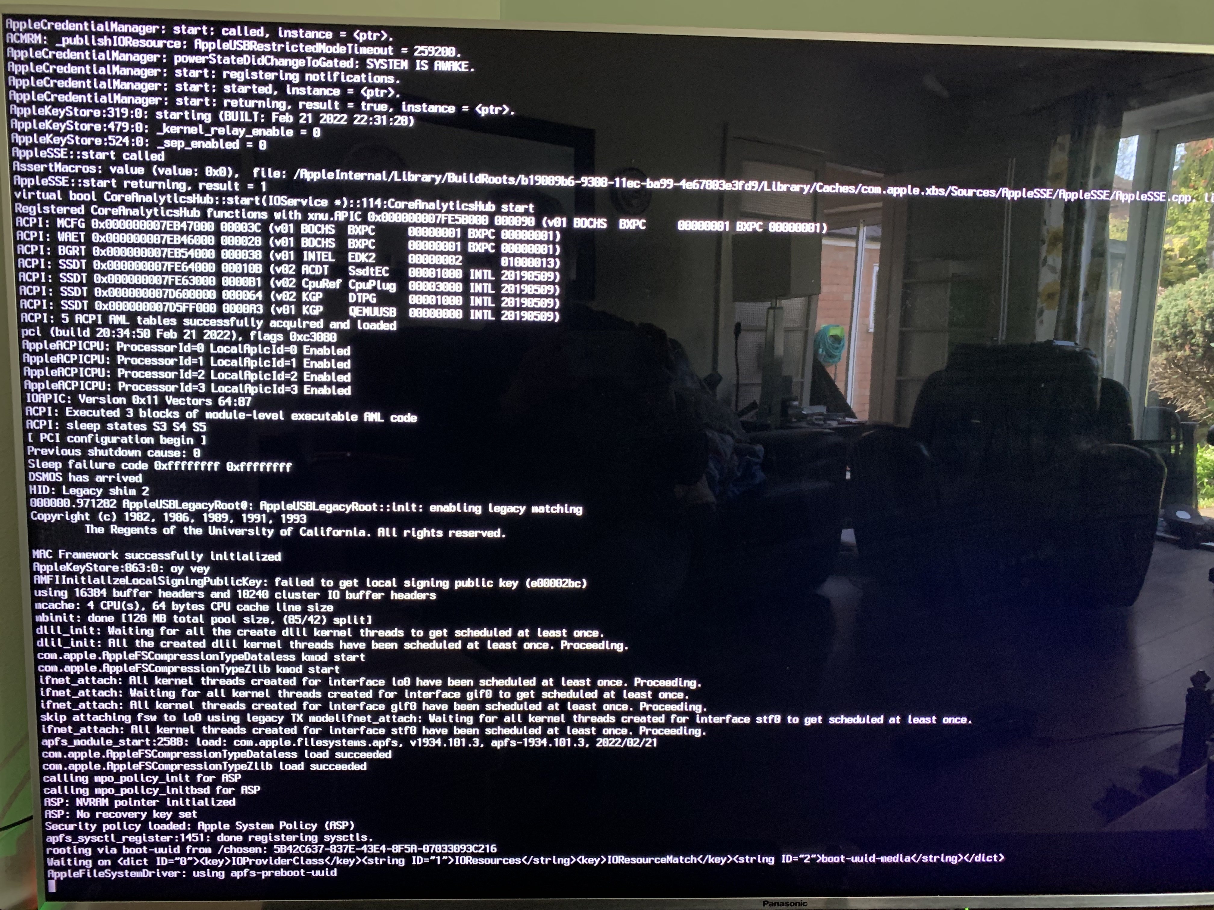

  3. Hi @david279, I've now changed the PCI USB controller bus address to 0x03 (removed existing "virtio-net" br0 at same address ) on the VM xml, booted up but unfortunately the result is the same... I've also attached here the Monterey VM log. I've now started to concentrate on one of the last messages in the opencore log: "AAPL: #[EB|LOG:EXITBS:START]", because this is mentioned on Dortania's trouble shooting guide: Stuck on [EB|#LOG:EXITBS:START] Let's see how much I'll go further... Monterey VM log.txt

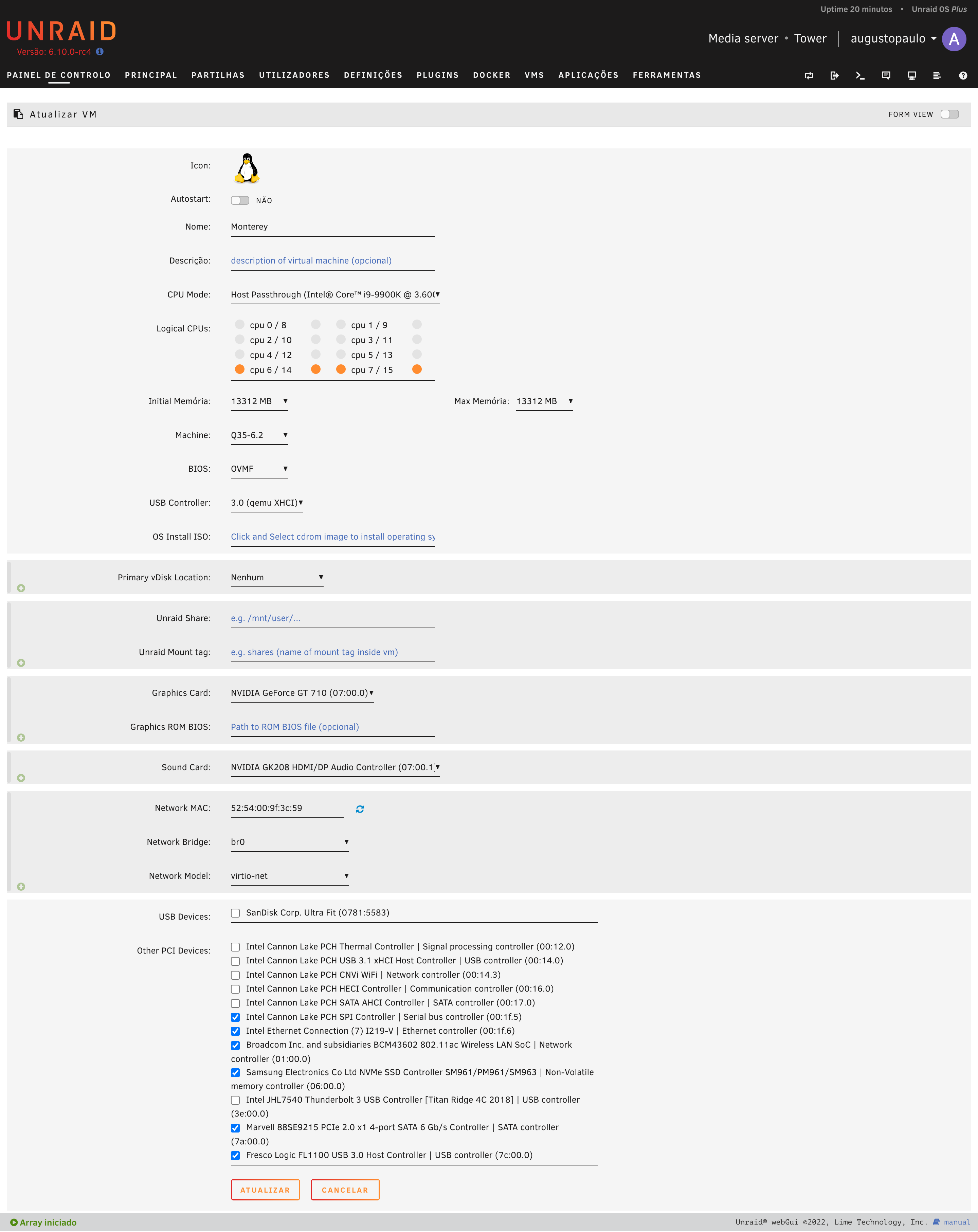

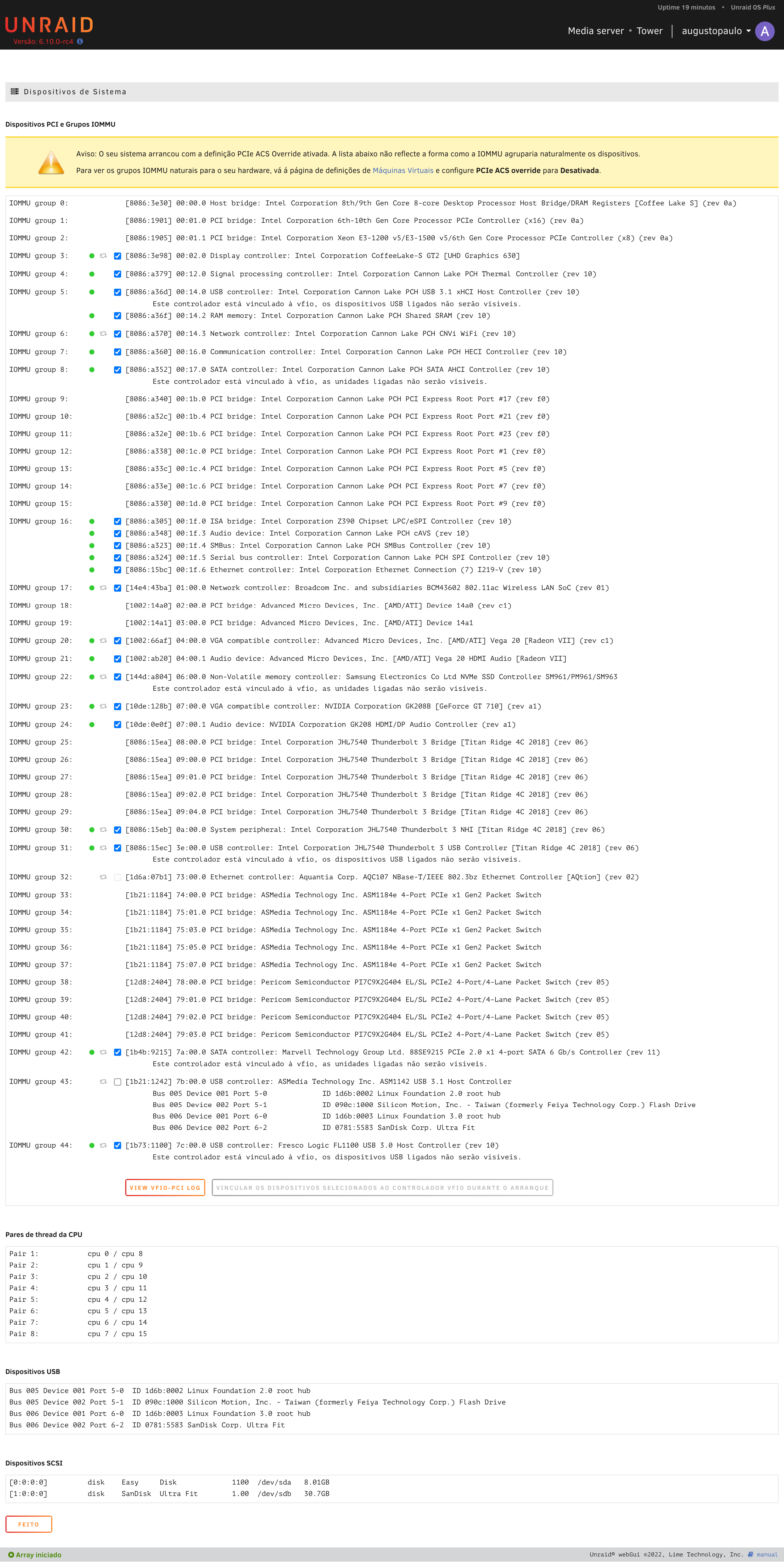

  4. Hi david279, Thanks a lot your quick answer and idea. I'm out at the moment, but when back home I'll try your suggestion
  5. Hi again. I have both windows and mac VMs on unRaid 6.10.0-rc4. I've recently swapped a PCI SATA card in order to run Monterey on its own SATA controller, not using my motherboard main Z390 SATA controller, which I want to use exclusively with Windows. Windows has got allocated all existing resources/controllers except for what Monterey VM has got allocated to himself: [1b73:1100] 7c:00.0 USB controller: Fresco Logic FL1100 USB 3.0 Host Controller (rev 10) [1b4b:9215] 7a:00.0 SATA controller: Marvell Technology Group Ltd. 88SE9215 PCIe 2.0 x1 4-port SATA 6 Gb/s Controller (rev 11) [10de:128b] 07:00.0 VGA compatible controller: NVIDIA Corporation GK208B [GeForce GT 710] (rev a1) [8086:a324] 00:1f.5 Serial bus controller: Intel Corporation Cannon Lake PCH SPI Controller (rev 10) [8086:15bc] 00:1f.6 Ethernet controller: Intel Corporation Ethernet Connection (7) I219-V (rev 10) [14e4:43ba] 01:00.0 Network controller: Broadcom Inc. and subsidiaries BCM43602 802.11ac Wireless LAN SoC (rev 01) [144d:a804] 06:00.0 Non-Volatile memory controller: Samsung Electronics Co Ltd NVMe SSD Controller SM961/PM961/SM963 I've used the latest EFI folder (opencore 0.78) from thenickdude and have configured it with opencore debugging versions. I've only added USBToolBox.kext & UTBMap.kext generated from within Windows, (unfortunately the result is the same with or without these files). I've two Monterey OSs that run perfect in real mode/outside unRaid, plus the USB stick that has this EFI folder is also a Monterey USB installation disk. Now, every time I boot this Monterey VM It doesn't pass the same boot point: "AppleFileSystemDriver: using apfs-preboot-uuid" I've read the opencore boot log but I don't any see anything significant that can explain this... Also uploaded (onto my gdrive) a video (in 240fps) of the whole opencore boot process. What else can I do diagnose this issue ? Thanks in advance for any answers. Monterey.xml opencore-2022-04-10-091349.txt.zip EFI.zip

  8. Hi ab5g, For your mentioned confi.plist, your mean this one: The reason why I chose a Gigabyte Z390 Designare EFI is because my motherboard is the Gigabyte Z390 Xtreme, which is very, very similar to the Designare. Only extra is the 10G Aquantia ethernet port, RGD lights and massive overclock ability, I think... What about my unraid VM .xml file ? Any optimizations required ?
