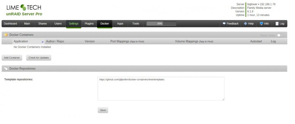

  17. Image!! doh! ok, I am not sure if it was in a place it wasn't supposed to be but regardless, I wasn't paying attention. There was a docker.img file in /mnt/user/ so I nuked that and that seems to have done the trick screenshot attached. Thnx (and thanks for your patience)

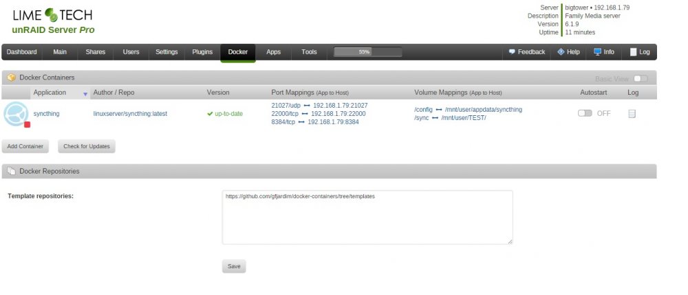

  19. Sure! Here is the result of the ls -ld root@bigtower:/mnt/user# drwxrwxrwx 1 nobody users 53 Jun 27 15:41 /mnt/user/TEST// -bash: drwxrwxrwx: command not found and the screenshot I think you asked for is attached Thanks in advance!

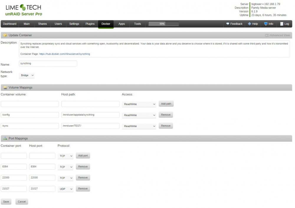

  22. I am a bit ashamed to ask this as I had this problem with a previous install, posted about it, had the post answered (partially, but understood it at the time) but now I am having a similar (same?) problem and can't make heads or tails of it nor the post that helped me along before So. I installed the linuxserver.io syncthing docker, seemed to go smoothly but when I go to the gui I get this error Stopping folder "default" - mkdir /home/Sync/: permission denied I have the volume set as /sync and the host path as /mnt/user/Test I assume that I need to have a different path set for the volume but to be honest I have no idea what it needs to be?
