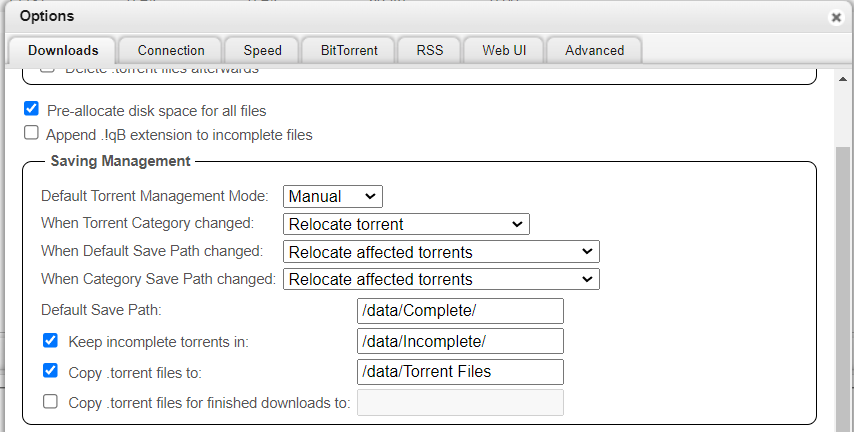

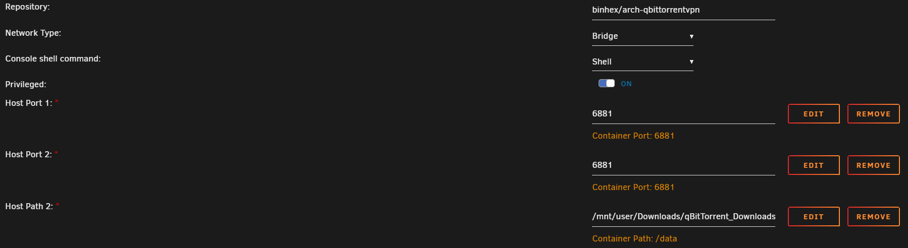

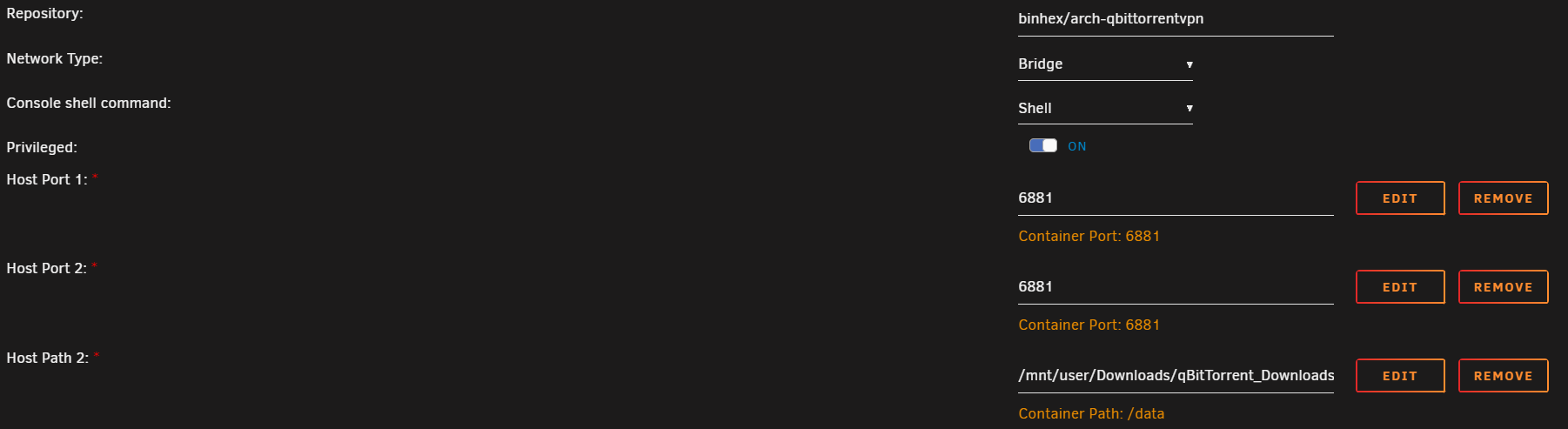

  3. BTW, I think binhex used /data in his example because of the path mappings for the container setup. You can map whatever you'd like array wise to the /data path within the qbit container. For example: Then within qbit I put these settings: This makes the full path for completed torrents as seen from Unraid GUI or SMB share: /mnt/user/qBitTorrent_Downloads/Complete You can map any share/path from your unraid array to the Host Path 2 variable in the first picture. So you can use your downloads share with the subfolders. I specifically mapped just the qBitTorrent_Downloads folder within my Downloads share instead of the whole thing because I didn't want qbit to be able to cause issues in my other download directories (very unlikely, but safer this way anyways so why not!).

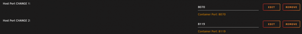

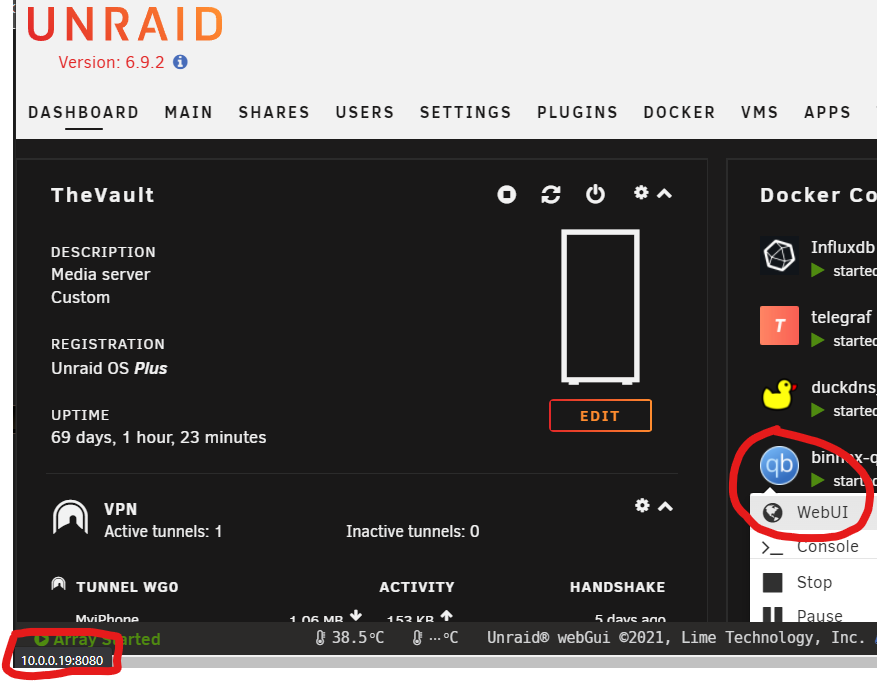

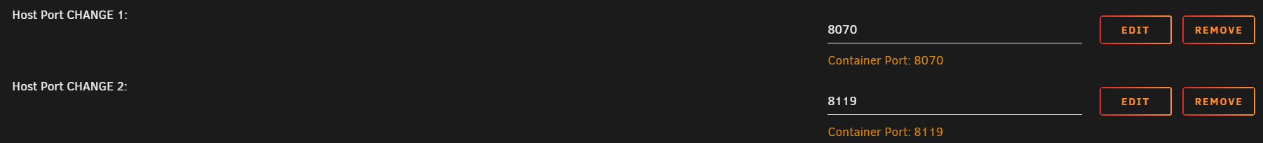

  4. Hi, I was running delugevpn and now need to run qbittorrentvpn as well due to private tracker requirements. I know I need to change the WEB UI access port for qbittorent so following this documentation (https://github.com/binhex/arch-qbittorrentvpn): I decided I needed to delete the "Host Port 3" and "Host Port 4" variables from the docker template since I can't edit the container port value and add new Port variables to map host 8070 to container 8070 (replace 8080) and map host 8119 to container 8119 (replace 8118 privoxy). I also updated the WEBUI_PORT from default of 8080 to 8070. The container works as expected but the link in Unraid dashboard takes me still to X.X.X.X:8080 instead of 8070. Obviously I can manually change the address in my browser but I'm concerned I might be missing something important if that didn't update. Any thoughts?

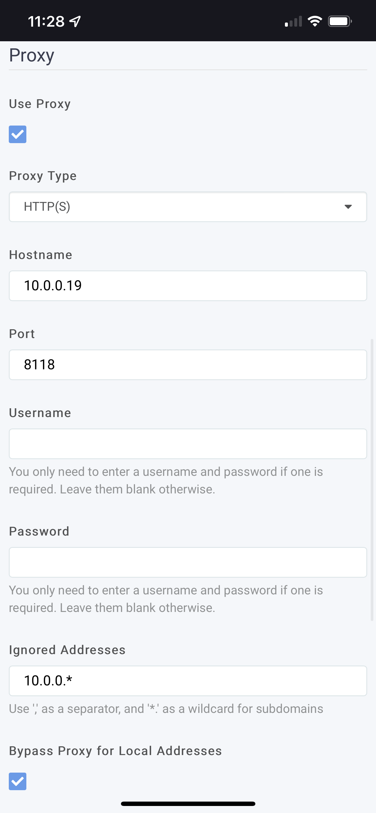

  5. I’m trying to have prowlarr proxy through delugevpn so that torrent magnet files and nzb files are accessed through the VPN. I have privoxy enabled and put in the correct info on the prowlarr side of things. But when I use the prowlarr console to check IP (curl ifconfig.me) I still get my own public IP from my ISP. If I do the same command through the delugevpn I get a different IP, presumably from PIA endpoint which is my VPN provider. I’ve looked through logs but see no errors related to proxy as far as I can tell. I’m on the docker tag 2.0.4.dev38_g23a48dd01-3-01 if that makes a difference. I think I had swapped from latest a while ago when PIA had issues and it was recommended as a short term fix and I never swapped back. These containers are on different docker networks but that shouldn’t have an impact right? Delugevpn is on bridge and prowlarr is on proxynet (I intend to make it accessible through reverse proxy once I get authelia up and running). I’ve attached a picture of the proxy settings in prowlarr that don’t work.

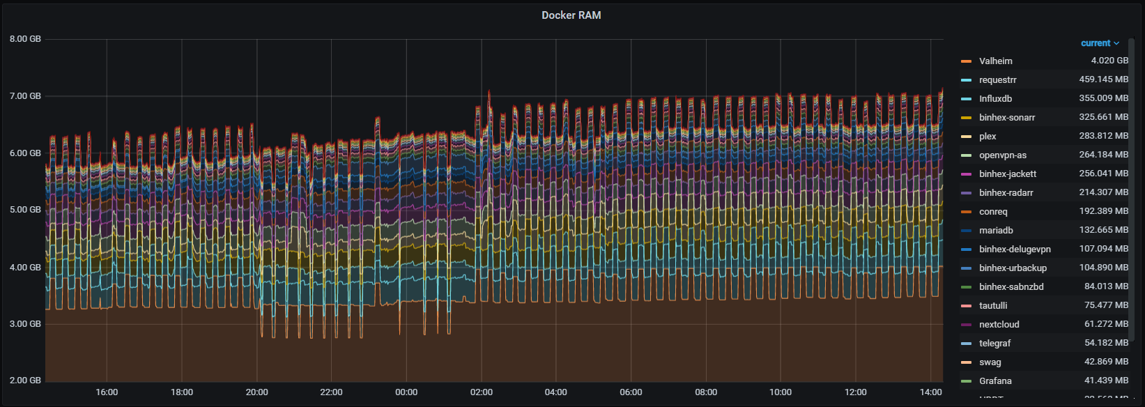

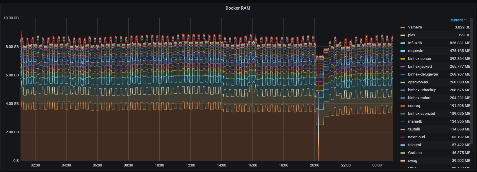

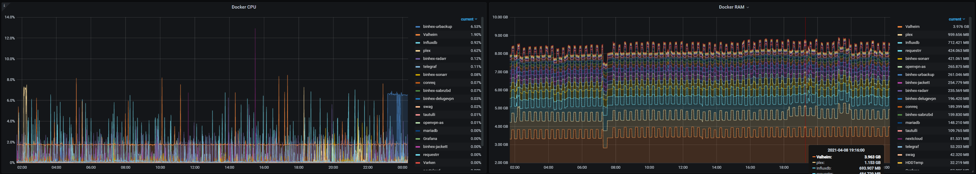

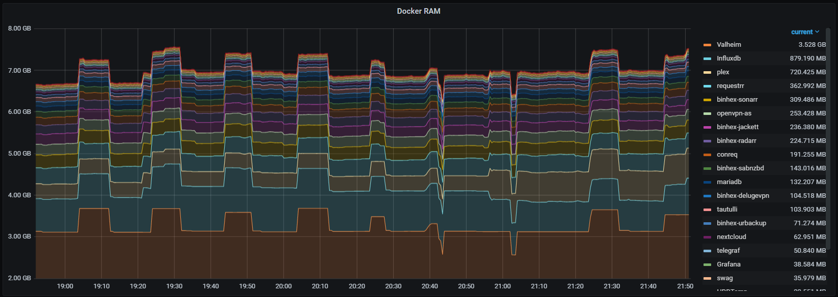

  6. So we finally got a couple people back on the server playing at the same time. There was minimal building but mainly a long lasting boss fight. And weirdly enough the server recorded inverse RAM spikes during the time this was happening (from 20:00 to 2:00 with a small break at 23:00 ish)... Other than that the RAM usage had continued the same pattern between 3.5 GB and 4 GB. At this point it really just seems like a Valheim server software 'feature' so I probably won't continue with updates here as there's nothing Ich77 can do about that! Thanks

  8. Not really a big issue but does anybody know why my DuckDNS container would be mis-reporting a use of 9 Exabytes of RAM? I'm not getting any errors in the log at the time these spikes happen so I'm not worried it's broken, just is mildly annoying/funny because it makes my status graph unreadable as it scales Y to account for the spike: EDIT: This is the Grafana query used to source the data from Influxdb: And I believe this is the only portion of the telegraf.conf file that would collect memory usage data:
  9. So I'm back to seeing the fluctuation between 3.5 GB and 4 GB. I think there's only been exploring done in world since the last update, no major building. Is it also normal to see the 2% steady CPU usage when no one is online (CPU is 8 core/16 thread if it matters)? Not really expecting a solution at this stage, just documenting it in case others have similar problems! No ill side effects have been seen so far. Plan to do a lot of building in world over the next week so we'll see how that affects RAM usage and/or world file size.
  10. Finally got the chance to check and my world database is 108 MB. I think I'll remove the container image and re pull it from your repo just in case but if I see the same behavior I guess it's fine! I wouldn't be surprised if it's something to do with in-game changes either, we ended up doing a lot of terraforming type activities before we heard that it has a huge impact on performance. Thanks for the help! UPDATE: Blew away the docker image, repulled it, put my backup files back in place. Still works great and RAM usage is down to 2.5 GB now! So I must've screwed up something before somehow... I'll keep an eye on it but looks to be resolved! Thanks again UPDATE PART 2: After having it running for a few hours it's gone back to the same behavior as before. Guess it's fine?
  11. Thanks for the quick reply! I’m not familiar at all with how this docker is setup to work so sorry if I point to the wrong things, I’ll try and use the folder paths to make it more clear! I’m talking about all of the logs in the container mapping /serverdata/serverfiles/Steam/logs. There’s about 12 different log files there and at first it seemed like most of them were written to in sync with the RAM usage spikes I saw, though now I think the writes are synced with times I or friends logged onto the world, not 100% sure. So my initial line of troubleshooting may have been quite wrong. I do have the backup function turned on and it works great! I just said that to mean copy the backup out before nuking everything and starting fresh. I don’t have access at the moment for the exact file size, but the compressed backup is ~70 MB. I can update later today with uncompressed numbers when I have better access. Probably hard to help me troubleshoot with just the info above so I’ll do some more poking myself and bring anything back that seems interesting! if I do end up needing to nuke the container image and re-pulling it, any tips? I think I just need to keep the latest backup archive (and Valheim Plus config) and plug that back in after initial setup.
  12. Hi, does anybody have an explanation/fix for the RAM usage behavior by the Valheim docker seen below? Can still connect to the Valheim dedicated server from LAN and WAN and play with normal desync issues, just bugs me seeing this on my status page... Previously, usage stayed at a flat 2.5-3 GB, don't remember exactly. Now it fluctuates a half GB on a very set timing. Possibly related to either an update to the Valheim game or Valheim Plus mod in the last few weeks but unsure. (The dip seen around 20:00 is due to restarting the docker to grab the newest Valheim Plus update.) The unraid docker log doesn't seem to show anything useful for this. The steam appinfo_log shows this repeating every 5-10 minutes: [2021-04-05 20:04:37] RequestAppInfoUpdate: nNumAppIDs 1 [2021-04-05 20:04:41] RequestAppInfoUpdate: nNumAppIDs 1 [2021-04-05 20:04:41] RequestAppInfoUpdate: nNumAppIDs 1 [2021-04-05 20:04:41] Change number 0->11151556, apps: 0/0, packages: 0/0 [2021-04-05 20:04:41] Requesting 744 apps, 1 packages (meta data, 1024 prev attempts) [2021-04-05 20:04:42] Requested 79 app access tokens, 41 received, 38 denied [2021-04-05 20:04:42] Updated SHAs with 41 new access tokens [2021-04-05 20:04:42] Downloaded 28 apps via HTTP, 803 KB (181 KB compressed) [2021-04-05 20:04:42] Requesting 58 apps, 0 packages (full data, 1024 prev attempts) [2021-04-05 20:04:42] UpdatesJob: finished OK, apps updated 86 (1065 KB), packages updated 0 (0 KB) [2021-04-05 20:04:49] Starting async write /serverdata/serverfiles/Steam/appcache/appinfo.vdf (2697301 bytes) It makes me think steam is constantly updating something but I have the "Automatically Update Game:" variable set to false. There's other logs from the Steam/logs location as well that seem to follow the same time-repeating pattern, such as store 'userlocal' and it failing to be read. Is this something fixable on my end? I can backup the world files and wipe the docker image to restart if necessary. Can reply with more log files if that's helpful!
