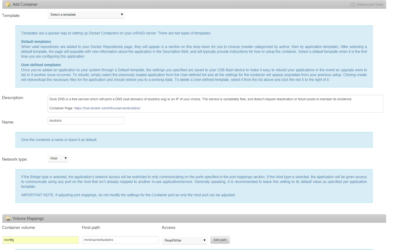

I'm stumped trying to set this up.  I'm going through the apps and selecting DuckDNS.  I get to the add container page and I'm not sure what to do.  Do I need to select a template?  I'm not seeing anything in my list that looks like DuckDNS.  Also I'm not sure what to put in the volume mappings, I tried a few things like /DuckDNS.
When I click on the create button nothing happens.  I don't get an error message, I don't get a waiting on server message, just nothing happens.  What am I doing wrong?

You will only have a template to select if you have added a repository (don't bother) or if you already had a template for a specific docker.
A template is just the stored settings for the Add container page.
But you don't need to select a template. When you selected the "App" from Community Applications, it took you to the Add container with the page already filled out. The only thing you would typically need to do is set one or more volume mappings for the particular application to let it find your files.
In this specific case, I don't think it needs access to anything except the appdata (config), which should already be set.
The Create button still doesn't do anything.
Post a screenshot of what setup you've got so we can see how you've filled in the template.
Here is my screen shot.  The only thing I did was click on the container volume box and select /config and clicked on the host path box and selected my cache drive and added duckdns to the path.
What version of Unraid are you on?
Filled in the subdomain and token info?
Duckdns does not have/need a config folder.
It also doesn't need to be in host mode. Leave it as bridge.
Just fill in the subdomain and token info.
I'm running version 6.1.2.
There isn't anyplace to fill in the subdomain and token info.
Upgrade Unraid.  Docker has been updated a lot since then.  And versions prior to V6.3 have some pretty significant security flaws that have been fixed.
there's a button marked advanced, how about clicking that ?
the fields you need to enter information into will be revealed.
