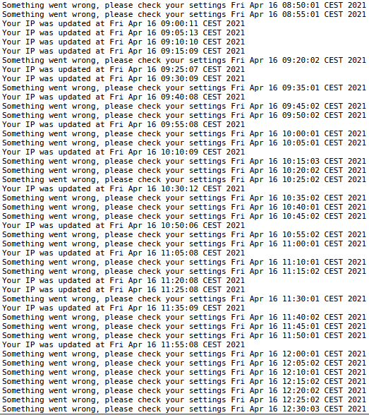

Your IP was updated at Mon Mar 18 17:10:03 EDT 2019
Something went wrong, please check your settings Mon Mar 18 17:15:05 EDT 2019
Something went wrong, please check your settings Mon Mar 18 17:20:06 EDT 2019
Something went wrong, please check your settings Mon Mar 18 17:25:05 EDT 2019
Something went wrong, please check your settings Mon Mar 18 17:30:05 EDT 2019
Something went wrong, please check your settings Mon Mar 18 17:35:05 EDT 2019
Something went wrong, please check your settings Mon Mar 18 17:40:05 EDT 2019
Something went wrong, please check your settings Mon Mar 18 17:45:05 EDT 2019
Something went wrong, please check your settings Mon Mar 18 17:50:05 EDT 2019
Something went wrong, please check your settings Mon Mar 18 17:55:05 EDT 2019
Something went wrong, please check your settings Mon Mar 18 18:00:05 EDT 2019
Something went wrong, please check your settings Mon Mar 18 18:05:05 EDT 2019
Something went wrong, please check your settings Mon Mar 18 18:10:05 EDT 2019
Something went wrong, please check your settings Mon Mar 18 18:15:05 EDT 2019
Your IP was updated at Mon Mar 18 18:20:09 EDT 2019
Something went wrong, please check your settings Mon Mar 18 18:25:06 EDT 2019
Something went wrong, please check your settings Mon Mar 18 18:30:05 EDT 2019
Something went wrong, please check your settings Mon Mar 18 18:35:05 EDT 2019
Your IP was updated at Mon Mar 18 18:40:05 EDT 2019
Your IP was updated at Mon Mar 18 18:45:09 EDT 2019
Something went wrong, please check your settings Mon Mar 18 18:50:05 EDT 2019
Your IP was updated at Mon Mar 18 18:55:07 EDT 2019
Something went wrong, please check your settings Mon Mar 18 19:00:05 EDT 2019
Your IP was updated at Mon Mar 18 19:05:10 EDT 2019
Something went wrong, please check your settings Mon Mar 18 19:10:05 EDT 2019
Your IP was updated at Mon Mar 18 19:15:07 EDT 2019
Something went wrong, please check your settings Mon Mar 18 19:20:06 EDT 2019
Your IP was updated at Mon Mar 18 19:25:04 EDT 2019
Your IP was updated at Mon Mar 18 19:30:01 EDT 2019
Your IP was updated at Mon Mar 18 19:35:05 EDT 2019
Your IP was updated at Mon Mar 18 19:40:05 EDT 2019
Your IP was updated at Mon Mar 18 19:45:09 EDT 2019
Your IP was updated at Mon Mar 18 19:50:06 EDT 2019
Your IP was updated at Mon Mar 18 19:55:07 EDT 2019
Your IP was updated at Mon Mar 18 20:00:07 EDT 2019
Your IP was updated at Mon Mar 18 20:05:05 EDT 2019
Your IP was updated at Mon Mar 18 20:10:08 EDT 2019
Your IP was updated at Mon Mar 18 20:15:05 EDT 2019
Something went wrong, please check your settings Mon Mar 18 20:20:05 EDT 2019
No idea why it's doing that. But if it is updating every so often, it should be fine.

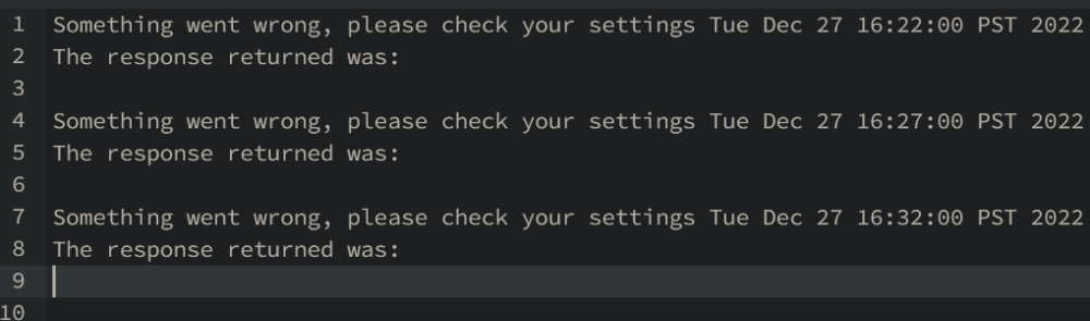

Anybody have any idea why DuckDNS docker works 99% of times, it always succeeds updating my IP address, but when my internet goes down ( IP change overnight ), it fails to update my address with the usual message something went wrong please check your settings. The only to fix it is to restart the docker; then it works again. I would appreciate any help.
Thank you in advance!
