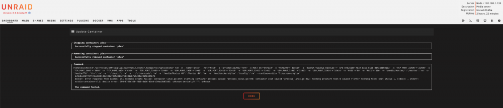

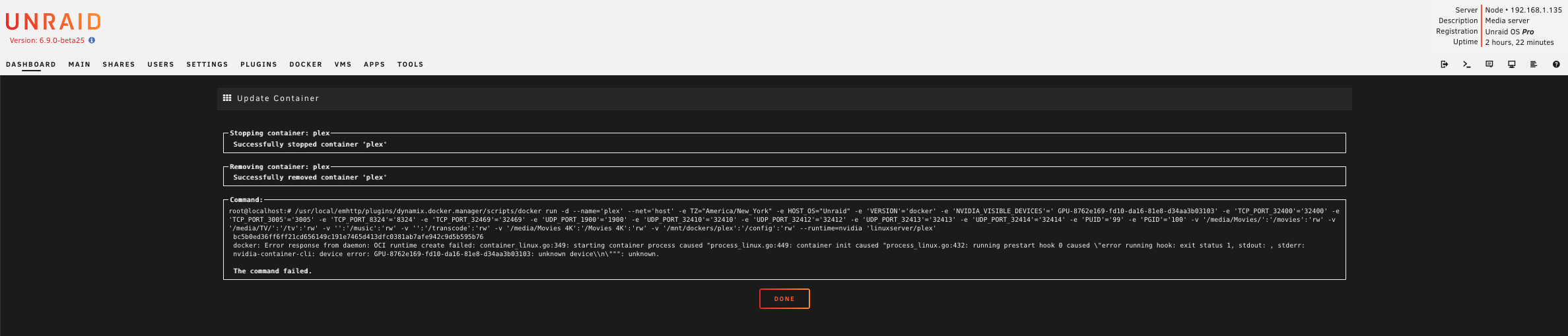

  8. Hello, Firstly - thank you for this brilliant development. Baking in these drivers has made UnRaid even more versatile. I've been having issues with GPU passthrough to plex. I used your compiled files for Unraid 6.9.0 beta 25 with Nvidia and ZFS. Via the plugin, I can see my Quadro P600 with a GPUID. However when I insert the usual parameters into plex (documented previously in this thread, and the linuxserver thread as well). I get the following error: docker: Error response from daemon: OCI runtime create failed: container_linux.go:349: starting container process caused "process_linux.go:449: container init caused "process_linux.go:432: running prestart hook 0 caused \"error running hook: exit status 1, stdout: , stderr: nvidia-container-cli: device error: GPU-8762e169-fd10-da16-81e8-d34aa3b03103: unknown device\\n\""": unknown. I can provide other information if it helps. Thanks again!
