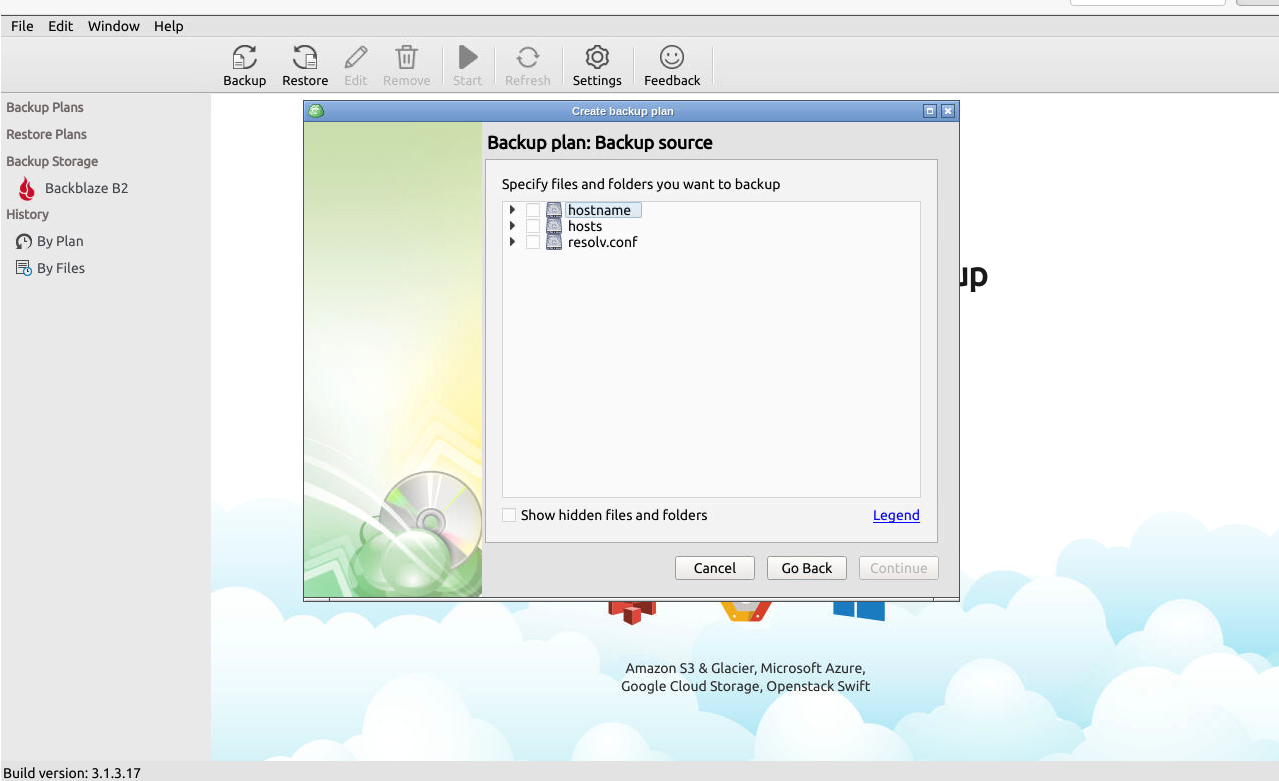

  10. Sure, As you can see, storage is completely missing even though it is mapped to /mnt/user. If I change it to anything other than /mnt/user, it shows up.
  11. I just installed this docker with the default settings. For some reason, the /storage does not show up under the GUI for me to select. I know that it is mounted because when I go to create a backup target and choose filesystem, I can clearly see that /storage is there and points to /mnt/user. However, it doesn't show in the GUI. If I change it from /mnt/user to, say, /mnt, it does show up, but user is missing (it shows cache and disk, etc, but not user). Anyone else experiencing that?
