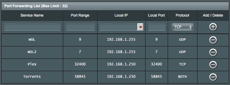

  5. ok so transmission is running but you havent defined any incoming ports for it on your router?. Correct, it must be working properly with UPNP because both UP and DOWN speeds are saturating my broadband

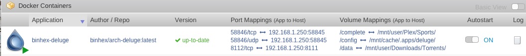

  7. Its mapped from 58846 in container to 58845 in the host so I believe it is right, no? (see my UNRAID docker setup in screenshot)

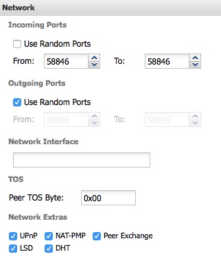

  8. Still no luck. Here is my config:
  9. Understood, tx. So you unselect upnp and NT PMP? What about the other network extras? I am confused about those outgoing ports, how will they ever work if they are not forwarded in the router? To be clear, I have very good download speeds, it is the seeding that does not work properly. I can see lots of peers, I get the odd connection for a few seconds getting a few KB's and then they vanish
  10. Ok thanks. So which port do I forward, in the standard install I have 58845 TCP and 58945 UDP Also, which port (of those two) do I use in the Deluge config for incoming and outgoing?
  11. Strangely my download is going at full speed, its the incoming traffic that is terribly slow, and I need to make it work as seeding is key for me. I don't need to open the web port to the outside and I believe I don't need port forwarding as my router supports upnp and I have never manually open ports on the router before. Do you mean port forwarding of the docker? Doesn't the docker retire more than 1 port for the traffic?
  12. Can somebody clarify the port config required for this docker. At the moment I only have one port open for the web interface and one (58946) for the what I assume is transfers as it is open both TCP and UDP. Is that enough to get multiple connections in and out? Do I then need to map specify this port in the deluge preferences as my port of both incoming and outgoing connections? Many thanks
