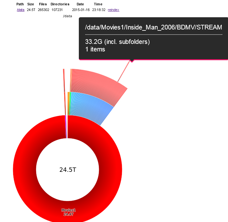

I stumbled upon DUC which creates awesome interactive Disk Usage Charts like this:
I've created a DUC (and apache) container based on the suggested phusion baseimage, and created a template repository and template so that you can easily install it in unRAID.

Once started, you can access the DUC web page with interactive charts by using the Web UI menu option for the running container. This will work if you leave the port option set to 2112, or you can remap it as you see fit and visit http://<container_ip>:80/cgi-bin/duc.cgi
You will need to start an index operation by visiting the web interface and clicking reindex (be patient, it doesn't update the page while doing the reindex...yet). You can add additional indexes or try my new duplicate file utility in duc by starting bash in the running container with docker exec. If you do this, look at the duc command line options, and be sure to specify the database location like this: -d /duc/duc.db This is no longer required as I changed the HOME dir for the container to /duc and it will automatically place the .duc.db there now  :)

If anyone is interested in the duplicate file finding functions I've been adding (still a work in progress, but tests out ok on my data) - here's a screenshot to give you an idea of what it does:
