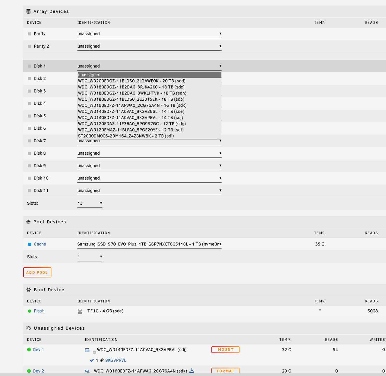

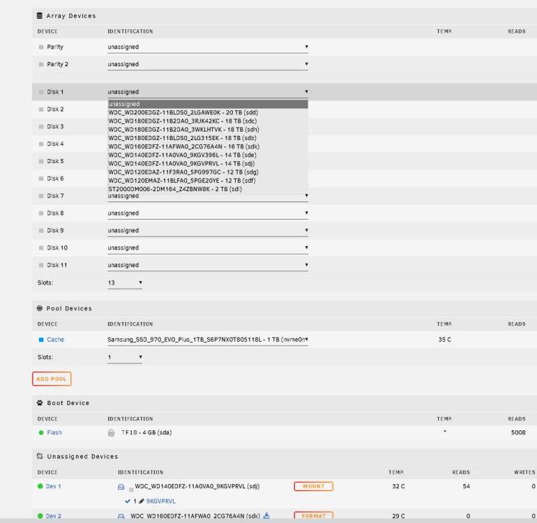

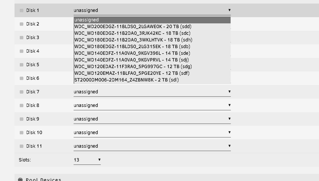

  16. Hello, Yesterday after a reboot of the server, one of my disks of the array , don´t let assigned again on the array . It appear to sign it , but when i try it , it doesn´t work , and the only option is format . I only have movies on these disk , it´s a 16tb disk , before i format, do i have a chance to see the content ? I just wabt to know what movies are, to download it again. I found the main cause, , i was making some maintenance on the case , and somehow i touch on the power cable of these disk , which provocate a reboot... Thw weird thing, is if try to assigned it ( first photo), the disk appear on the list, after i try iy, it won´t assigned anb dissapear from the list ( second photo), Only if i reboot again , it will show on the list. Photos attached. Is there a way to show the content? Or after the format i have a way to ( with software ) not to recover , but to see the content? thanks
