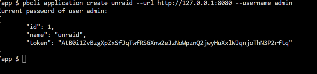

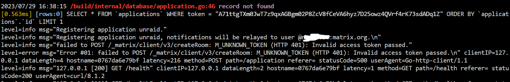

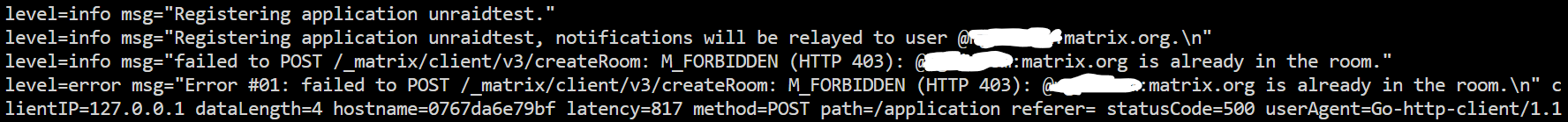

  7. I recently noticed that I had an issue where the mover was not moving any files. In the 'Main' Tab, clicking 'Move' would not cause any action; however going into the individual 'Shares' tabs and moving the shares individually would work as intended. I implemented the solution above, removing the CA Mover Tuning plugin, and the issue was resolved.
  8. You're teaching me about both Matrix messaging as well as Pushbits right now; I just want to say that I appreciate your time. The changes I've just made: I switched the initial admin username back to 'admin' and I made the password simple so I didn't need to copy/paste it. The Matrix ID of the initial admin is set to the Element account (beginning with @) that I'm using to sign into the Element app on my phone. I've just left homeserver as the default of https://matrix.org I created a second matrix account on element with the name username 'pushbits' and a secure password. I deleted the old config.yml and pushbits.db files and copied the new config to the folder, then ran the container. I didn't change the permissions of the new db file. And... Woo! I went to Unraid Notification Settings and set the Full server base url to my.unraid.ip:8050 (8050 being the host port specified in the docker template), and then I pasted the token from the above screenshot, and it works! I got a notification. But at this point, what I understand is that I'm using the public matrix.org server for notifications. You're saying that you recommend I self host a matrix server to use for this?

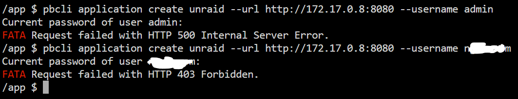

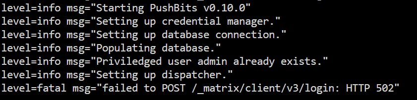

  9. Do I need to have my own matrix server, separate from the Pushbits container?

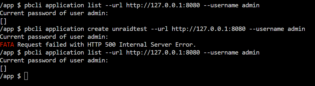

  10. Let's pretend my domain name is abcdef.com I have Nginx Reverse Proxy set up with a proxy host of pushbits.abcdef.com set to forward to my.unraid.ip:8050. Is the initial admin just a local account and the credentials don't matter that much? Should I leave it as the default admin/admin? Or should these credentials match what I use to log in to Element? I have set the homeserver in the config.yaml file set to http://pushbits.abcdef.com and the container will not start:
  11. Deleting the .db file and allowing pushbits to recreate it did help and allowed me to get further. I'm now getting an HTTP 500 Internal Server Error: And the logs: Notably, when running these commands the container is able to create the rooms in Element: Do I need to use my own IP as the homeserver in the config.yml? Do I need to use two separate Matrix accounts for messaging?
  12. Using the admin credentials I get: Request failed with HTTP 500 Internal Server Error. The logs for this:
  13. Hey, I tried the exact address as above and I still get the 403 forbidden error. This may be related to unfamiliarity with Matrix messaging. I tried setting up an account on element and I've copy/pasted the password to the config.yml file as well as the console, but I get the same error. At one point, element said I had an 'unverified session' but said that Pushbits didn't support encryption and so I could not verify the session. Do you have a different app that you recommend to use?

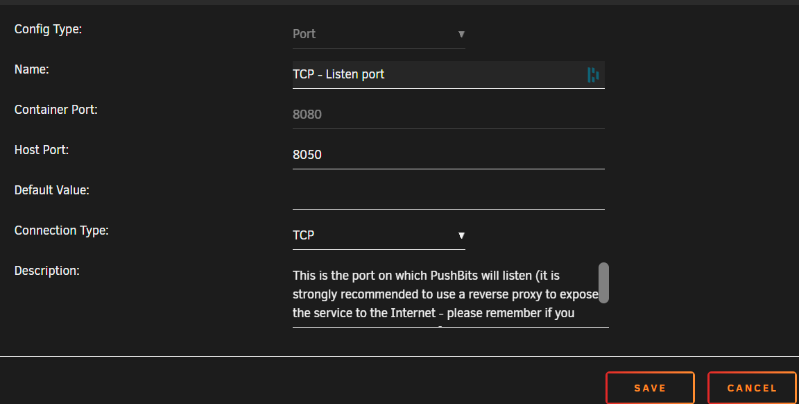

  14. Hey, this is setup through Nginx Proxy Manager This is what my console looks like in the docker: I tried with both the admin credentials in the config.yml as well as the matrix credentials
