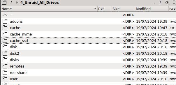

Cache drives (in pools) and boot drives intermittently disappearing then reappearing
Thank you here is is. I must have done something when changing my cache to be x2 caches. Looking in Krusader I can see my cache folder is "full" while the 2 I created - cache_nvme and cache_ssd have space. I am not sure what "cache" is... dekker-diagnostics-20240721-2101.zip
Hi, something string is happening with my UNRAID server - the pool drives (cache's) and the boot drive keep on disappearing then reappearing in the MAIN UI, on top of that the whle UNRAID homepage randomly times out. I first discovered the issue when my NVME cache pool (which contains all my downloads) was getting full, but sonarr wasnt able to move the files to the media share as it was also "full" (my UNRAID array has plenty of space however). I did setup my caches a few months ago and wondering if it is related? I attached my diagnostics file - its a really odd issue. dekker-diagnostics-20240719-2018.zip
