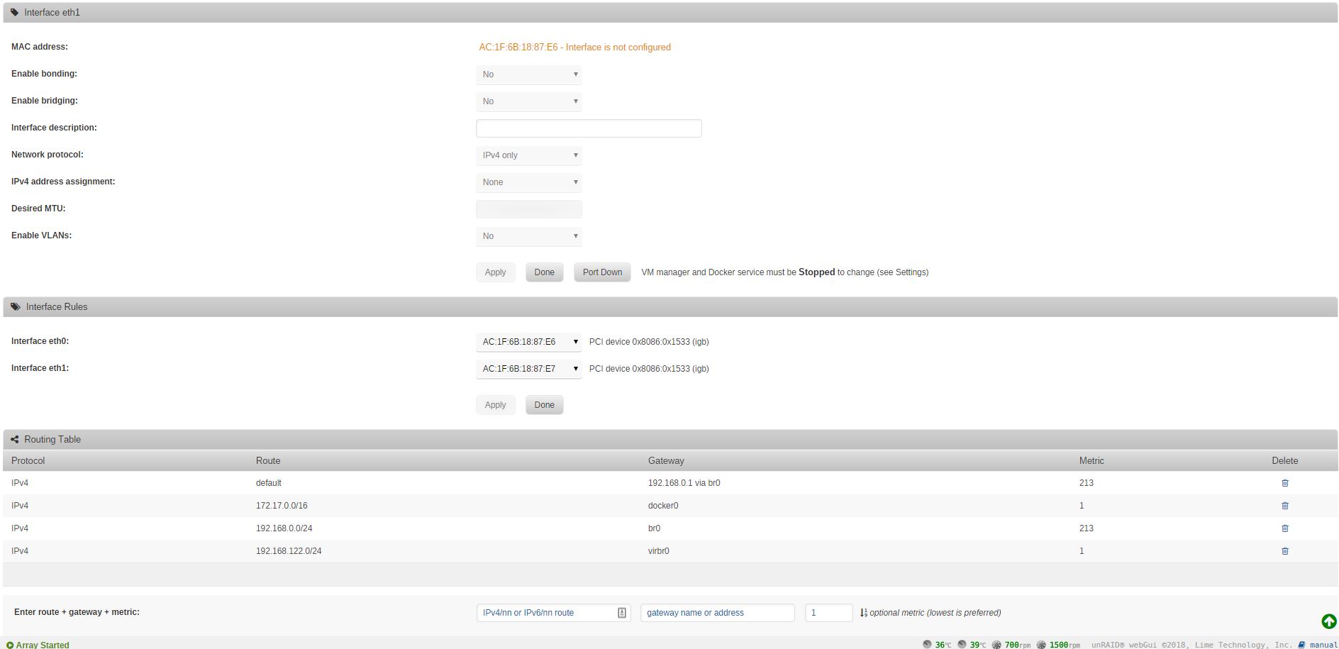

Thanks for posting. I can't see custom br0 on my docker details - it's custom eth0 only.
What do I need to do?
Change your network setting for eth0 to use bridge function.

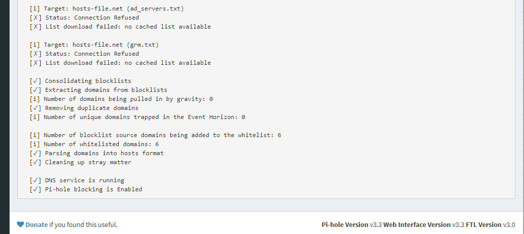

I get connection refused every time I run the block lists update.  I'm running unraid 6.5 and have PiHole running on it's own IP.  I've forwarded my dhcp servers DNS ip to the PiHole ip.  Everything seems to be functioning except it isn't blocking anything.
image.thumb.png.c90e1abeae39905d5fbfb525ee698c3a.pngimage.thumb.png.605a1c4de292fb77601d273816e2bbf7.png
Thoughts?
I get connection refused every time I run the block lists update.  I'm running unraid 6.5 and have PiHole running on it's own IP.  I've forwarded my dhcp servers DNS ip to the PiHole ip.  Everything seems to be functioning except it isn't blocking anything.image.thumb.png.c90e1abeae39905d5fbfb525ee698c3a.pngimage.thumb.png.605a1c4de292fb77601d273816e2bbf7.png
Thoughts?
 It shows 0 domains on the block list. It is failing when downloading the lists it seems.
Do you have the dns entry in the extra cmd as seen in the picture?
Well I'm not sure what changed but I tried changing the Extra Parameters to what yours says because mine is defaulted to
--cap-add=NET_ADMIN
It didn't work so I upgraded to rc3 from rc2 on 6.5.1 did a clean boot and  when I went to go login to the PiHole admin page it listed domains in the blocklist.  I'm not sure what it was as I rebooted my server many times yesterday but I appreciate your effort.
Thanks

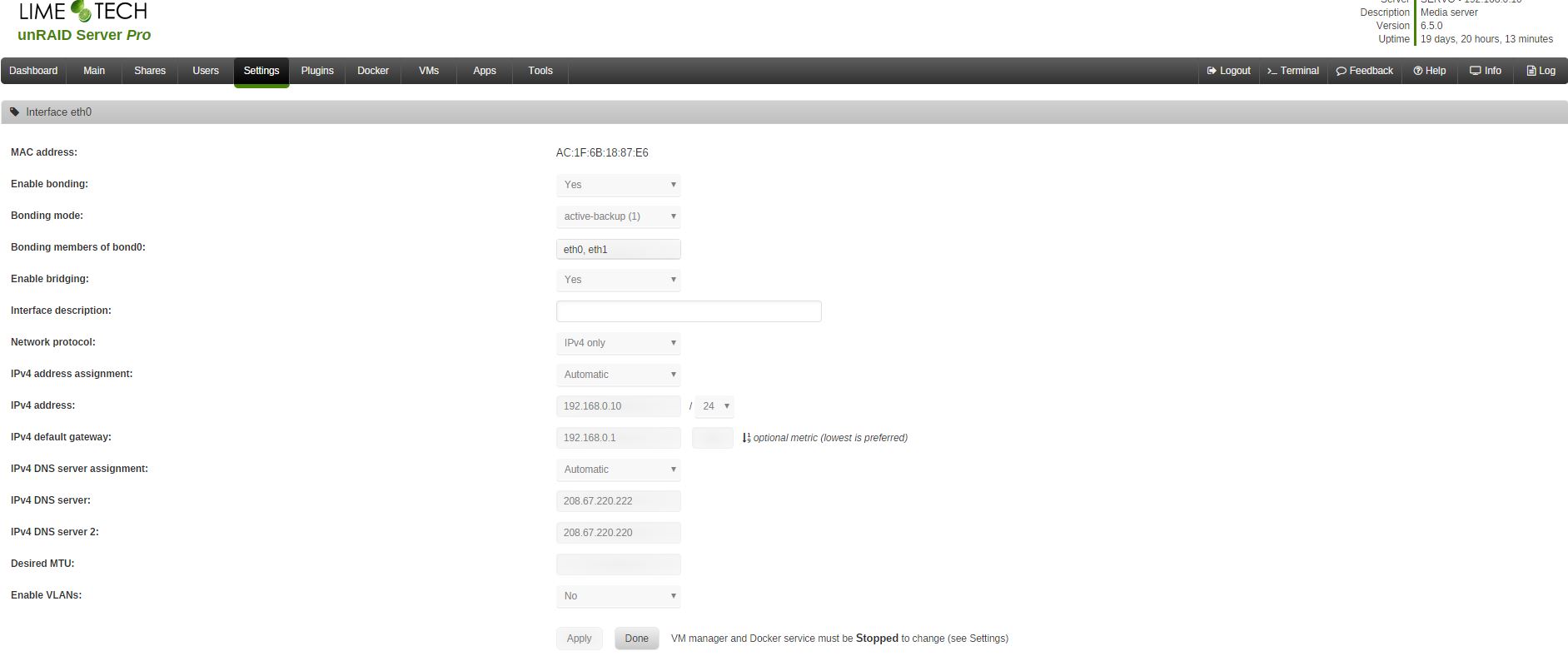

I went to set this up, but dont have Custom br0 in my network type on the docker image page.
I have a supermicro board with bonding enabled. Here are screen shots of my settings. I also have 2 Ubuntu VMs running.
Any suggestions on what i need to configure?

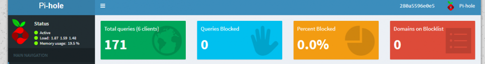

Having issues like many others.
Installed following the video.
Changed to br0, custom IP different than unraid ip.
matched server ip to custom ip
tried interface as eth0 and br0 both failed.
have --dns 127.0.0.1 or whatever it is in the custom are, including --dns 1.1.1.1 and 8.8.8.8
Issue:
Blocklist = 0 and I cannot get gravity to update, nor access pi.hole/admin.  so i know something is going wrong here.
Pi-hole blocking is enabled
Neutrino emissions detected...
[✗] Pulling blocklist source list into range
No source list found, or it is empty
Number of domains being pulled in by gravity: 0
Nothing to whitelist!
Number of regex filters: 0
[✓] Parsing domains into hosts format
[✓] Cleaning up stray matter
[✓] DNS service is running
[✓] Pi-hole blocking is Enabled
any help here?
i dont want to just add in lists if gravity wont update.
EDIT:
Did a pihole -d
said could not find IPv4 on the config file, it had the same ip but it said could not find 192.168.0.132/24 and in the config file it only had 192.168.0.132, so i added the /24....
this still didn't fix the issue.
then tried a pihole -r, selected the first option, this did NOT work
tried pihole -r selecting the second option, did NOT change any settings, and it seems to work now.

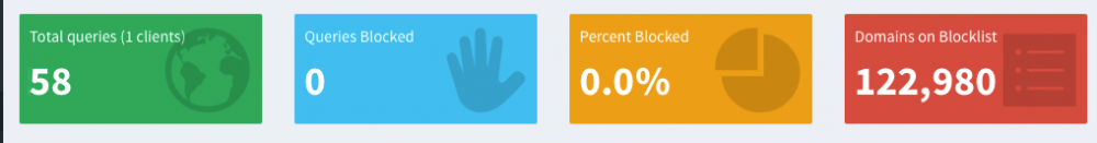

I've installed this using the excellent video  i can get into the webui etc, everything seems to work. I gave it an ip address of 192.168.1.10, and i'm using the cloudflare dns (1.1.1.1 / 1.0.0.1). Now, if i change my router's DNS (Netgear WNDR3700) to use 192.168.1.10, i can't browse to any sites... it just won't work.
If i return the router to 1.1.1.1/1.0.0.1 and configure my mac maually so it uses pihole as it's DNS server, i can browse perfectly, and i can see in pihole's query log everything is also logged etc. so it does work... But why won't it work if i configure it on my router?
I also made the pihole docker a static ip adress in the router.
What am i missing?

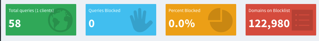

Okay so I followed the tutorial from Space Invader One to the letter. None of the Ads are blocked.
Setting up the IP address for the pi-hole server using the Custom: br0 network type and a fixed IP address
I as well made sure to have the ServerIP the same.
From within Pi-Hole I setup the blacklists to include all the lists that were mentioned on https://firebog.net/
From there my domains skyrocketed up to showing me this.
From there i went into my router settings (which is an Asus CM-32) to change my DNS w/in my DHCP Server to point to the IP address for the pi-hole:
I also made sure to change my DNS server for my UnRaid due to the fact i was not able to receive any updates for plugins or dockers.
I then proceeded to check to see if pi-hole was working from my system by visiting a very add intensive website www.dailymail.co.uk the very first things i see on there are ads..
I from there went to make sure my system was pointing to the new DNS server.  ipconfig /all
I've even /released and /renewed  to make sure. I've restarted my router/PC/and Server
Not very sure where I go from here.
Here is my debug log from pi-hole if this helps.
https://pastebin.com/bYNdDPEp
(oh I've also tried from all devices on the network with no luck)
Edited by Drazzilb
