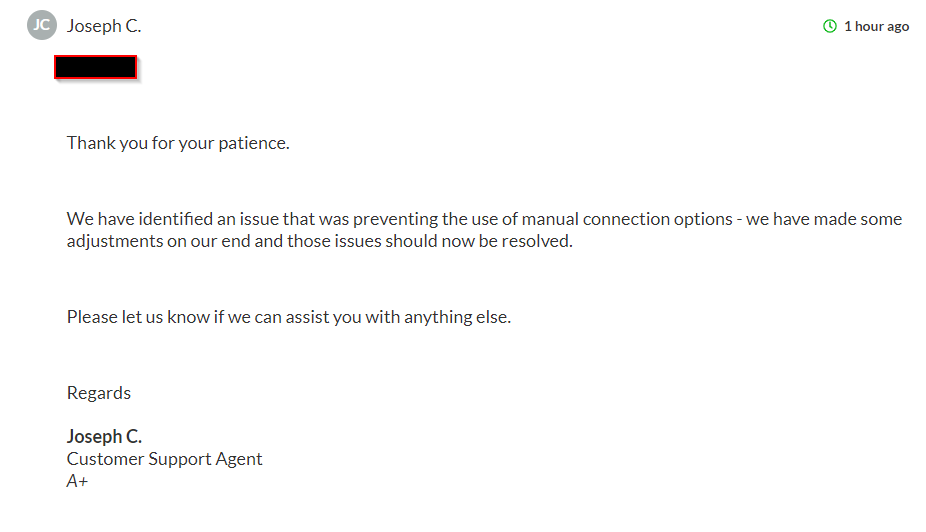

  14. Hey Everyone please test again. The Support answered and since then I can connect.
  15. Yes refers to this: 2020-12-07 17:02:00,691 DEBG 'start-script' stdout output: [warn] Unable to successfully download PIA json to generate token from URL 'https://212.102.35.1/authv3/generateToken' [info] Retrying in 10 secs... 2020-12-07 17:02:10,724 DEBG 'start-script' stderr output: parse error: Invalid numeric literal at line 4, column 0 2020-12-07 17:02:10,982 DEBG 'start-script' stdout output: [warn] Unable to successfully download PIA json to generate token from URL 'https://212.102.35.1/authv3/generateToken' [info] Retrying in 10 secs...
