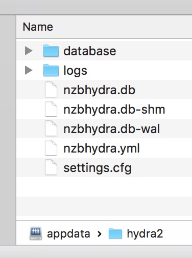

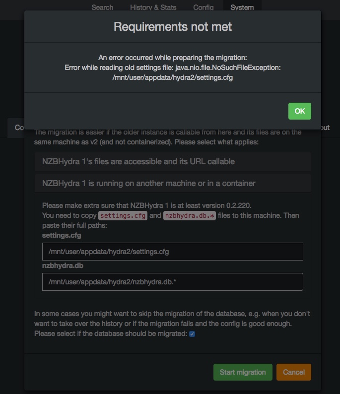

I'm trying to migrate from v1 to v2. As per the instructions, I've moved the cfg and db files to the root of the hydra2, but when trying to import, I get the following;
[2m2018-02-02 19:26:35.373[0;39m [32m INFO[0;39m [2m---[0;39m [2m[0.0-5076-exec-1][0;39m [36mo.n.migration.FromPythonMigration [0;39m [2m:[0;39m [35m[IP: 10.0.0.39] [0;39mReceived request to migrate from settings file /mnt/user/appdata/hydra2/settings.cfg and database file /mnt/user/appdata/hydra2/nzbhydra.db.*
[2m2018-02-02 19:26:35.375[0;39m [31mERROR[0;39m [2m---[0;39m [2m[0.0-5076-exec-1][0;39m [36mo.n.migration.FromPythonMigration [0;39m [2m:[0;39m [35m[IP: 10.0.0.39] [0;39mError while reading old settings file
java.nio.file.NoSuchFileException: /mnt/user/appdata/hydra2/settings.cfg
at sun.nio.fs.UnixException.translateToIOException(UnixException.java:86)
at sun.nio.fs.UnixException.rethrowAsIOException(UnixException.java:102)
at sun.nio.fs.UnixException.rethrowAsIOException(UnixException.java:107)
at sun.nio.fs.UnixFileSystemProvider.newByteChannel(UnixFileSystemProvider.java:214)
at java.nio.file.Files.newByteChannel(Files.java:361)
at java.nio.file.Files.newByteChannel(Files.java:407)
at java.nio.file.Files.readAllBytes(Files.java:3152)
at org.nzbhydra.migration.FromPythonMigration.migrateFromFiles(FromPythonMigration.java:61)
at org.nzbhydra.migration.FromPythonMigration$$FastClassBySpringCGLIB$$25126370.invoke(<generated>)
at org.springframework.cglib.proxy.MethodProxy.invoke(MethodProxy.java:204)
at org.springframework.aop.framework.CglibAopProxy$CglibMethodInvocation.invokeJoinpoint(CglibAopProxy.java:738)
at org.springframework.aop.framework.ReflectiveMethodInvocation.proceed(ReflectiveMethodInvocation.java:157)
at org.springframework.transaction.interceptor.TransactionInterceptor$1.proceedWithInvocation(TransactionInterceptor.java:99)
at org.springframework.transaction.interceptor.TransactionAspectSupport.invokeWithinTransaction(TransactionAspectSupport.java:282)
at org.springframework.transaction.interceptor.TransactionInterceptor.invoke(TransactionInterceptor.java:96)
But as per the screenshot, the files are there and in the right place?
Where have I gone wrong?
Edited by WannabeMKII
Wrong image.
Maybe better to raise the issue to the developer?
It's still beta, so there are bugs.
Edited by saarg
Try /config/settings.cfg /config/nzbhydra.db
Perfect, worked a treat!
Many thanks! ;D

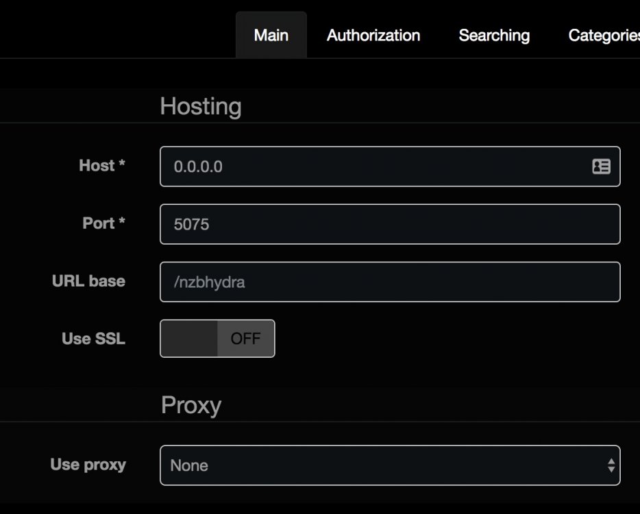

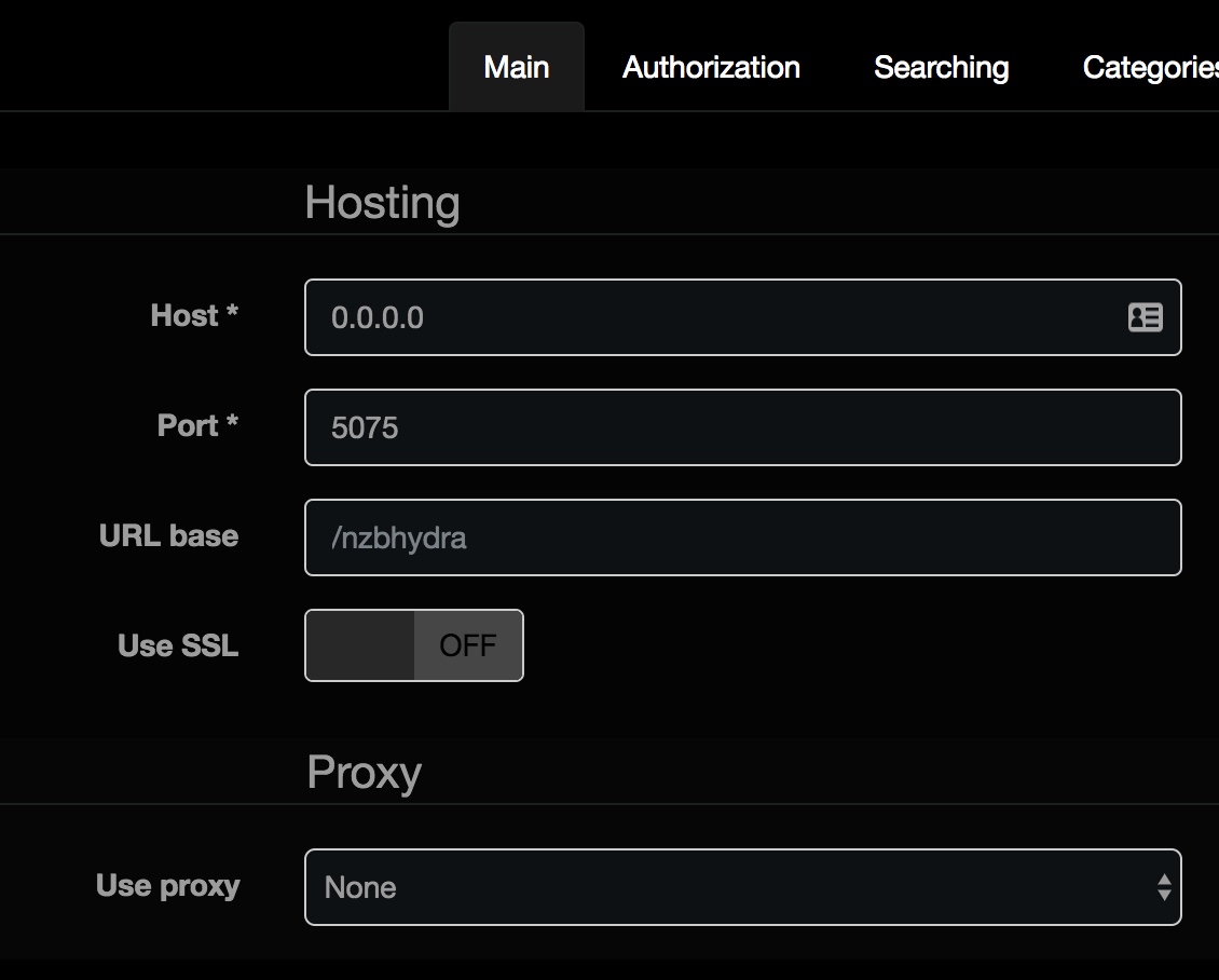

This is working great, but now I've LetsEncrypt back up and running, when accessing, it prompts for my username and password, but not actually loads?
It appears to access my login credentials, but the page doesn't render anything?
Any ideas?
4 minutes ago, CHBMB said:
Not without some configs....
Sorry, got excited that things are almost 100%.
Attached are images and the LE setup;
location /nzbhydra {
		include /config/nginx/proxy.conf;
		proxy_pass http://10.0.0.124:5075/nzbhydra;
Found the issue and it was really subtle.
Within nzbhydra, the URL base is actually greyed as an example and not actually completed. I typed in "/nzbhydra" and it's now working perfectly!
So everything is now back to 100% working order, thanks again for the pointers everyone!
