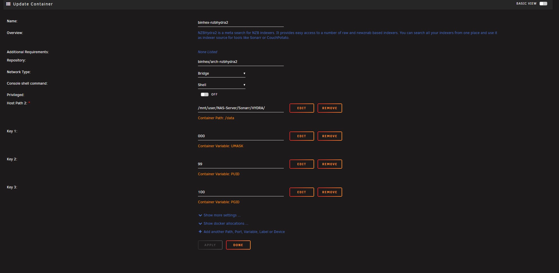

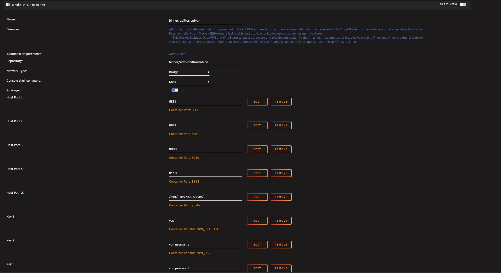

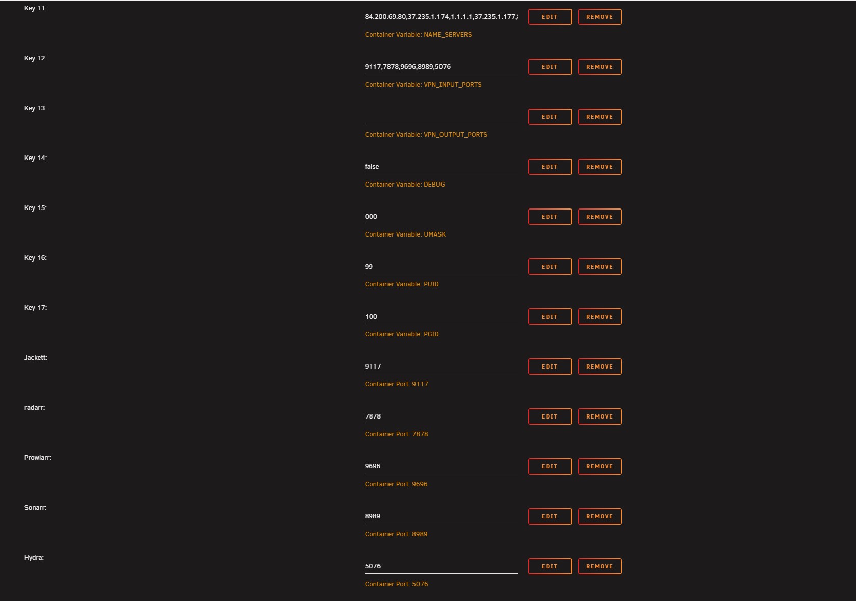

Hello out there:)
i´ve got a problem.. i have installed nzbhydra on my server. But i have also put the traffic through my vpn container:)
i followed point 24 in this guide: https://github.com/binhex/documentation/blob/master/docker/faq/vpn.md my problem is that i cant connect it to sonarr?? i´ve tried to put in localhost:5076.. But it´s not working:(.  What could the problem be?? And how do i solve it??
best regards
39 minutes ago, Mattti1912 said:
Hello out there:)
best regards
Post a screenshot of your VPN docker config and your sonarr docker config
