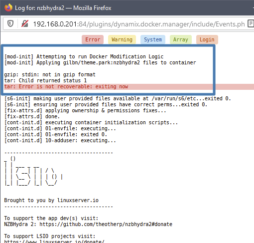

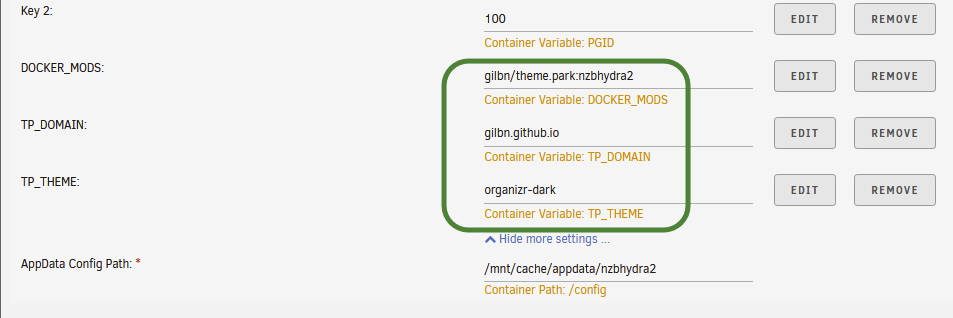

I have tried this with NZBHydra2 and have not had any luck. I changed the template to the below:
But when I re-start the container, I get this on the Log Screen... and no theme is applied.
Does anyone know how to resolve this? If I get this to work, I will attempt to create/share a few more subtle/calmer Themes.

Hi, there is no Docker mod for nzbhydra yet. Only the ones you see in the docker-mods branch. So for this you'll need to use one of the other install methods.
Thanks GilbN. I understand now.
Just had a look at nzbhydra2 and there isnt an html file inside the container I can sed the stylesheet into. So it's not possible to create a mod for it.

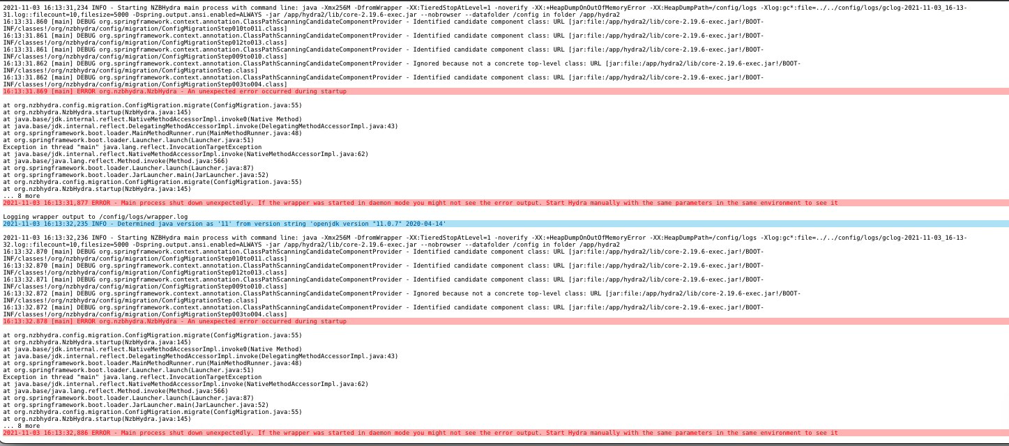

Just updated everything on the server and I'm running into the below error. Its a paste of the log which repeats over and over as hydra tries to start. Nothing has changed on my end with the docker or any settings.
I see it stating there is a corrupt config file - I've already tried to delete the container and image for it and reload from a template with no luck.
Any ideas?

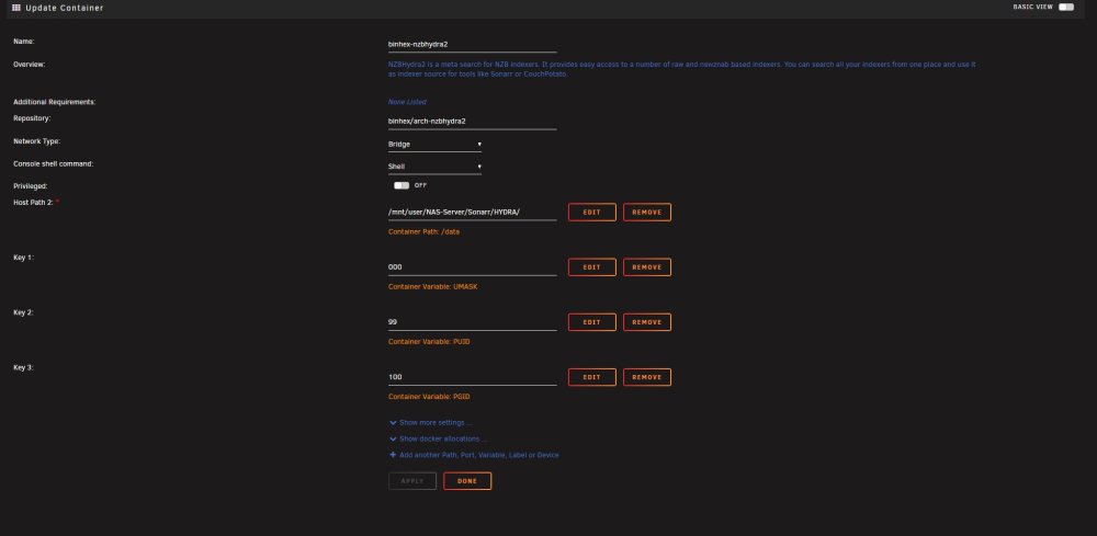

Looking for some insights into why hydra2 stopped working after what seems like years.... no changes made to the server other than auto updates for the docker img...
Anyone else have it stop working?

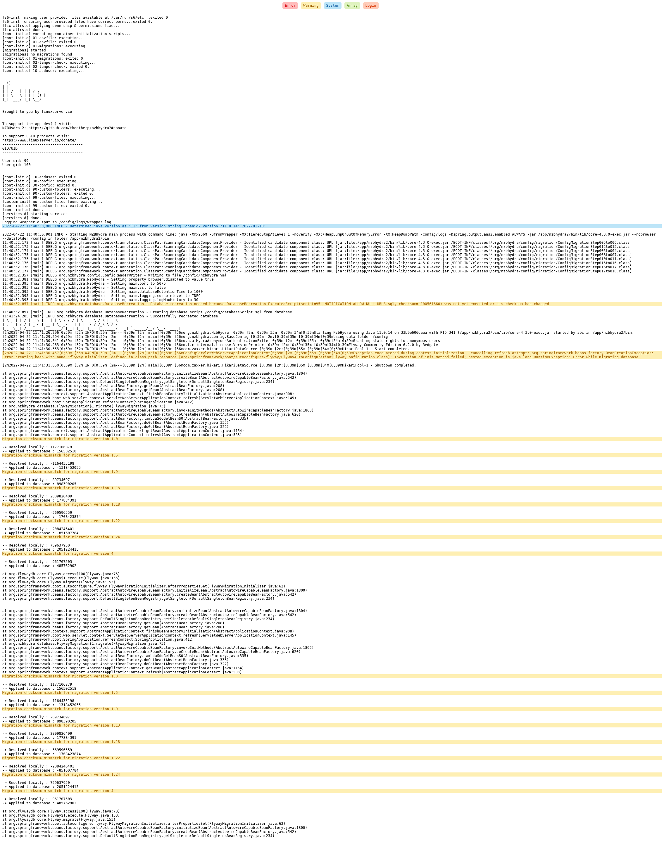

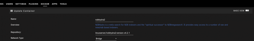

anyone else having issues with nzbhydra2 not working since the last update a few days ago?
Yep, noticed the same thing this morning.
Rolled back to 4.2.1 and now everything works again.  Will update when they fix it...
Thanks! That didn't quite end up doing the trick for me - ended up having to replace the db with a copy from a recent backup.
Same issue here.
same here after latest update...
oh good.  I though it was just me and spydermixx that had issues.
The latest version is like 9 days old.  The last time nzbhydra2 crapped out like this, the maintainer pushed out an update the next day (I think it was actually sooner).
I'm sure they're going to have a fix for us soon
Edited by AntMunny
FWIW the binhex container version doesn't seem to have any issues.
I deleted appdata and installed the latest version that came out 4 hours ago and all seems to be working fine...
Thank you to the maintainer!!
