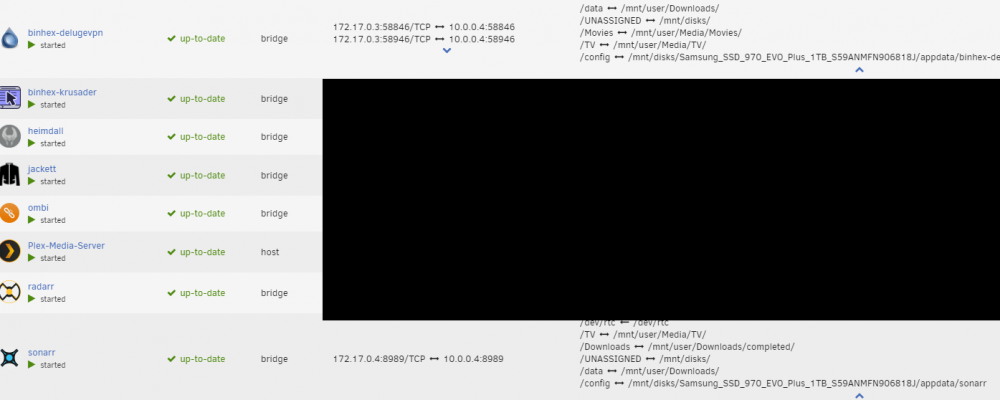

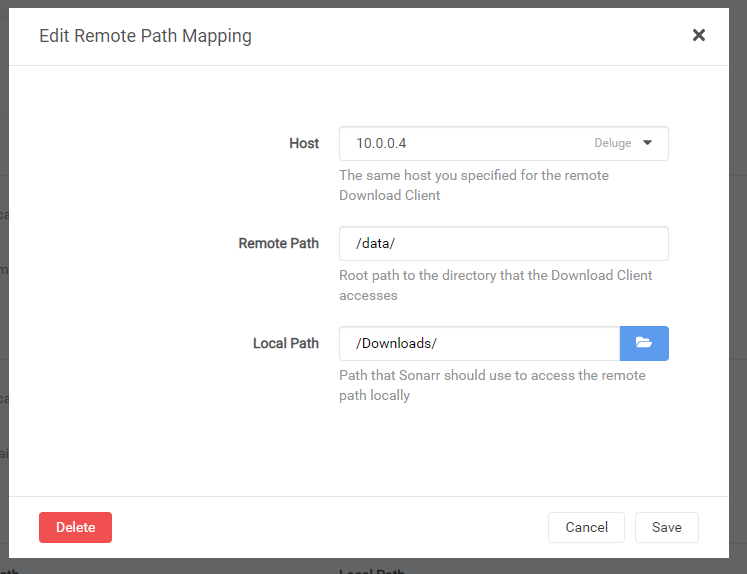

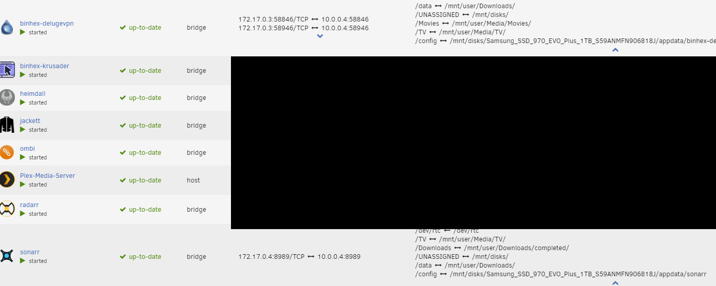

  7. Looks like I need to do a remote path mapping. I tried and failed, headed over to the Sonarr container support thread there. TY for fixing some of the issue!
  8. Remote path issue? I'm using Deluge and everything is working with Sonarr triggering downloads and labeling but I'm having an issue having the completed files get picked up and moved to the final folder where my TV shows are by Sonarr. Sonar can see the most recent download in the completed downloads folder but won't import it and is throwing the error: Import failed, path does not exist or is not accessible by Sonarr: /Downloads/completed/Real.Time.with.Bill.Maher.S18E34.720p.WEB.H264-JEBAITED[TGx]. Ensure the path exists and the user running Sonarr has the correct permissions to access this file/folder From research I believe I need to do a remote path mapping and have set that up but something is still not right. I've attached my settings for the remote path mapping in Sonarr and Docker setups.
  9. I did that in the Deluge setup in Sonarr and Radarr, activated the labels plugin in Deluge and they appeared in Deluge under labels and torrents intiated by Sonarr or Radarr have the tag pulling through correctly. I think the issue is I am telling Deluge to move the completed files with those tags to the directory of the TV or Movie folders instead of leaving them in "Completed" to be picked up and moved. I just deleted the label setting in Deluge to move completed files with these tags to the TV or Movie folders and instead leaving them in Completed. Hopefully they will pick them up now. Going to run another test and will report back.
  10. A mismatched downloads folder appears to have been the issue. The github article was extremely helpful in sorting this out and also understanding host and container settings. I had to align the host and container paths in Deluge, Sonarr and Radarr in the docker settings. I tested two torrents and once completed they changed to "100% - Seeding" status and moved to the Completed folder. I also setup a label in Deluge to move Sonarr to the TV folder and Radarr to the Movie folder which also occured. So the Deluge setup is finally working correctly! The only issue that remains is that Sonarr and Radarr are not renaming and moving the files to the correct show and season folders after they are moved into the TV folder or Movie folder respectively. The folder as downloaded by Deluge remains as is. I'll have to check my settings there.
