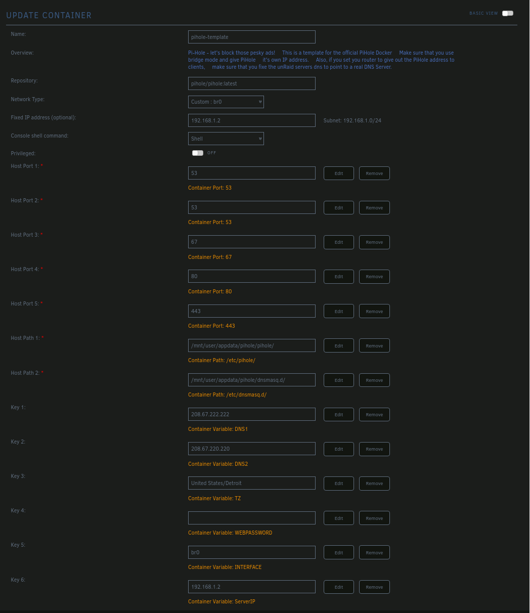

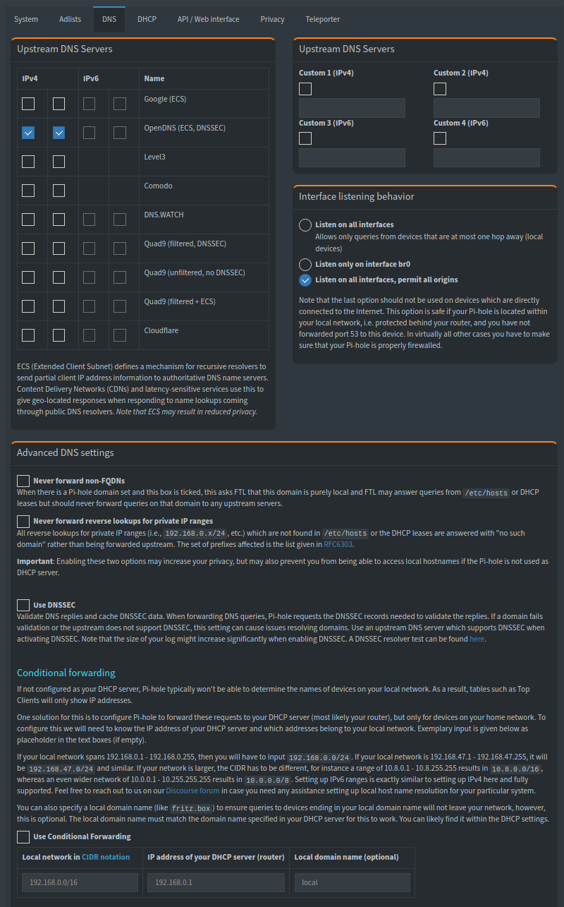

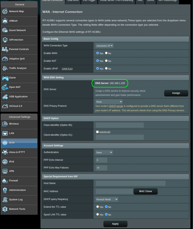

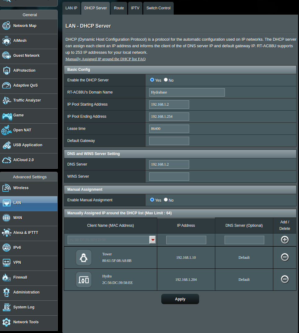

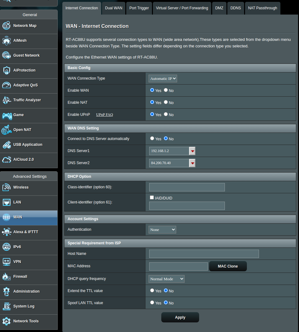

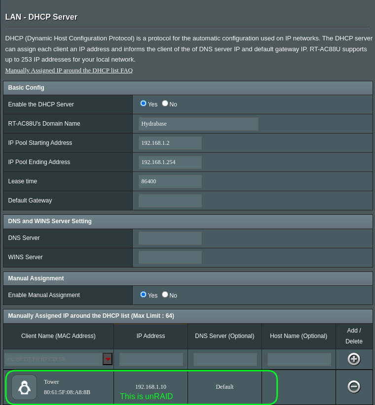

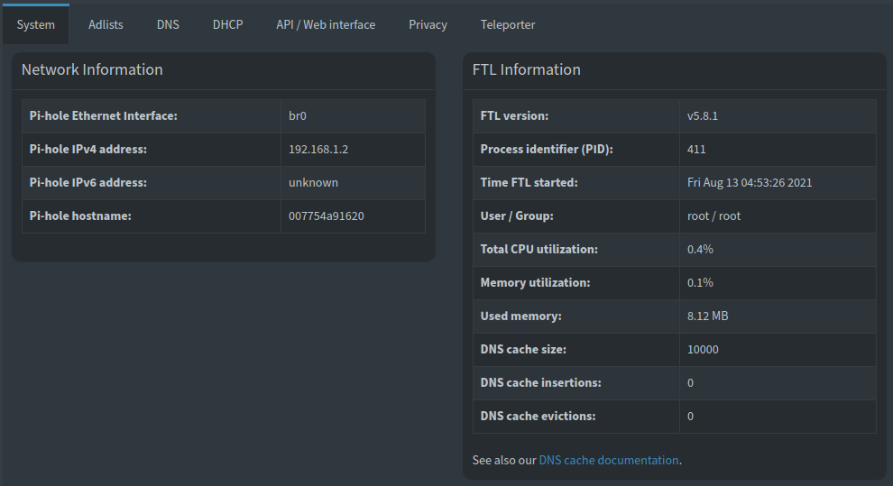

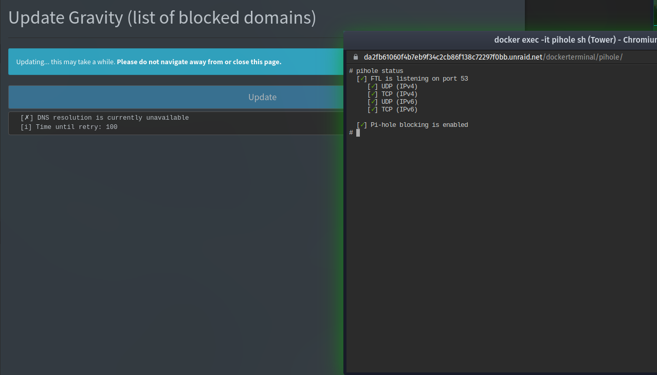

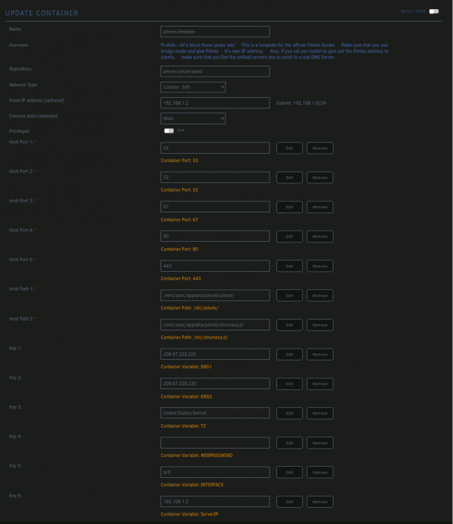

  12. I upgraded last night. I can no longer log in remotely. Going to my server address results in "this site can't be reached". This is my own fault but it is running on older hardware that uses an old VGA for video which is now lost so I can't physically see what is going on either. Not sure what to do other than find an old cable or monitor now. If I pull the USB key and put it into another computer and boot there (where I have a modern monitor) to troubleshoot plugins and settings would that work? Or does it need to see the correct drives to work properly and lose I lose everything?
  13. I am having a "DNS resolution unavailable" error when I try to update that. I don't think ads are being blocked because I still see a lot of them. Wondering if anyone can look at this and tell me what I have set incorrectly. I really don't know much about networking. Kinda flying blind following SpaceInvaders tutorial, but it looks a little dated. I took a few screenshots since they are probably better at explaining what is going on than I could.. I would appreciate any assistance.

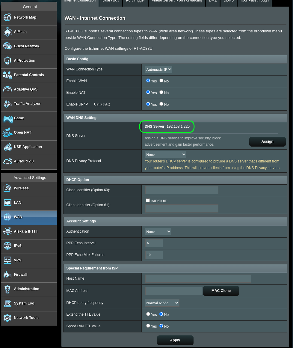

  14. I understand I need to fix this but I do not know how. That is why I posted all the screen caps. I don't pretend to know what I'm doing. I'm a regular guy who followed a youtube tutorial. I noticed that in my router in DHCP settings my IP Pool Starting Address is 192.168.1.2 and that is the IP pihole is using. Would that be a conflict? I thought that just meant that is the number the router would use to start looking for things on the network. When I tried an IP range outside of that for pihole it gave me an error saying it was outside the range of my subnet. Whatever that means.
