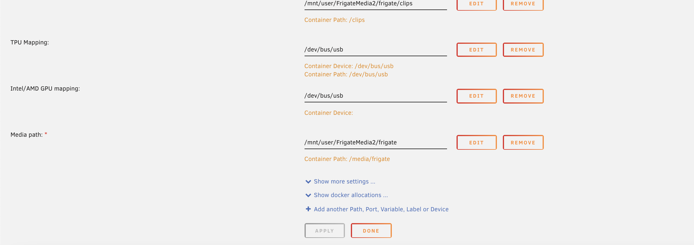

  3. That worked! Thank you so much. The trick was adding a device to forward and using apex. Woot!

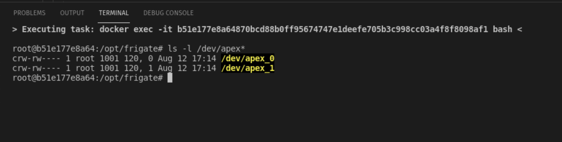

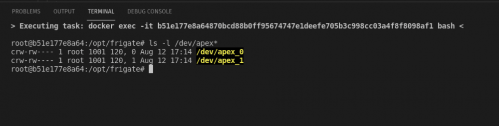

  4. Sorry I linked the wrong thread context its here. https://github.com/magic-blue-smoke/Dual-Edge-TPU-Adapter/issues/3 Issue exists on unraid 6.9 and 6.10... Think this is more of a driver issue? Maybe? So whats going on is that there is a dual edge tpu coral via m2 slot... When you plug it in via a m2/pci adapter you only get to use 1 TPU. Ie an adapter like this. Now someone came along and created an adapter that lets you properly pass through BOTH tpus to the system. If you goto the thread above, you can get lots more details. Now, if I pass thought the PCI to a VM ( qemu xml in unraid ) I can see the two tpu devices on the VM... I then can spin up the frigate docker instance that uses both coral TPUs and the docker inside the VM successfully uses both TPU devices. My theory is that the config is passed through to the VM and then frigate uses a config like this to recognize each TPU. I also had to install the TPU as PCI in the VM ie https://coral.ai/docs/m2/get-started/#4-run-a-model-on-the-edge-tpu detectors: coral1: type: edgetpu device: pci:0 coral2: type: edgetpu device: pci:1 Now in the VM, and then opening a shell IN the docker container I can run " ls -l /dev/apex* " ... Here I can see both tpu apex drivers or whatever. Now, when I open a shell to Frigate docker on Unraid ( same image as the one of the container, in the vm on unraid ) and run "ls -l /dev/apex*" I see this, My current working theory is that I some how need to forward the PCI/Apex drivers? to the container but I dont see a way to do this... Im thinking since I forwarded to the VM, then installed the TPU drivers via google/linux packages it magically worked to pass through to the docker container in the VM. I know this is slightly outside the scope of your driver tool plugin, but this interesting problem is causing me grief because I cant seem to get unraid to pass the dual edge tpu over to docker on Unraids native docker platform. I'd really like to avoid the over head of the vm. tower-diagnostics-20210812-1732.zip

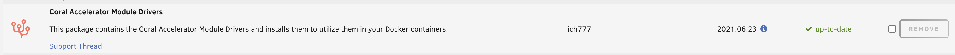

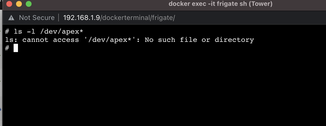

  6. Do you want me to keep the convo on GitHub or here ? My power is out right now, I’ll reply when I have power.
  7. Using PCI m2 Coral , I dont see the apex drivers in unraid root@Tower:~# ls -l /dev/apex_* /bin/ls: cannot access '/dev/apex_*': No such file or directory I do see the PCI device however 03:00.0 System peripheral: Global Unichip Corp. Coral Edge TPU 04:00.0 System peripheral: Global Unichip Corp. Coral Edge TPU Im trying to pass the PCI coral over to a docker instance. im using the coral drivers plugin. Unraid 6.10 rc Interesting part is that im using a new dual edge adapter card that exposes both tpu cores to the system. In a VM I can get everything to work and can use Frigate with dual TPUs even with docker in the VM... But on the Frigate docker instance in Unraid, it cant see the dual tpu pci card? some content -> https://github.com/blakeblackshear/frigate/issues/1428
  8. Using PCI m2 Coral , I dont see the apex drivers in unraid root@Tower:~# ls -l /dev/apex_* /bin/ls: cannot access '/dev/apex_*': No such file or directory I do see the PCI device however 03:00.0 System peripheral: Global Unichip Corp. Coral Edge TPU 04:00.0 System peripheral: Global Unichip Corp. Coral Edge TPU Im trying to pass the PCI coral over to a docker instance. im using the coral drivers plugin. Unraid 6.10 rc Interesting part is that im using a new dual edge adapter card that exposes both tpu cores to the system. In a VM I can get everything to work and can use Frigate with dual TPUs even with docker in the VM... But on the Frigate docker instance in Unraid, it cant see the dual tpu pci card? some content -> https://github.com/blakeblackshear/frigate/issues/1428
