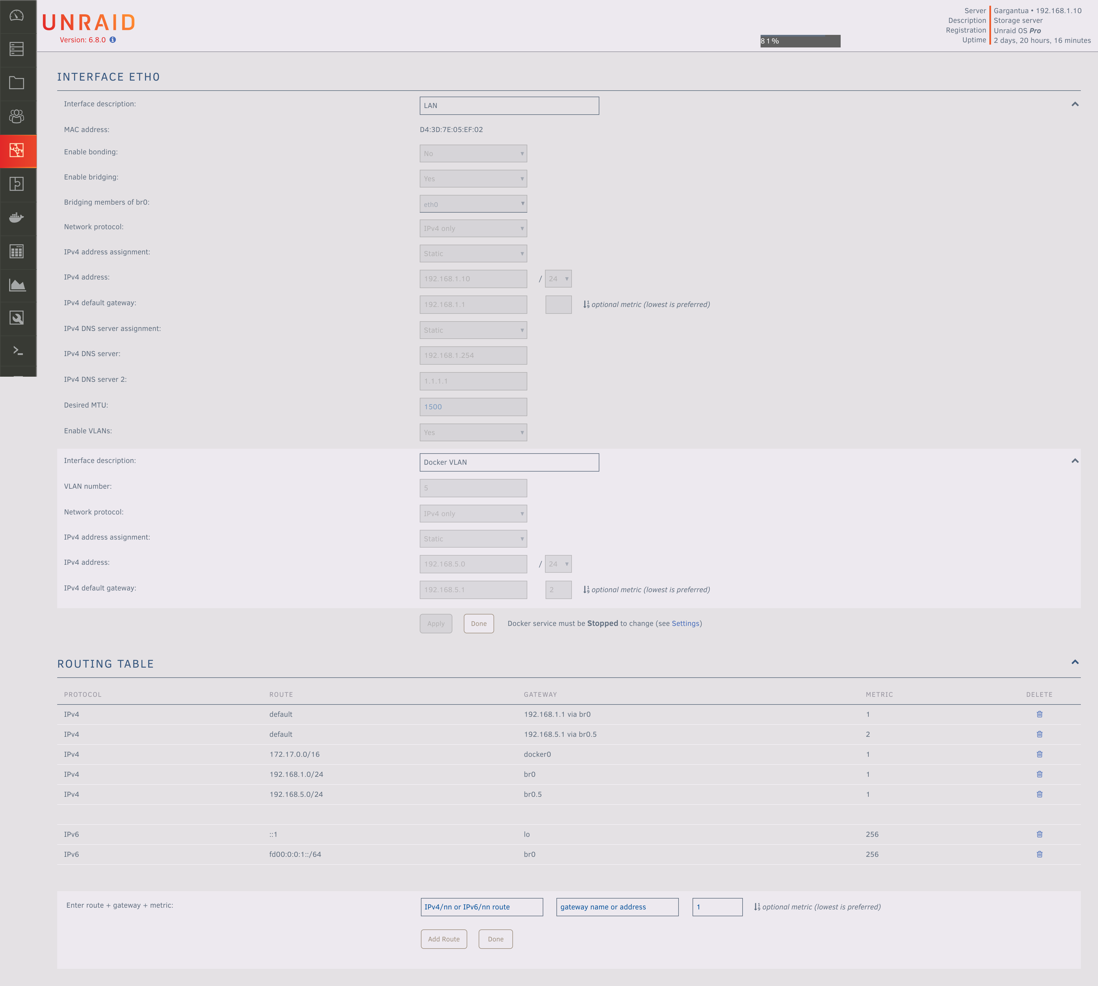

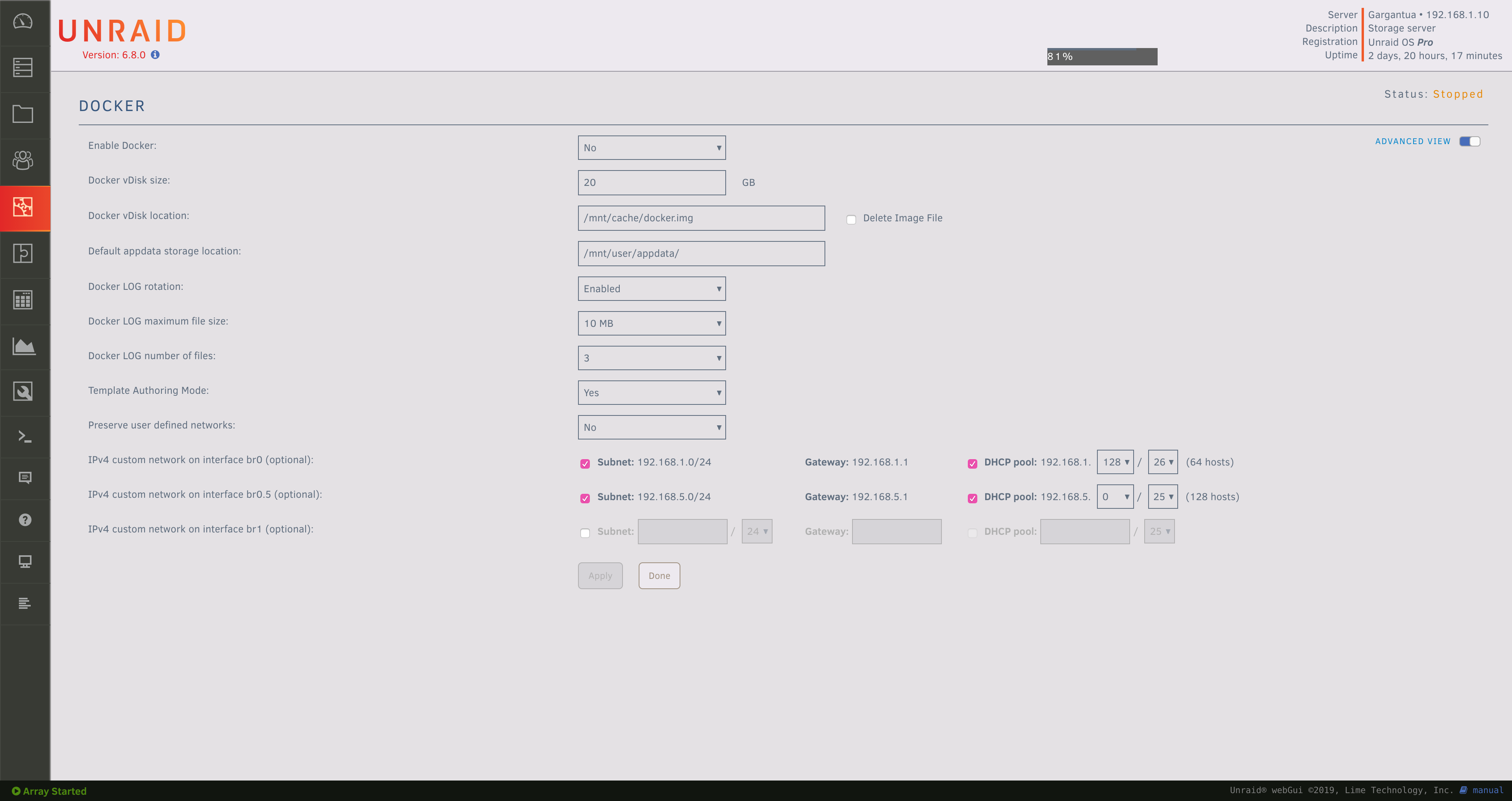

  3. I have the VLAN listed in my Docker settings as shown above and br0.5 is listed on the Docker settings page. However Docker network ls or the 'Network Type' dropdown on container templates is not showing it.
