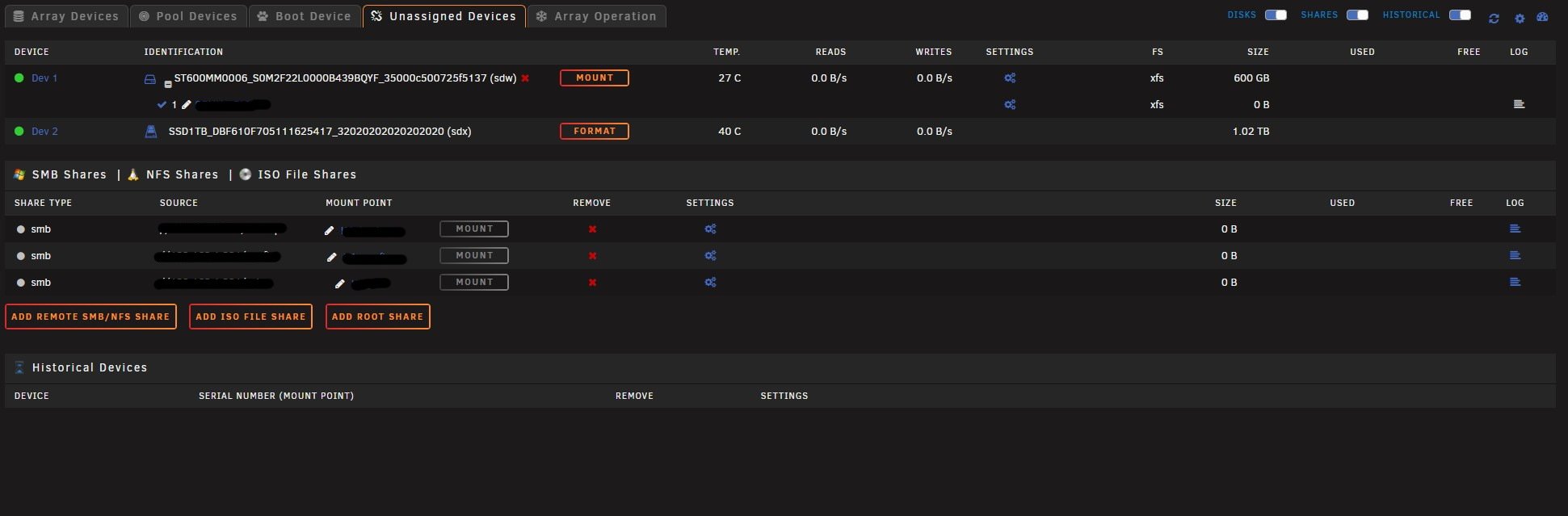

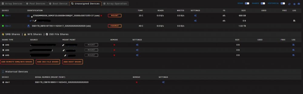

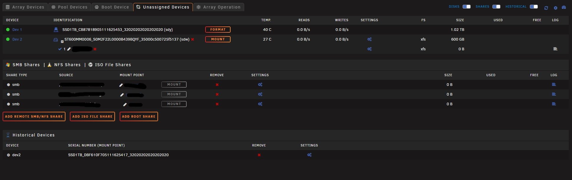

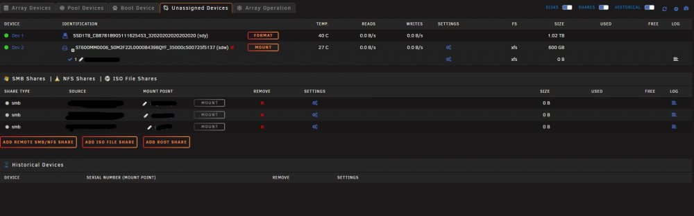

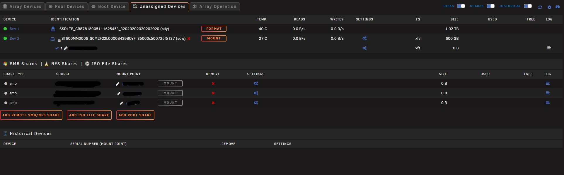

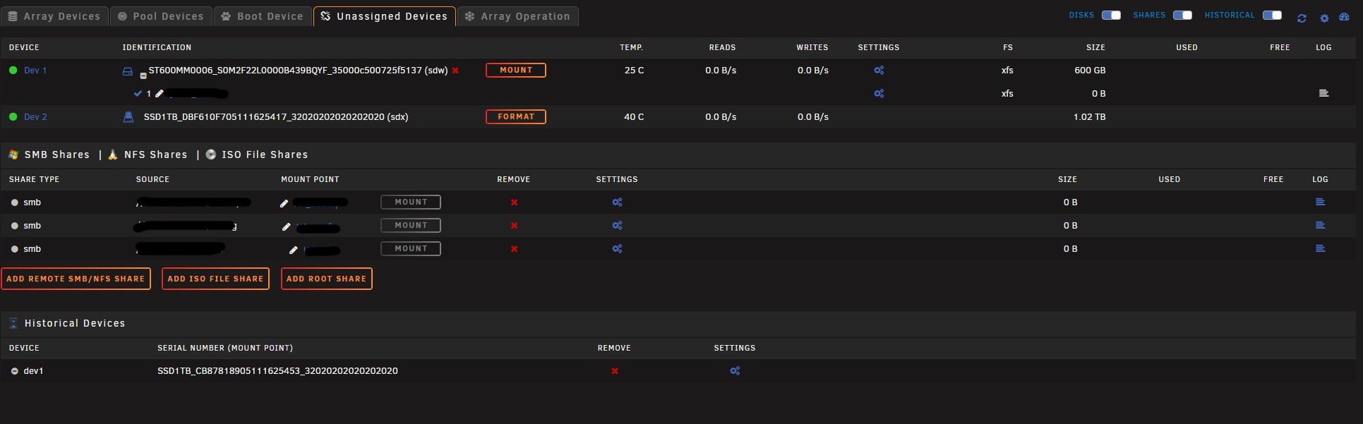

  7. Hi All Having a strange with 2 New SSD's where they are reporting the same SCSI ID/WWN, this is causing an issue where only one can be online at a time, else UnRaid fills the logs with one of the following, dependant on which drive is online. May 27 11:53:16 UnRaid emhttpd: device /dev/sdx problem getting id May 27 12:19:29 UnRaid emhttpd: device /dev/sdy problem getting id Both drives function when only one is plugged in, but i was going to make a cache pool out of the pair, which i obviously cant do unless i can get them both online. As you can see from the attached images, both disks have _32020202020202020 appended to the model/serial, is this a drive issue, or something i can change from within UnRaid? Images are to show the various stats of both drives being online individually, also does not matter if i remove the drives from the historic Devices One Drive Plugged in Adding a second pushes the first into historic devices removed from historic reinserted the first which pushes the second to Historic Devices Thanks
