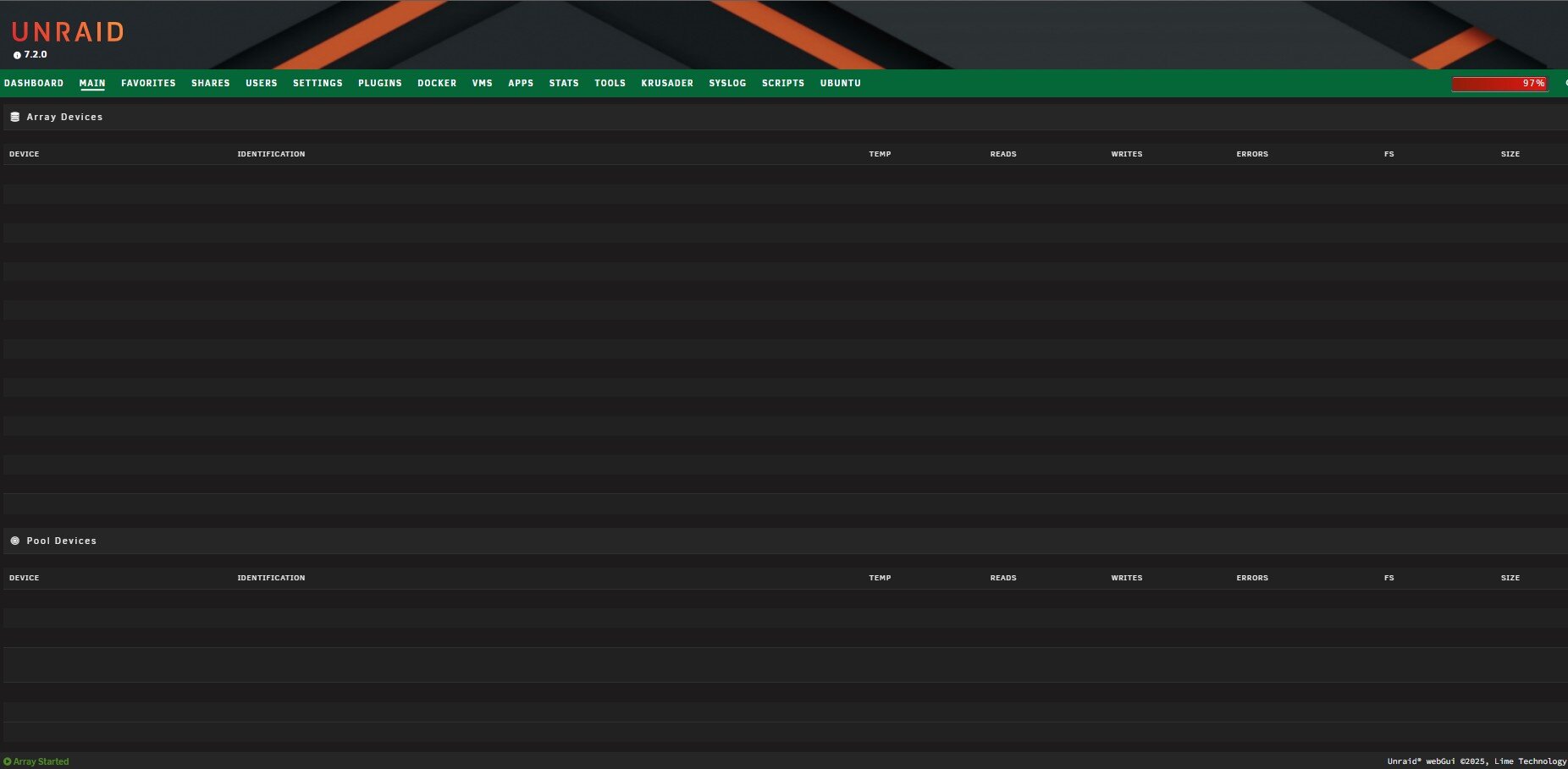

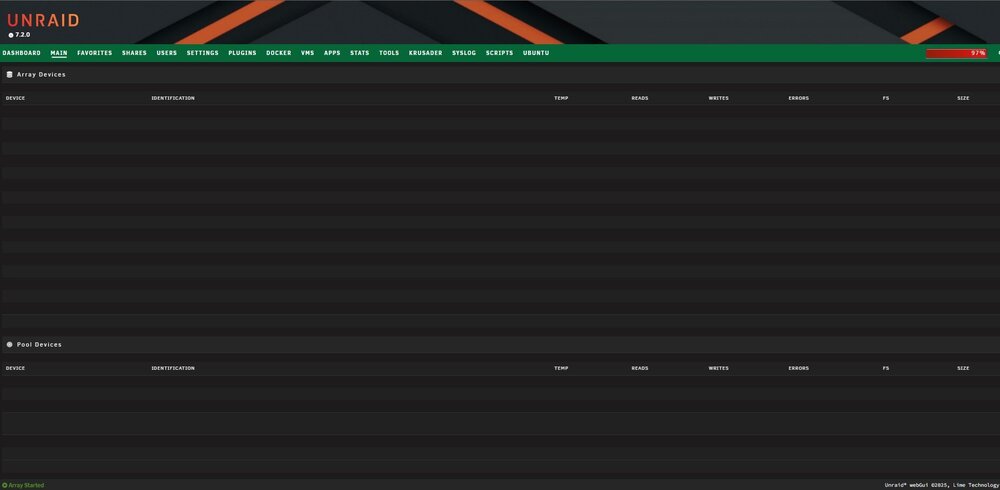

  3. I can see the devices perfectly in main before starting the array, when I start the array what I have in the screenshot appears.
  4. It's very risky to do what you suggest. I have parity, 16 disks, cache, and other pools. Right now, "everything" works, but as I mentioned before, the problem doesn't appear after starting the main system (RAID). It only happens after starting the array, because something is wrong with the RAID.
  5. That was the first thing I did, it's the basics. I also tried incognito mode. No luck; something must have happened at the unRAID level.
  6. Hi, I'm having trouble with the main tab. I was using version 7.1.4 when it started. All I did was add a disk to the unallocated devices. I've tried restarting with nginx restart, but it didn't work. I also tried safe mode, but that didn't work either (it's not the plugins). I updated to version 7.2, without success, and even tried beta 7.2.1rc, but that didn't work either. I've reverted to version 7.2.0. Any solutions? I've tried the ones you mentioned, and none of them worked. Thanks.

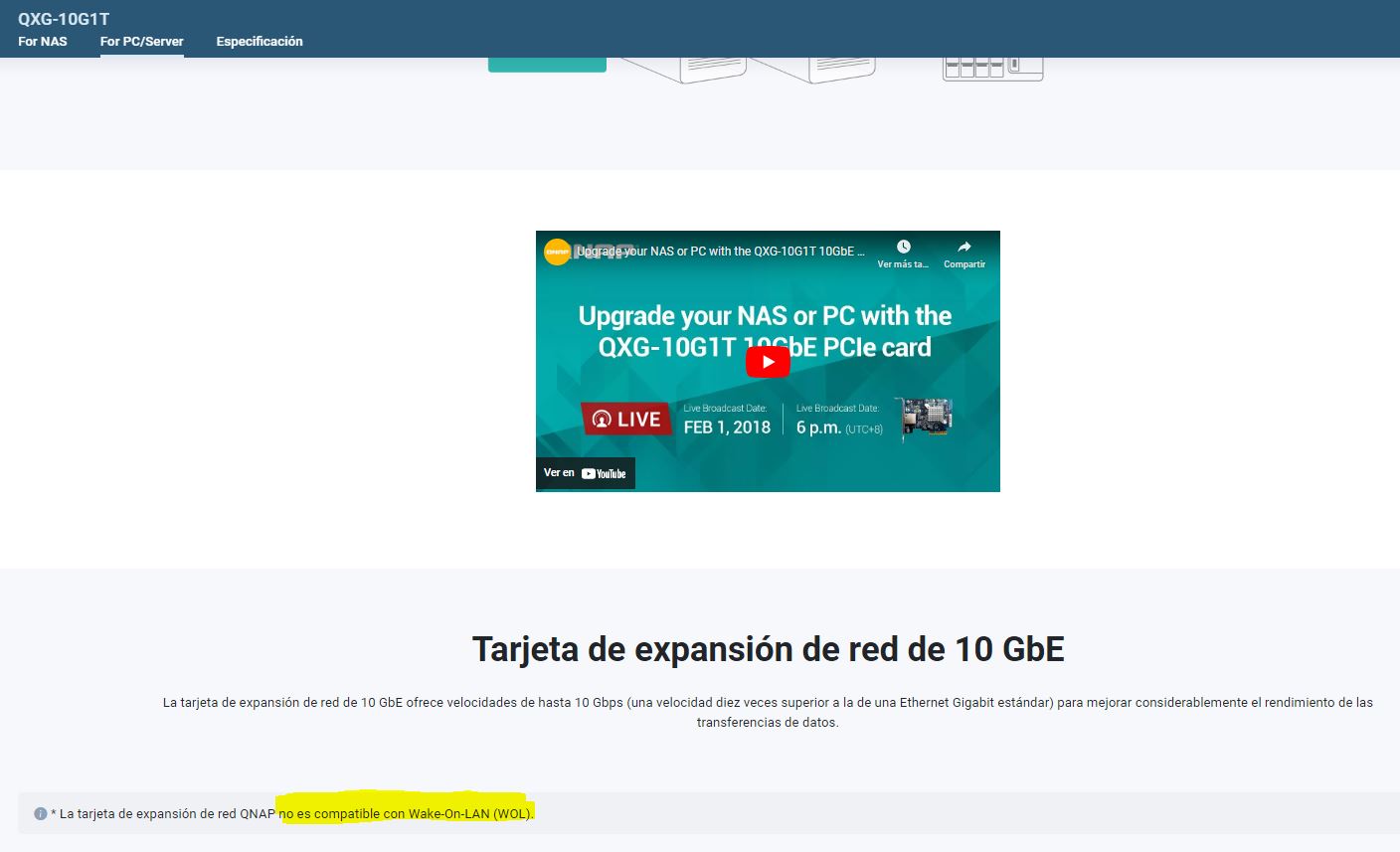

  9. No es compatible con WOL consulte las especificaciones del fabricante

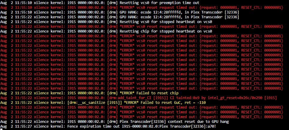

  11. mmm la version del servidor linux linuxserver/plex:latest (plexVersion 1.28.1.6041), confirmando que es compatible. UnRAID 6.11.0 RC3??.. It is a question

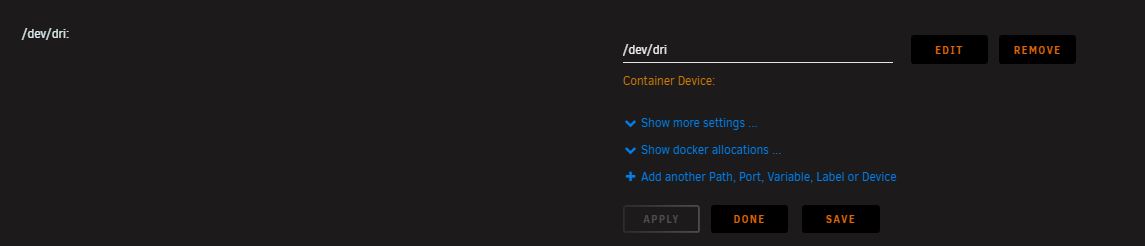

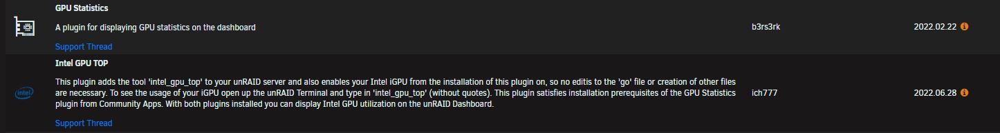

  12. If it was just to show the errors, it's all disabled and removed dev/dri

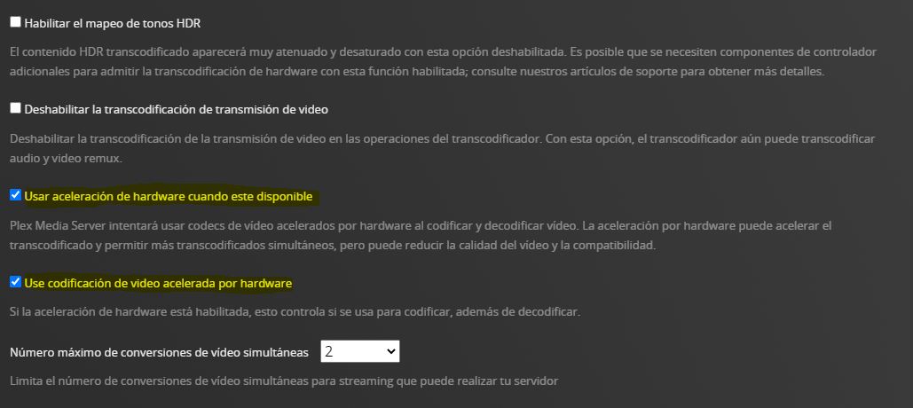

  13. Probé Intel 12600 UnRAID (Version: 6.11.0-rc2 ), Docker Plex oficial (Versión 1.28.0.5999), tonos HDR deshabilitados, HW habilitado. falla
  14. I have tried 6.11 Rc1 and the latest official plex version. My IGPU (12600), I have some crash problem, which is NOT 100% compatible
