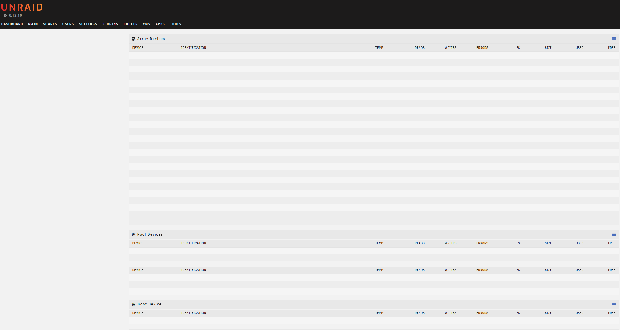

Just had this happen to me again, was a long time since last it happened. Tried logging out (waiting a couple of minutes) and in again, tried different browsers and different device. Main tab is empty on all of them.
On version 6.12.10
Mine just went blank on me for the first time after moving a bunch of files with unbalanced. Only the Main page looks like your screenshot. I'm also on 6.12.10. I know there are a couple of updates, but I'm not sure if the parity is still doing its thing. I'm still moving files around also. Same with another browser as well that wasn't signed in.

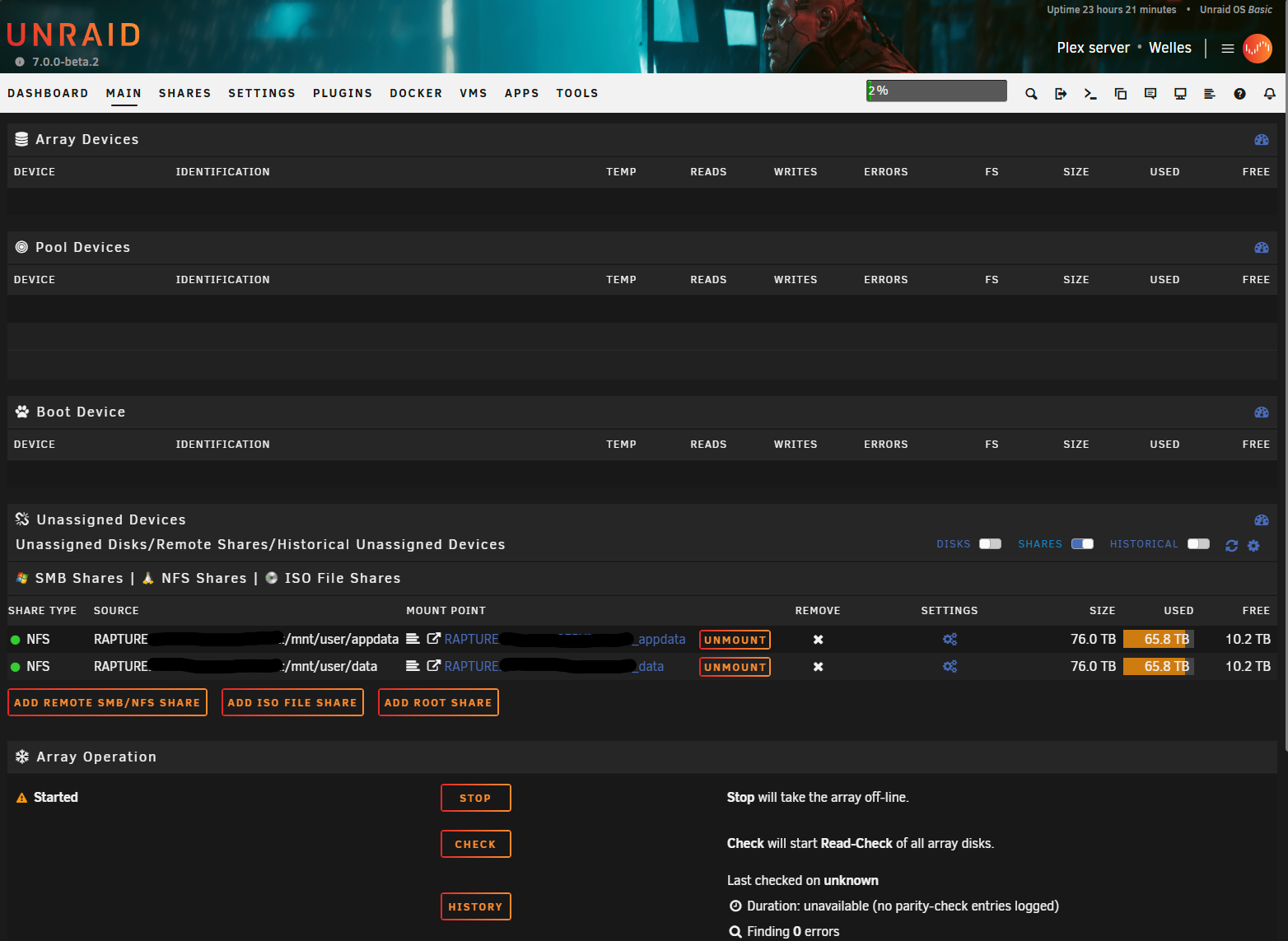

This seems to still be occurring in 7.0.0-beta.2:
Any ideas?
This is ridiculous that this has been happening for so long with many updates since this started happening, WTF unraid/LIME!!! I paid for a working product, how about fixing this. THIS IS UNACCEPTABLE!!
