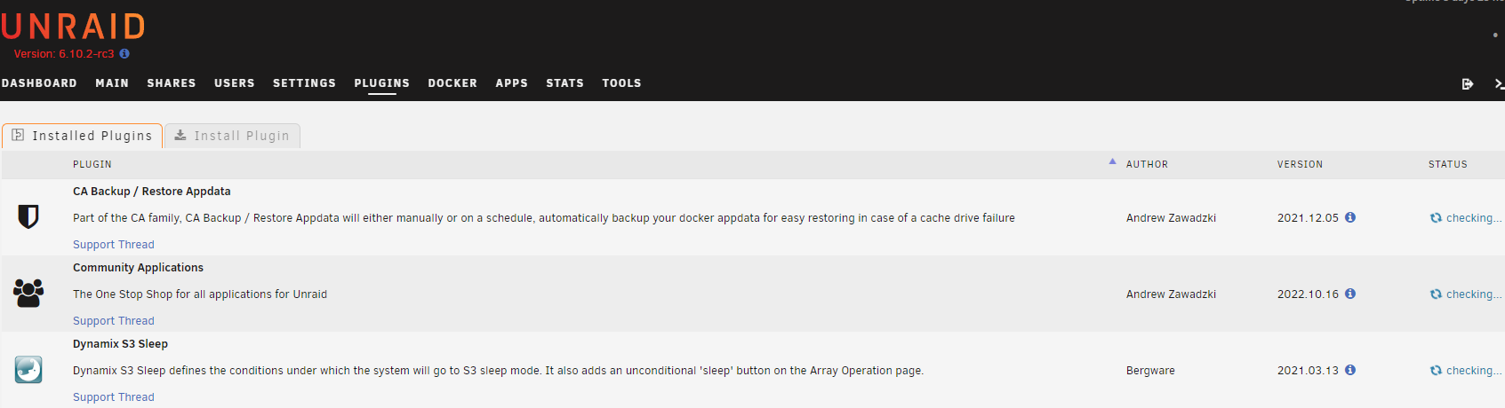

  7. Hello Kizer, sorry for the delay getting back, had to get out to a customers site to help out with a project. So last thing I tried was pinging yahoo.com, thinking that was the proper commend, and 100% loss. Today I tried ping 74.6.231.21 and had good response. Everything seems to be working, everywhere else. Plex connects from my home as well as on the road. Docker updates work, no problem. Community App installed. Seems that the only issue is the plugin page with all plugin's "checking" status.
  8. Seems that I can not, but I don't know for sure. I tried pinging Yahoo from terminal and it's hung up here: I am able to connect to Plex, so I thought I was good to go. I will look for instruction on fixing that and get back if the problem consists. Thank you for the pointer!

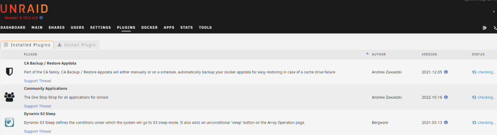

  10. Seem to have a problem here with Installed Plugins. I noticed it when I could not see "unassigned devices" on my main tab anymore. Any thoughts would be greatly appreciated. One thing my researching has led me to was to ensure my timezone is correct, it was not, but now is. Everything else is updated.
