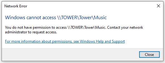

Thank you all for your help. I ended up building a new array with a 4tb parity and 2 2tb drives. Plan on expanding later, but for now this is sufficient for me.
Here is what I am now seeing. I was able to mount the old drives as "Unassigned Devices" and use Midnight Commander to transfer files. Little cumbersome, but working well. I did not realize that the directories were split among the different drives which is adding another level of complication.
What I am finding is that some of the directories under my main directory "Tower" are not accessible from Windows Explorer. I have "Tower" set as "Private" and have "read/write" permissions set for my user. When I try to get into 2nd level of directories I get a network error message. Using Windows Explorer would be MUCH easier combining fractured folders, but more concerning is that I can't navigate to the files for use.
Any thoughts as to what I am doing wrong?
There is no one simple answer to your query.   The reason being is that error message is a very generic one about SMB access failures.
Begin by reading this post and follow its advice:
        https://forums.unraid.net/topic/89452-windows-issues-with-unraid/page/10/?tab=comments#comment-959725
Should that not solve your problems then move onto this post and the next several that follow it:
      https://forums.unraid.net/topic/25064-user-share-problem/?tab=comments#comment-228392
The first post attempts to resolve security blocks that MS has added to Windows that often have to be resolved.  The second one deals with the actual way that SMB works with user credentials and the way that Windows handles those credentials.  Things can occur in the background that will often feel the poor user without a clue as to what is really happening.

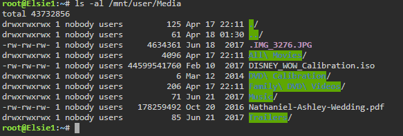

I just had an epiphany.  What I saw initially as a pure SMB access issue, I now see could well be a file/directory permission issue.
Were you using mc to copy from a HD mounted with the Unassigned Devices plugin directly to a disk?  (The other way would have been to copy from the Unassigned Device mounted HD to a User Share.)   (Today it is recommended that users use Shares rather individual disk access.  In fact, disk sharing is turned off by default.  Thus, you only have access to User Shares via SMB!)
Check to see that your owner/group and file/directory permissions look like this:
I am assuming that you are well enough versed in Linux operations to do this since you were using ver4.3 of Unraid.  (If you need help, just ask.) Oh, there is now a built-in terminal in Unraid, just look for the       >_       on the right side of the Toolbar.
IF they are not as indicated, there is a script that will fix the problem called   New Permissions  under  Tools.    Run it only against the User Shares that you are having a problems with.  It can take a long time to run as it will work on every file and directory in the share.  I also seem to recall that it runs 'silently' so wait for it to finish.  I seem to recall that the command line prompt will return when it is done.
That is exactly what I was doing! I thank you Frank, I will go over this when I am done transferring files.
Looks like my permissions are not correct? None should be shared "root", correct?
And sorry to say, I was only somewhat familiar with Linux back when I built the thing so long ago. This has been a learning experience for me, to say the least.
