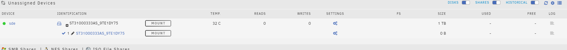

That suggests that the device /dev/sde may have dropped offline.
Here is how it's showing up:
Little history, I was able to mount 3 of my 4 drives as unassigned devices to move the data onto new array. This drive is one that I thought I could put into my Desktop to get the files, which is probably what i did wrong right off the bat.
