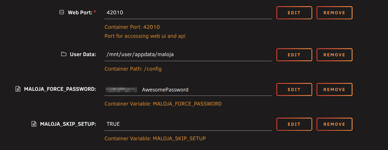

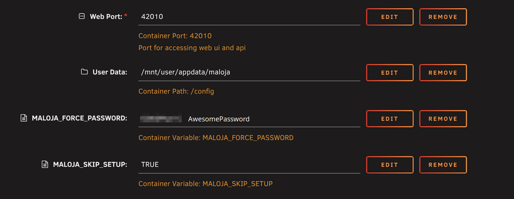

  12. Hi @FoxxMD, Thanks for creating this template! and FYI, without MALOJA_FORCE_PASSWORD and MALOJA_SKIP_SETUP I could not access /admin_settings. Adding both to the container variables fixed it. Thanks again!
