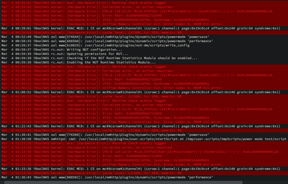

  9. I've read in the manual for the board that yes, the board follows the specification from the modules' SPD, so that's alright I think. But.. the errors are back: I turned off Spread Spectrum Control. I turned off Boost override I disabled C-state and put another setting to Typical Current something I disabled audio controller I disabled internal/m.b. built-in ethernet ports I modified the fan curve Confession: 2 of the RAM sticks came from Micron, the other 2 I purchased 2 years later came from "Hynix" I think it was called. Confession #2: I ran around 2 years I think without a UPS, and we have the most unstable power situation. Anyway.. I think the memtest86 I ran concluded the memory is fine, I'll try to run it on my PC and see if it's any different, and will try another CPU on the server see how that goes.
  10. BTW, is it ok if the board auto clocks up? I have all the OC settings to auto/default, yet the BCLK actual clock becomes 100.48MHz, and so the memory clock instead of 2666MHz goes to 2679.52MHz. I've read online that it's "normal" for boards to do that. Is that considered within spec? Or must I bring it below?
  11. Hey this is very helpful thank you! Oh yeah it is dual rank... Kingston Server Premier 32GB 3200MHz DDR4 ECC CL22 DIMM 2Rx8. I guess we're running 2667MT/s Will test and report back.
  12. If I forgot to state, I have a 5900X, and 4*32GB of 3200 MT/s ram. So I've obtained memtest86 software and put it on a flash drive and got to work, ECC tests (Polling and Injection) were enabled. It's been 4 hours, Pass 1 completed with 0 errors. Reading what you said again, and looking at the errors again.. it does say L3 Cache level/Unified Memory Controller.. so maybe it is the CPU! I have 2 other CPUs a 5950X and a 5800X, I could try those I guess? I'll finish for the 4 passes to complete, then if no errors occur, I'll put in another CPU and run the system see how that goes.

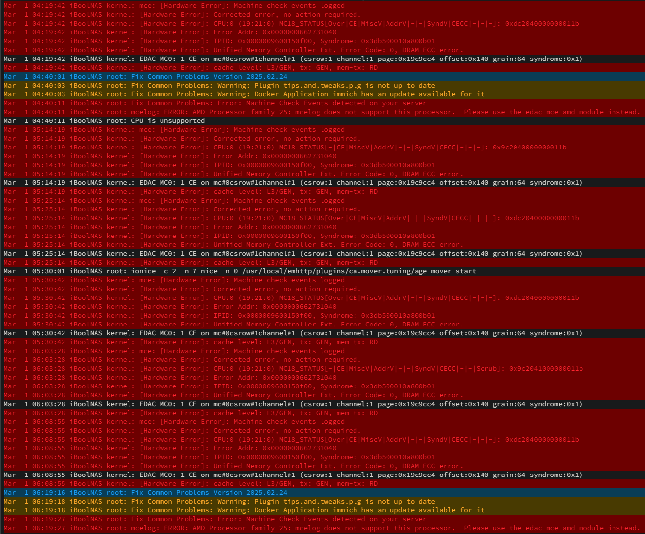

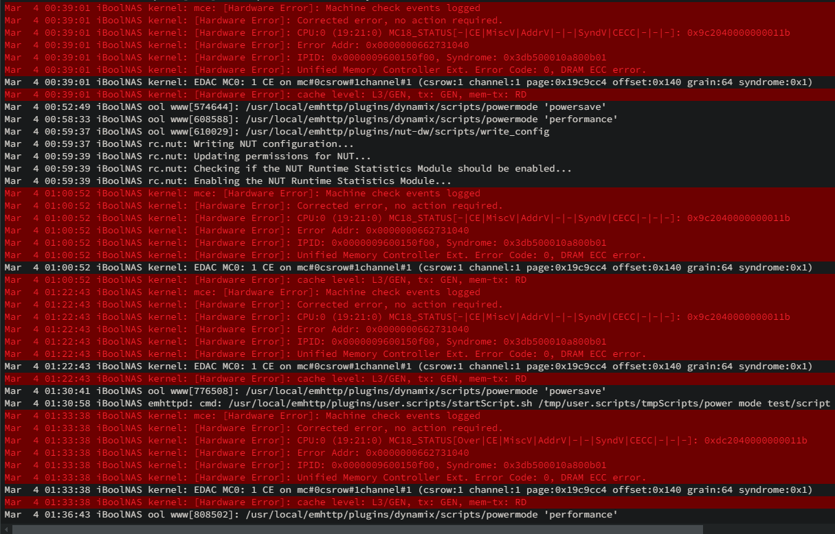

  13. Very helpful reply thanks a lot. Could those be false positives? As in, could it be some software error triggering those hardware errors? Or is it really really broken? Also, that memory was very expensive.. how would it just "break?" like this? Is it something I did? Is there something I could do better? Or is it just what it is? 3rd and last question, is it ok if I choose to ignore the error? What consequences could happen from this sort of error? (I mean since ECC is correcting them.. should I still be worried? Thank you!
  14. Can anyone help me here? Since this post last year I'm still getting these errors daily: I replaced the Flash drive, and resolved the macvlan/bridging errors. Those aren't causing any issues. I attached my diagnostics file in the original post you can check that out, it's still the same exact errors.
  15. This error happened again: A few months ago I bought 3 SanDisk 16GB Cruzer Blade USB 2.0 Flash Drives, before them I had a tiny samsung 32GB one which did as the same current issue.. you're telling me these flash drives fail this often...? what sort of usb port could be this bad.. in my head I blame unRAID for being sensitive it's how I feel, but I don't know.. this is odd For the second macvlan issue, the reason I use it is because I'm using bond on eth0, that way if I switch the cable by mistake between the two ports on the NIC my static IP will not be reset on the router, because they have different mac addresses, and the bond solved that issue for me. Maybe you can @ someone who can maybe help with the first issue I mentioned? the hardware issues and what they could be related to Thank you very much!

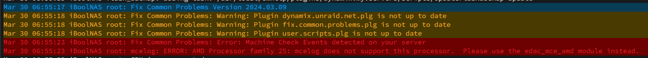

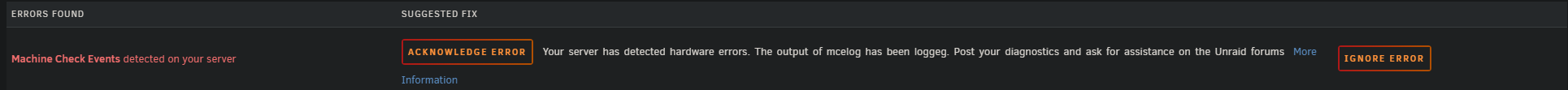

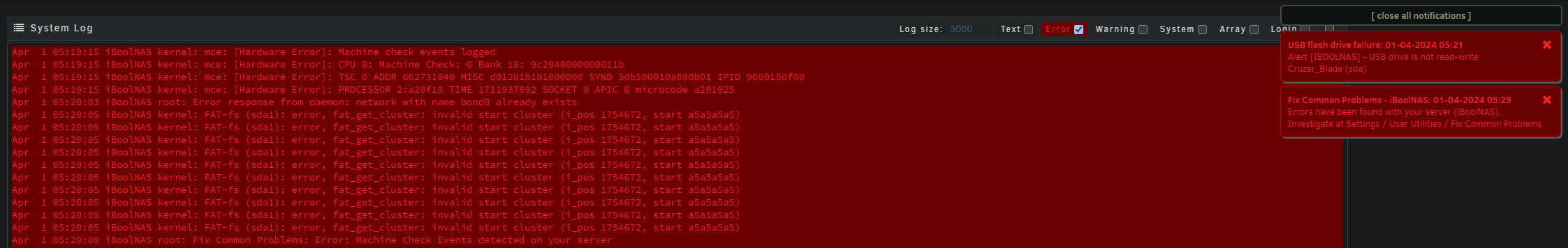

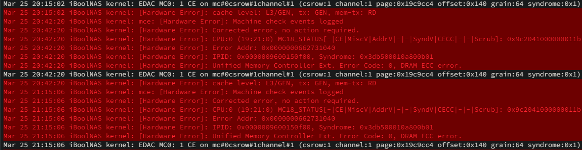

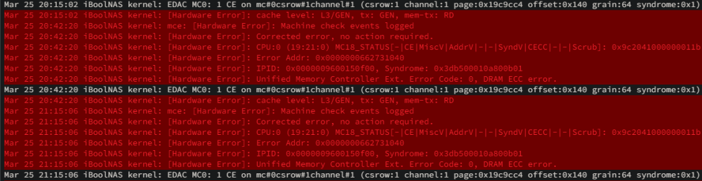

  16. I've been accumulating a bunch of erros that need support: 1. Hardware Erros: Most urgently, hardware errors in syslog like this (these are filling the syslog, every hour from march25 until today) 2. flash is not read write: I've had this error a few times happen, it disappeared now so I don't have screenshots. I don't know what's caused it or why it disappeared.. maybe it's affecting other things 3. Failure updating plugins: The reason I went to syslog in the first place, plugins have been failing to update for a while (the error also happens with User Scripts and Unraid Connect) 4. Machine Check Events detected on your server: I did read in a few other threads (machine-check-events-detected-on-server, problems-with-ryzen-cpu) that this issue is safe to ignore, but I wanna see if it's linked to those cache memory failures I mentioned in the beginning: 5. Macvlan and Bridging found: This error I had a while ago in Fix Common Problems, I added it to the ignored list, but now I cannot un-ignore it: iboolnas-diagnostics-20240330-0543.zip
