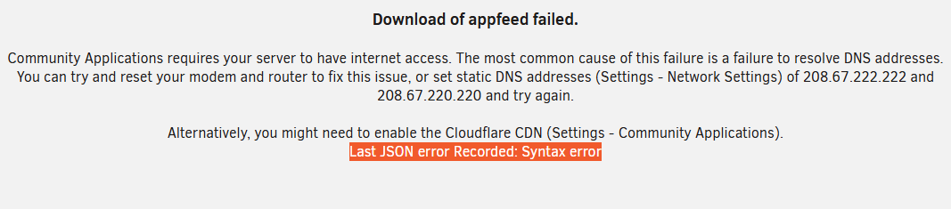

Hello everyone, Since today, I have been experiencing an issue on both of my Unraid servers where no apps are loading anymore (see attached image). It does not appear to be a DNS issue, as I have already tried both DNS servers as well as Cloudflare DNS. The error message is: As mentioned, this is happening on two separate servers. I also found another thread here in the forum where someone is experiencing the same issue. Therefore, it seems to be a more widespread problem.
