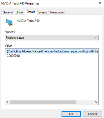

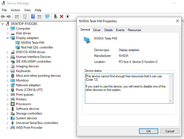

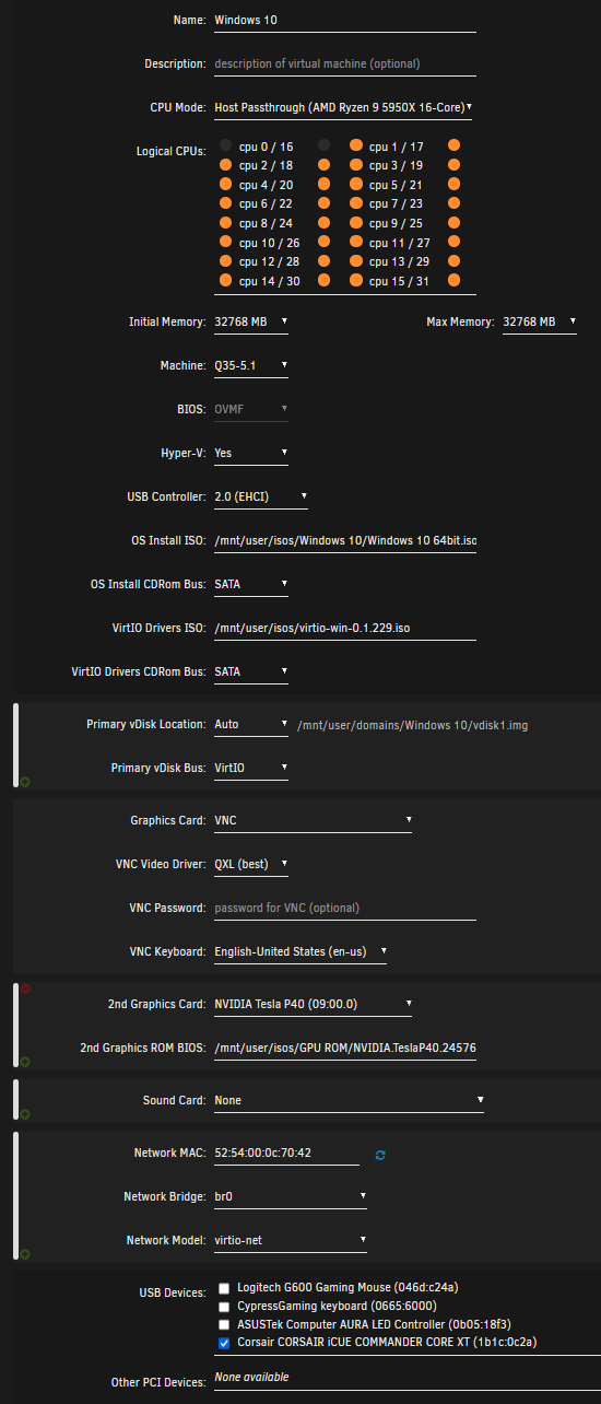

  13. The card is 24gb. I didn't think it would be an issue on address size. I still don't really know how all that works. When I was searching for code 12 errors I didn't see any direct correlation to address size so I pushed those results aside. It didn't help that most results weren't for my use case anyway. Again, thanks a bunch.

  15. Holy smokes, it's worked. I'll begin testing actual functions of the card, but for now Windows is no longer complaining and GPUZ/Afterburner have recognized it. Even Nvidia control panel is working. How did you end up finding that post? I didn't think a card from 2016 would have resizable bar. My GPUZ says it does. Thanks so much!
  16. I recently bought a used Tesla P40 for AI work with Stable Diffusion. I planned to run it in my Windows 10 Pro VM. However after installing the Telsa P40 data center drivers from Nvidia Windows will recognize the card but will display a Code 12 error saying it cannot find enough free resources. I am completely stumped at this point. The GPU works perfectly fine when running bare metal. But as soon as it's passed to a VM it's not functioning. I tried Linux Mint at one point, drivers installed successfully (as far as I could tell) but Mint would notify that it can't detect an appropriate GPU. Any help would be appreciated. If you have questions let me know. Here is my VM setup and the XML
