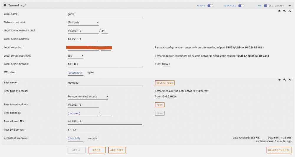

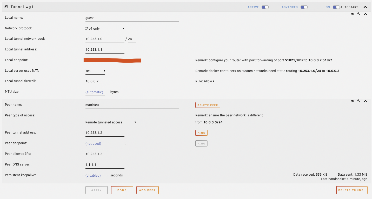

  8. Hello, I have created 2 VPN tunnels on my server, one "admin" and one "guest". The admin has access to everything and that's what I want. On the other hand, I don't understand how the "Local tunnel firewall:" parameter works because I put it in deny mode and then I added the ip address of the vm I want to allow. Example 10.0.0.7 But, when I connect with the vpn guest I have access to all the devices on the network. But I would like only the indicated ip to be accessible. Thanks for your help, I hope my question is asked in the appropriate topic
  9. Damn, it works I don't understand why it doesn't work with my DNS! I use a docker with AdGuard Home and it works for all other devices. Thanks a lot @jude If you ever have an explanation of why I can't use my DNS I'd love to hear it.

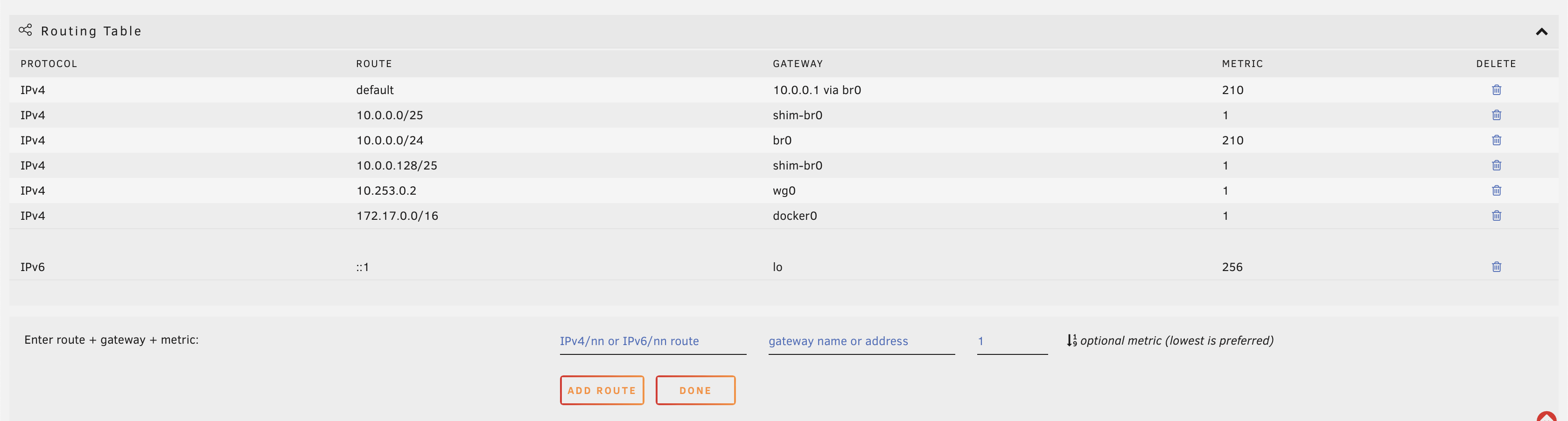

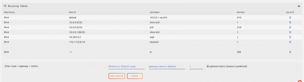

  10. This is my current configuration, maybe there is an inconsistency that I don't see

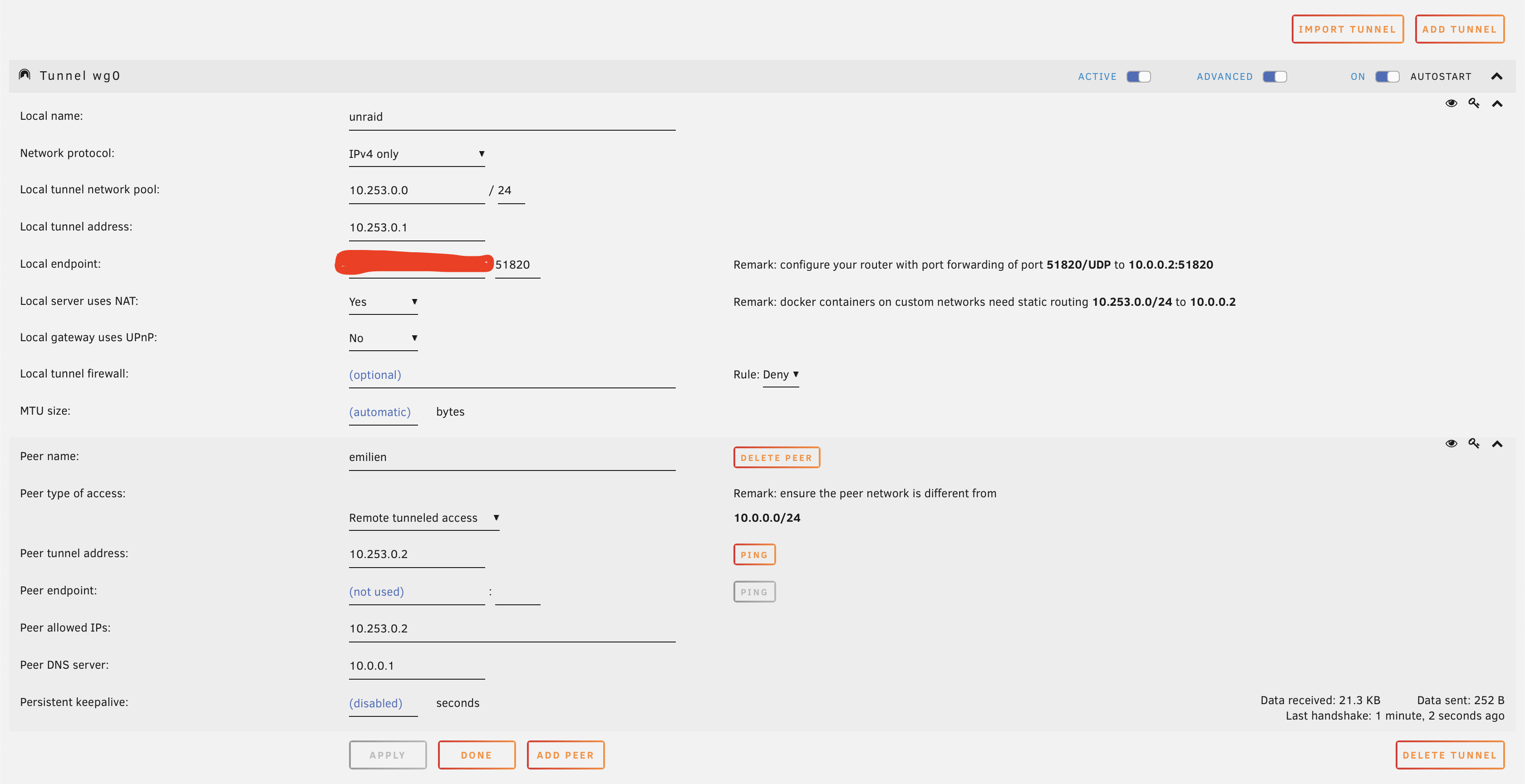

  12. Hello, my VPN connection was working perfectly for several months. I had followed the instructions and set up a "Remote tunneled access" connection with a "local endpoint:" which had a duckdns.org address. Recently, I bought a domain name and I now use home.firstname-lastname.com to connect to my local network. So I deleted my WireGuard configuration and start over with a "local endpoint" = home.firstname-lastname.com, still in "Remote tunneled access". I have access to the local network and to the devices, 10.0.0.1, 10.0.0.3 etc, but I can't search on the internet when the VPN is active. To make matters worse, I reset the original configuration with duckdns.org thinking it was a problem with my domain name, but now even the original configuration creates the same problem with impossible internet searches. Please, can you help me to see more clearly?
