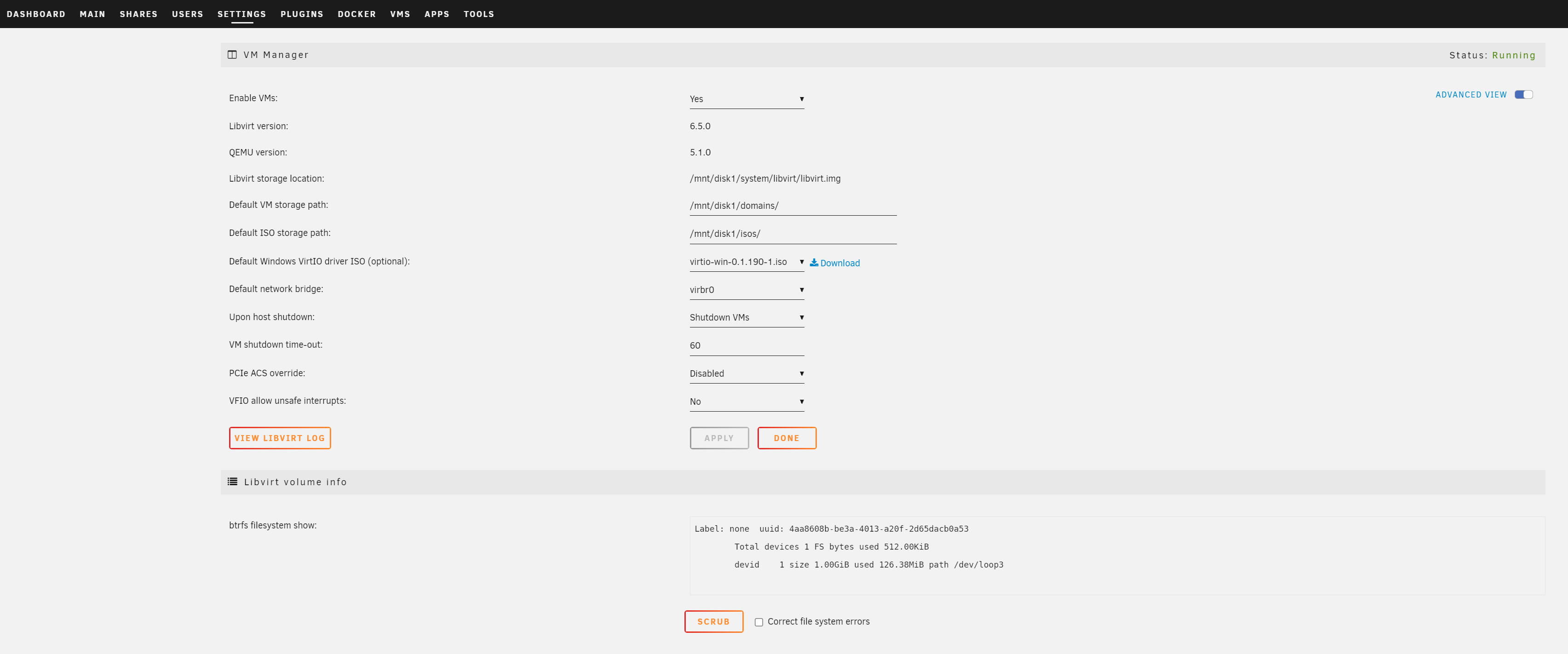

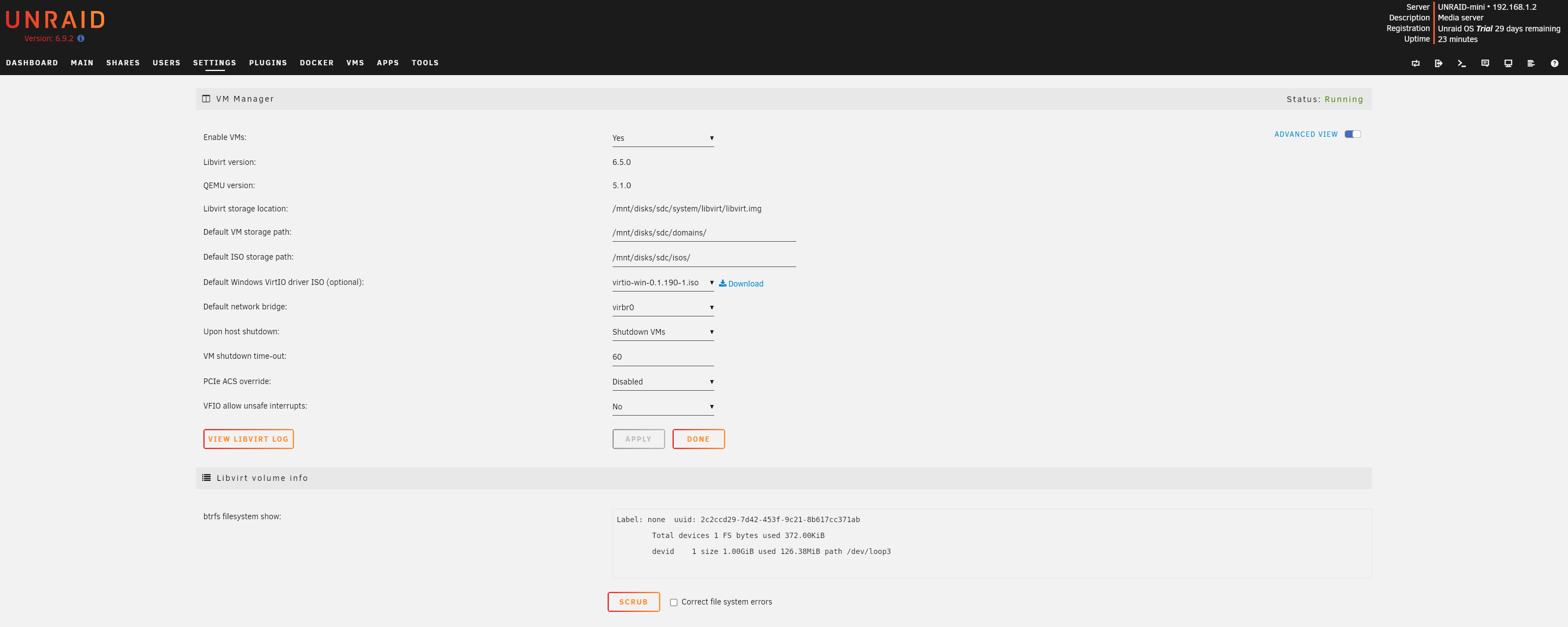

hi, after re-config the VM manager's settings re-add the vm and restart the array, the diagnostics is also attached below unraid-mini-diagnostics-20210825-0016.zip

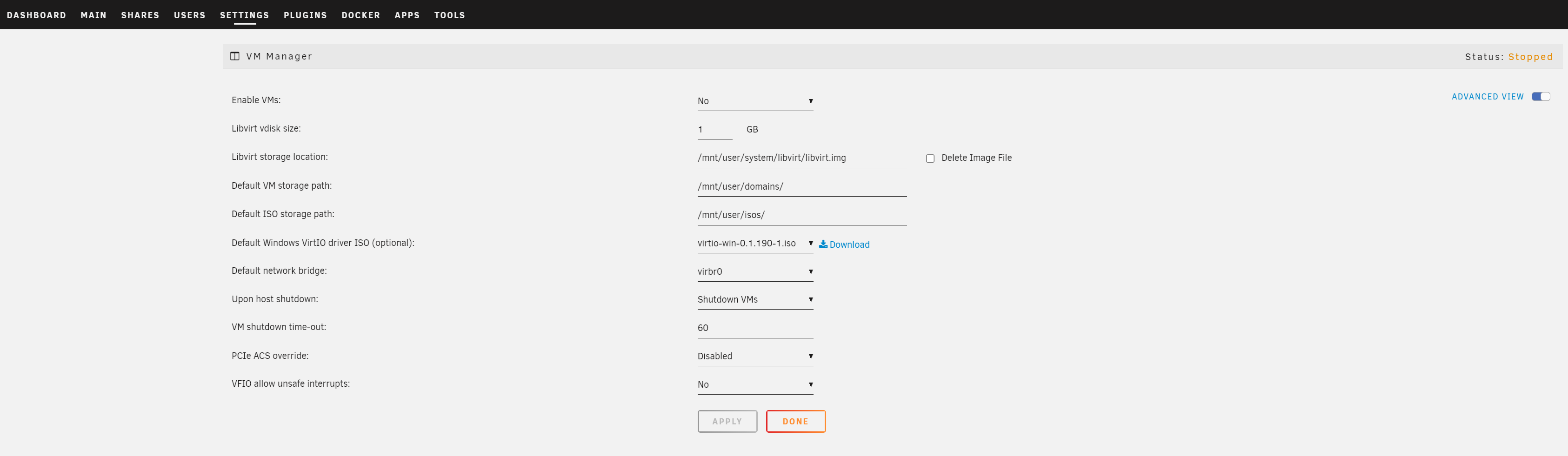

lost VM manager's configs and can't automatically start it after unsafe reboot

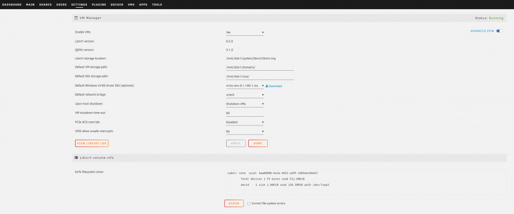

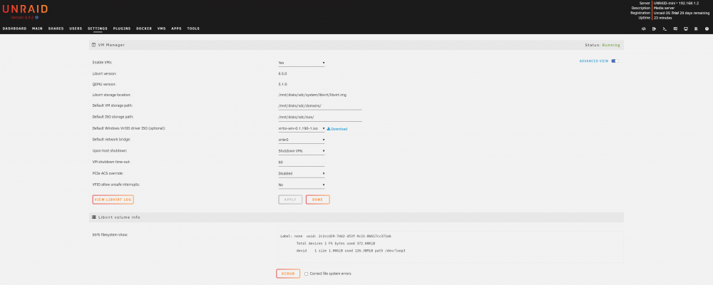

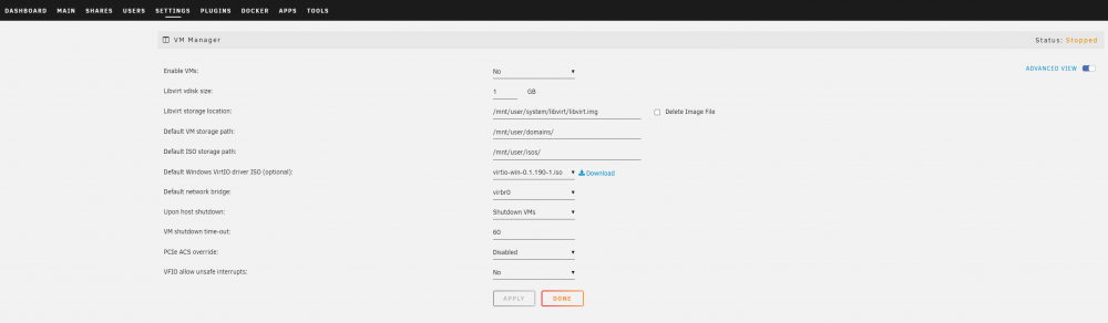

hi, I'm still during my trials but there are some problems with the vm manager. I've set the VM manager like this but after each unsafe power cycle (like power failure), the VM manager won't automatically start and all the configs of it will be set to default, like this why it happened? and how to fix it?
