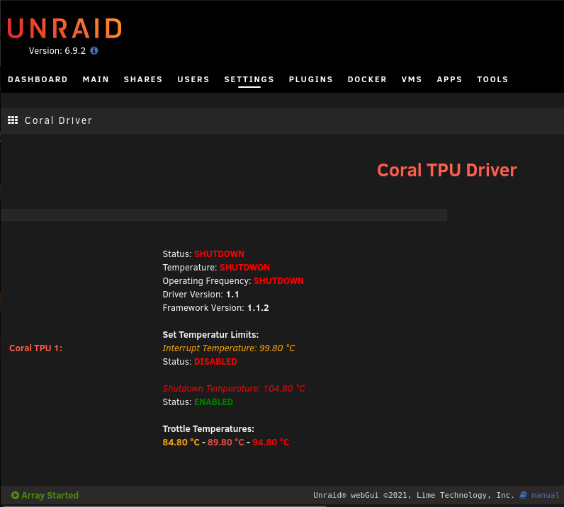

Hi @ich777 Ok, it seems the issue was indeed with the TPU reaching high temperatures. shutdowntemp0=104800 shutdown_en0=1 shutdowntemp1=104800 shutdown_en1=1 shutdowntemp2=104800 shutdown_en2=1 shutdowntemp3=104800 shutdown_en3=1 Now it's much better as I allowed some more ventilation in the case. 2022-04-13 09:19:44 Coral Temp: 45.80C 2022-04-13 09:19:59 Coral Temp: 45.55C 2022-04-13 09:20:14 Coral Temp: 45.55C 2022-04-13 09:20:29 Coral Temp: 46.80C 2022-04-13 09:20:44 Coral Temp: 47.55C 2022-04-13 09:20:59 Coral Temp: 48.30C 2022-04-13 09:21:14 Coral Temp: 48.55C 2022-04-13 09:21:29 Coral Temp: 49.05C 2022-04-13 09:21:44 Coral Temp: 49.30C 2022-04-13 09:21:59 Coral Temp: 49.55C 2022-04-13 09:22:14 Coral Temp: 49.80C 2022-04-13 09:22:29 Coral Temp: 49.80C 2022-04-13 09:22:44 Coral Temp: 49.80C 2022-04-13 09:22:59 Coral Temp: 50.30C 2022-04-13 09:23:14 Coral Temp: 50.05C 2022-04-13 09:23:29 Coral Temp: 50.05C 2022-04-13 09:23:44 Coral Temp: 49.80C 2022-04-13 09:23:59 Coral Temp: 49.80C 2022-04-13 09:24:14 Coral Temp: 50.05C 2022-04-13 09:24:29 Coral Temp: 49.80C 2022-04-13 09:24:44 Coral Temp: 49.55C 2022-04-13 09:24:59 Coral Temp: 50.05C 2022-04-13 09:25:14 Coral Temp: 49.80C 2022-04-13 09:25:29 Coral Temp: 49.55C 2022-04-13 09:25:44 Coral Temp: 49.80C 2022-04-13 09:25:59 Coral Temp: 49.80C 2022-04-13 09:26:14 Coral Temp: 50.05C 2022-04-13 09:26:29 Coral Temp: 50.05C 2022-04-13 09:26:44 Coral Temp: 49.80C 2022-04-13 09:26:59 Coral Temp: 49.80C 2022-04-13 09:27:14 Coral Temp: 50.05C 2022-04-13 09:27:29 Coral Temp: 49.80C 2022-04-13 09:27:44 Coral Temp: 49.80C 2022-04-13 09:27:59 Coral Temp: 49.80C 2022-04-13 09:28:14 Coral Temp: 50.05C 2022-04-13 09:28:29 Coral Temp: 49.80C 2022-04-13 09:28:44 Coral Temp: 50.30C 2022-04-13 09:28:59 Coral Temp: 49.80C 2022-04-13 09:29:14 Coral Temp: 49.80C 2022-04-13 09:29:29 Coral Temp: 49.80C 2022-04-13 09:29:44 Coral Temp: 50.05C The script works great. I will monitor how things go and get back to you. Thank you for your assistance!
[SUPPORT] blakeblackshear - Frigate
I have a Google Coral M.2 Accelerator A+E key. I don't understand why it would work fine for 4 months and now it started overheating. I don't recall changing something in Frigate. Yes, I'd like to have that script please (and instructions on where to type it if you have them).

Hi @yayitazale I've been running Frigate for the past 4 months and it's been working great. In the last week though, the container stops after 1-2 hours (don't know the timeframe exactly). When I check the Coral TPU Driver, I get this message: I haven't made any changes at all to either Frigate or the cameras themselves. Of course, if I try to restart the container it still crashes because it cannot locate the Coral. The only way to make it work is to restart Unraid. The logs say: Apr 9 23:10:59 SERVER kernel: apex 0000:07:00.0: RAM did not enable within timeout (12000 ms) Apr 9 23:11:12 SERVER kernel: apex 0000:07:00.0: RAM did not enable within timeout (12000 ms) Apr 9 23:11:12 SERVER kernel: apex 0000:07:00.0: Error in device open cb: -110 Apr 9 23:11:23 SERVER kernel: veth540f305: renamed from eth0 Apr 9 23:11:23 SERVER kernel: docker0: port 2(vethcdfa559) entered disabled state Apr 9 23:11:23 SERVER avahi-daemon[4173]: Interface vethcdfa559.IPv6 no longer relevant for mDNS. Apr 9 23:11:23 SERVER avahi-daemon[4173]: Leaving mDNS multicast group on interface vethcdfa559.IPv6 with address fe80::c8e6:35ff:fe10:a4d. Apr 9 23:11:23 SERVER kernel: docker0: port 2(vethcdfa559) entered disabled state Apr 9 23:11:23 SERVER kernel: device vethcdfa559 left promiscuous mode Apr 9 23:11:23 SERVER kernel: docker0: port 2(vethcdfa559) entered disabled state Apr 9 23:11:23 SERVER avahi-daemon[4173]: Withdrawing address record for fe80::c8e6:35ff:fe10:a4d on vethcdfa559. Apr 9 23:28:47 SERVER kernel: hrtimer: interrupt took 13700 ns Apr 10 00:00:43 SERVER emhttpd: cmd: /usr/local/emhttp/plugins/dynamix/scripts/tail_log syslog Apr 10 00:01:34 SERVER emhttpd: cmd: /usr/local/emhttp/plugins/dynamix/scripts/tail_log syslog Any idea what might be causing this and how I can fix it? Is there a way to restart the Coral TPU Driver without restarting Unraid?
