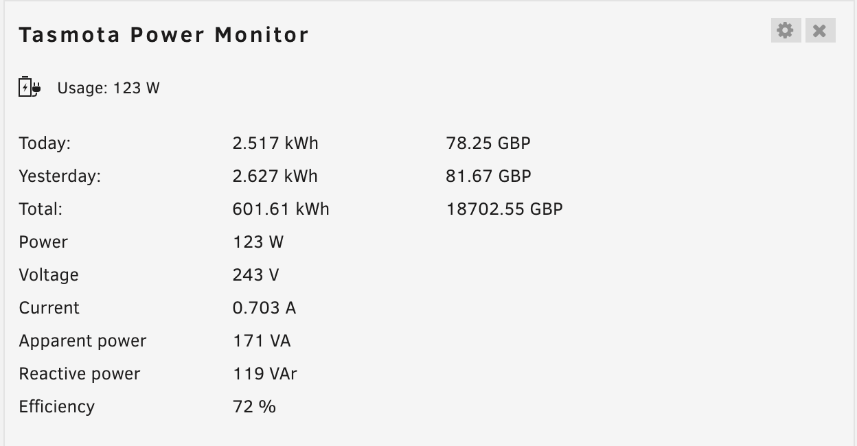

  2. I've just submitted a PR
  3. Found the problem, it is indeed recursion: https://github.com/SimonFair/tasmotapm-unraid/commit/42d19aa714319843114c626059dd9c5fae094a90#diff-ffc2f4755a67ff8df0cc721d1c185eee2502fd60ec1193caf6b36ecb34f1b9dbR106 The setInterval call needs to be at the page level as its a repeat call not a delayed call, as at the moment its nested within the tasmotapm_status() method, meaning each time its calling itself N+1 times. The fix should be to move the setInterval call outside of the method. You can replace the page load call to start itself with the setInterval code. I can submit a PR if you'd like.
  4. Doing some debugging, it appears to be an N+1 problem. For some reason, the network calls to `/plugins/tasmotapm/status.php` are being stacked upon each setInterval call. When each interval passes, by default every 1000ms, N+1 calls occur. Thats how it spirals so quickly.

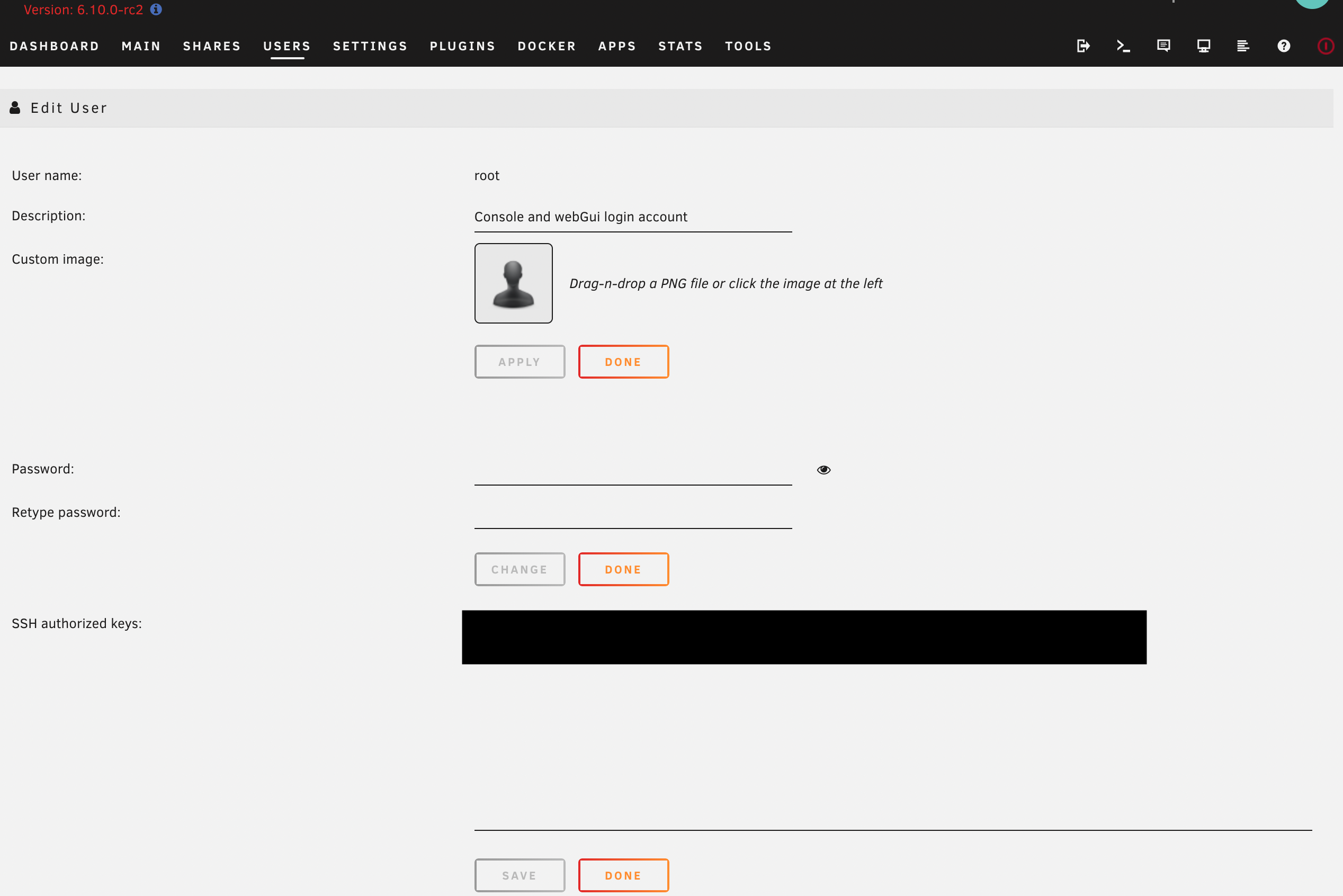

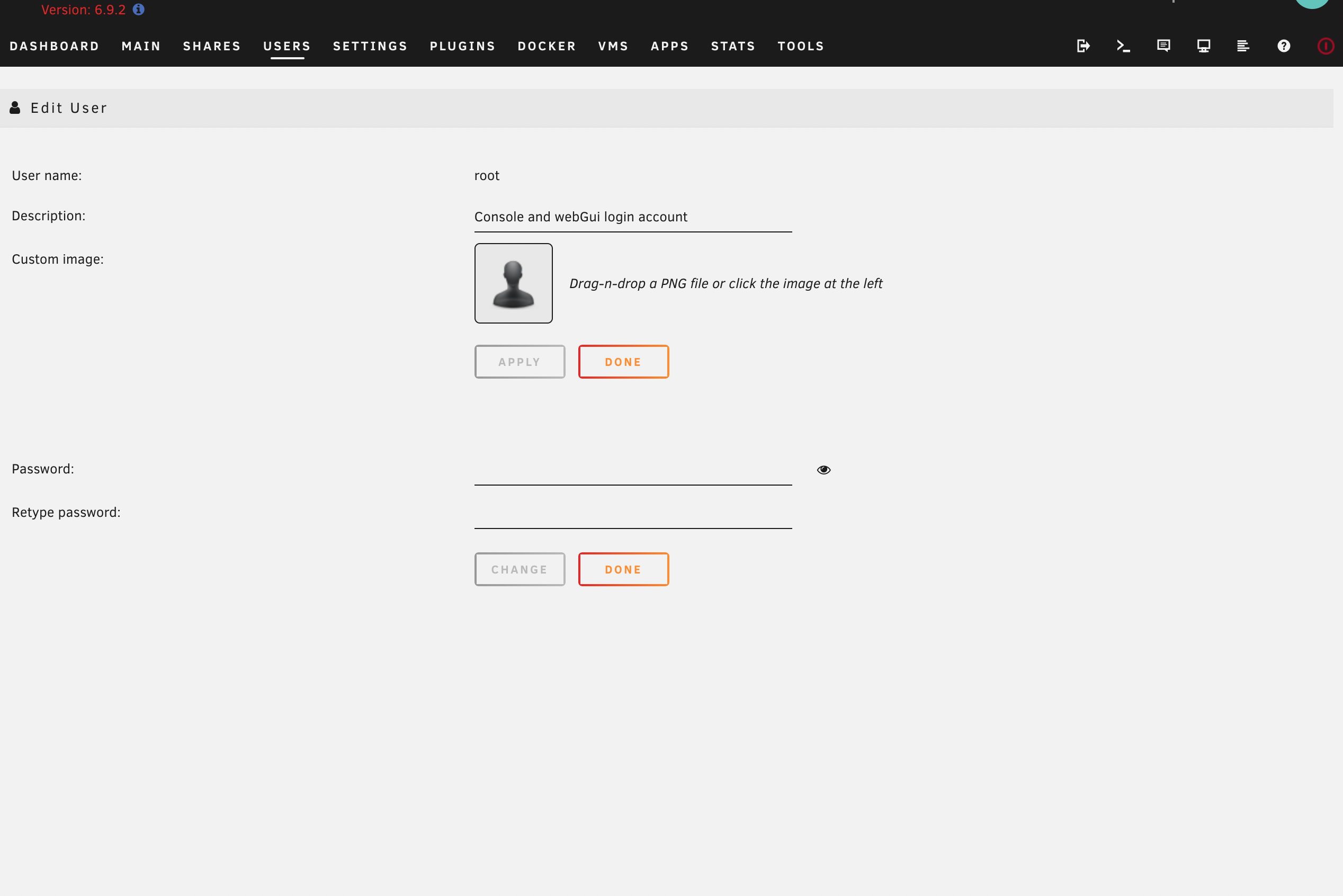

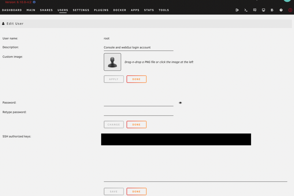

  14. Doesn't appear to work on Unraid 6.9.2, as I can't get the WebGUI to load the 'SSH authorized keys' box on the 'Edit User' page. Both of my other 6.10.0-rc2 boxes however loads this fine. Logs are empty and so is the console, there doesn't appear to be any errors, it just doesn't load the WebGUI on 6.9.2. See attached both screenshots. Should also mention I've done multiple re-installs, which has no effect. 6.10.0-rc2: 6.9.2:
