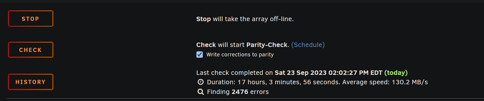

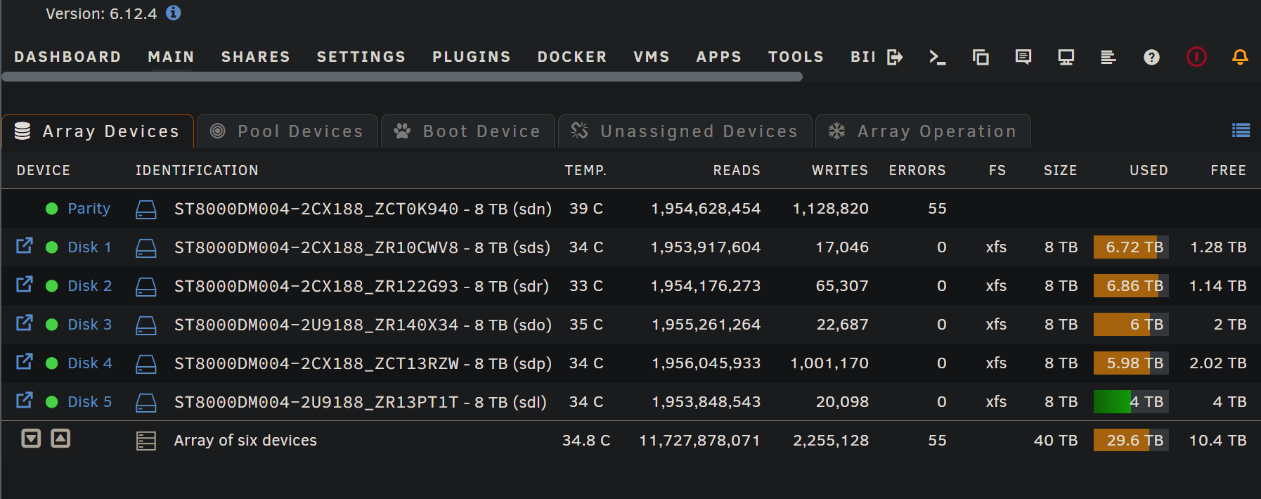

I was talking about the 55 listed in the error column on the array devices tab, but looking back at my email alerts from the previous month with errors, there were 3000+ so it was a different "event". I REALLY thought I had replaced parity when I pulled the pairity2 drive that was in there... It may be a week or 2 until I research (and get a little more coin together) something like 16tb+ enterprise drives, at the minimum a single drive to start with parity. SO, in the meantime, I think I will pull 2 of these 8tb drives from the Truenas box and get them running pre-clears in unraid... then rebuild them as parity/parity2 (not sure if I can do that at one time)... unless replacing disk4 is a better option (although these are gonna be in that 3+yr range as well) as it looks like it was disk5 I replaced earlier this year... I'd love to be on like 4 x 20tb drives by end of year if possible, so I can feel SOLID about this media server, and use the other drives to learn new stuff with... I just have so many issues to resolve on this unraid server... this macvlan to ipvlan has been confusing for me, as by the time I had read and re-read how to setup ipvlan with multiple nics, only to have that seem to be fixed in 6.12.4 (yet fix common problems still gripes), but mainly I need to track down why accessing this server seems SO LAGGY for the last few months... from wired and wireless connections... its possible that its network related, but learning wireshark at the same time has got me moving VERY slow to figure out what is going on... Here is all I REALLY know: when I first upgraded/migrated from a dual xeon X5680's with 72gb ram to a AMD Ryzen 7 1700 w/32gb seemed to perform at a similar "feel" to the old server for a few months... then got worse... I always planned to upgrade to a 5000 series cpu (never even intended on the 1700, it just came with the MB I bought) but I don't want to throw money at a problem atm if that isn't the main issue... I will start the correcting parity check now, and move on from there... oh, and file system on disk4 and extended SMART test @JorgeB recommended as well, and I guess post the extended SMART results would be req'd Again, thanks for your help, I will report back and/or mark solutions afterwards. -G
Help with parity drive maintenance. (bad SMR drive situation I think)
I am on the 6.12.4 release. First, I am using shucked Seagate 8tb drives from Costco (bad habit I started years ago) I replaced Parity and Disk4 earlier this year. I had a bad cable off my HBA that led to some CRC errors on a few drives, but that resolved when the cable was replaced... (I believe, since they haven't increased since) Now I am getting a 187: Reported uncorrect error that iirc can be a bad sign. My plans are to start moving to larger/enterprise drives (or at least NOT more SMR drives) starting with parity... but I haven't had the time + money to sit down and research deals. (so if anyone has GOOD info on that front, TIA!) So, for now I am trying to determine the best path forward... I have another 8tb or three sitting in a old dell t7500 I am messing with Truenas Scale on, but they are as old or older than the others and have many of the CRC errors from the bad cables mentioned, but haven't increased since moving them, and can certainly be pulled to replace the parity drive here (or add a second)... whatever is the best course of action.... that is what I am really asking I guess... what to do, what to do.... As a second (related) question, when I had a bad shutdown (last night) and after like 20mins I hard reset and it started a parity check... that is all normal behavior. However, the last 2 times it has done a parity check it has found errors (today like 2476) it doesn't tell me anywhere I see that the errors were fixed, do I need to do anything (like start a parity check manually with the box checked). But that error count of 55 confused me (not sure if that is new errors since the 2476 or in addition to them... just need some clarification on that part (might be helpful to be more explicit if they are being repaired the first time OR that you need to do something after it is completed. I guess I am wondering if I have all of the errors STILL because I didn't correct them last time this happened (first time I got errors on a parity check) or if these are NEW errors since that time. And here is the diags: ezra-diagnostics-20230923-1552.zip I really appreciate the help, and thanks in advance. -G
