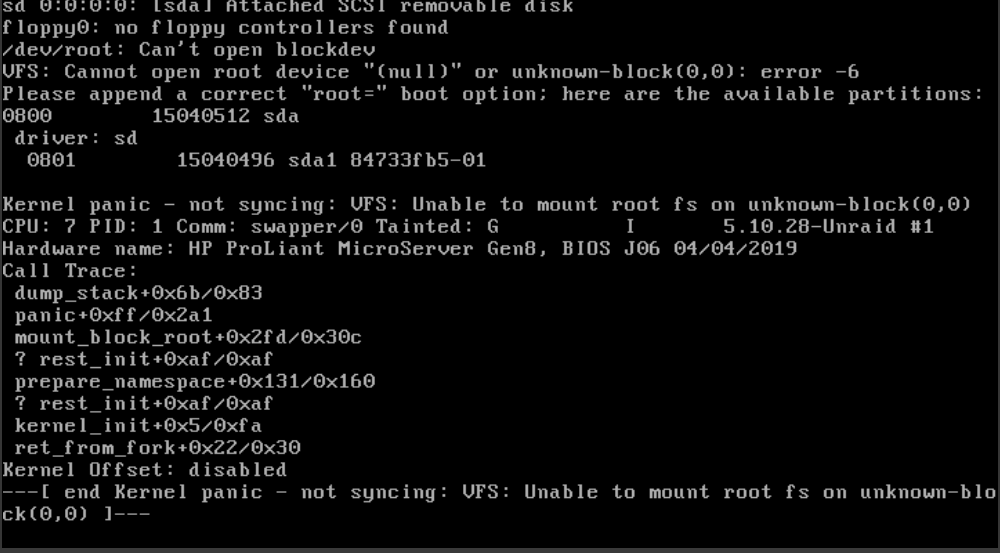

I did reboot yesterday which was fine. I just rebooted again and the kernel panic is gone and everything is back to normal. Any idea what went wrong ? It's as is something is trying to break. Flash drive trying to die ?

Hi, Strange thing happened yesterday. Out of nowhere my zigbee2mqtt docker stopped recognizing the usb coordinator (I was setting up some devices and a minute later the docker is down, log says 'path not found' to my usb device. Did some troubleshooting, e.g. tried adding the same USB device to a different docker which worked - I was able to see it in /dev/serial/by-id/... I had to leave it for next time. Just came back to it and tried restarting the docker service via GUI, however it wouldn't restart since some paths are incorrect. Went to terminal and realized that /mnt/user/ doesn't exist anymore (only /mnt/user0 / and other directories). Not only that - all the shares have disappeared in the GUI. What happened ? I'm confused...happened out of nowhere - no major updates, nothing. After typing the last sentence I thought i'd reboot and got this 'kernel panic'. Seems like something broke before the docker issues. Although Unraid didn't show any errors, all other dockers worked and I was able to access the array. Thanks
