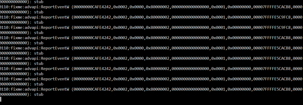

  3. Both of my Conan Exiles docker containers seem to be running out of memory. I originally suspected a game memory leak but I can see that the server is using between 4.5 and 6 gbs before it crashes. Both my Siptah and Exiled Lands servers do this. The error is always the same at the end of the log: [2024.06.23-14.58.17:337][ 79]LogMemory:Warning: Freeing 33554432 bytes from backup pool to handle out of memory. [2024.06.23-14.58.17:337][ 79]LogMemory:Warning: MemoryStats: AvailablePhysical 11342008320 AvailableVirtual 140731004248064 UsedPhysical 0 PeakUsedPhysical 0 UsedVirtual 0 PeakUsedVirtual 0 [2024.06.23-14.58.17:337][ 79]Allocator Stats for binned2 are not in this build set BINNED2_ALLOCATOR_STATS 1 in MallocBinned2.cpp The server has memory available - total of 32gbs with over 14 available even with both servers running. I tried running only one of each at a time, same issue. It happens within 20-30 minutes of game play, sometimes it happens immediately upon login attempt. Single player instance doesn't have this issue when I attempt it. And this only started after the last posts I made when the yearly base image patch was done and I had to delete the WINE64 directories to fix the issue. I found an older post (https://forum.winehq.org/viewtopic.php?t=34322) that seems to indicate an issue with how WINE allocates memory. Any ideas? Worst case I migrate the servers back to a Windows VM. Your work is much appreciated, thanks!
  4. Looks good and is working great! I could've sworn I was seeing server logs appear in the docker log. Admittedly I know very little about WINE and I don't know how an image can be configured to show certain logs in the container log, but I do think the WINE logs make it a bit confusing. Usefiul if there is a problem, but I think the server logs being shown is a better default as they are used more often than the WINE log. Thanks again!
  5. Interesting. The server does appear to be running now. I believe your suggestion to delete WINE64 did it, but the docker log shows all those errors still. The Conan log appears to show the server is up an running and I can now see it is online and connect. I restored the original game data directory and deleted the WINE64 directory and both servers are now back and connectable again. As you suggested, seemed like an issue with WINE. Worth noting that the docker logs used to show Conan server events and information, but now they do not and I can only find that info in the game server logs directly. Thanks for your help!

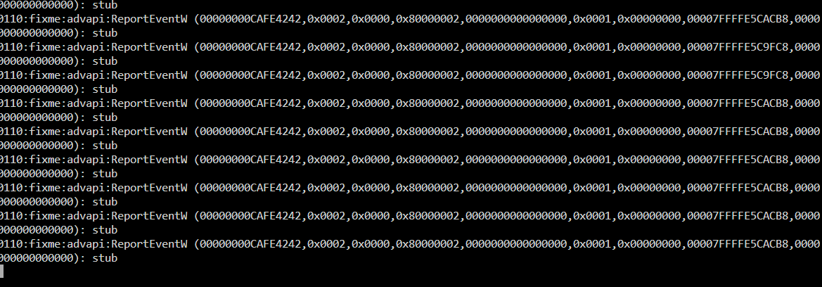

  6. Seems to be giving me the same error. Here's the docker log from the shutdown onward:dockerlog.txt I'm going to disable the 3 mods I have and see if that has an effect.
  7. I see that some people have been having issues since the recent update. I too am having an issue with the Conan Exiles container. I'm getting the following error: This just repeats indefinitely. Both my Conan Exiles containers are doing the same thing since the update. So I stopped the container, renamed the server data volume so the container starts as if it was new. It downloaded the game, but it never came online. I just continued to throw these same errors as it did before.

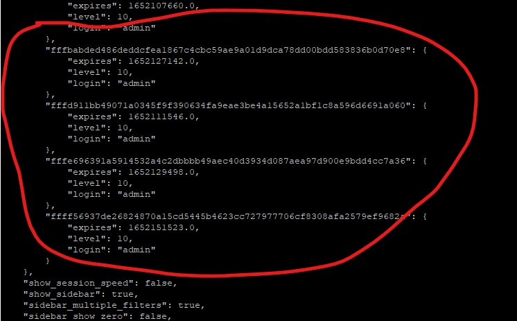

  9. My file has now more than doubled. It's 977,920 lines long, all but 25 or so lines are the sessions. 35 mbs in size. Something is definitely not functioning correctly here. These sessions shouldn't be accumulating like this and they should get cleaned up.
  10. Interesting. Mine is 12 megabytes. When you say you deleted the sessions, you went into the JSON and removed these records: Of course, there are hundreds/thousands of these in the file. I wonder if deleting the file itself would cause an issue, or if it would just recreate a new one? I may leave them because the web ui is running, and watch it to see if they get cleaned up at all by the application.

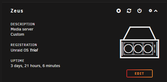

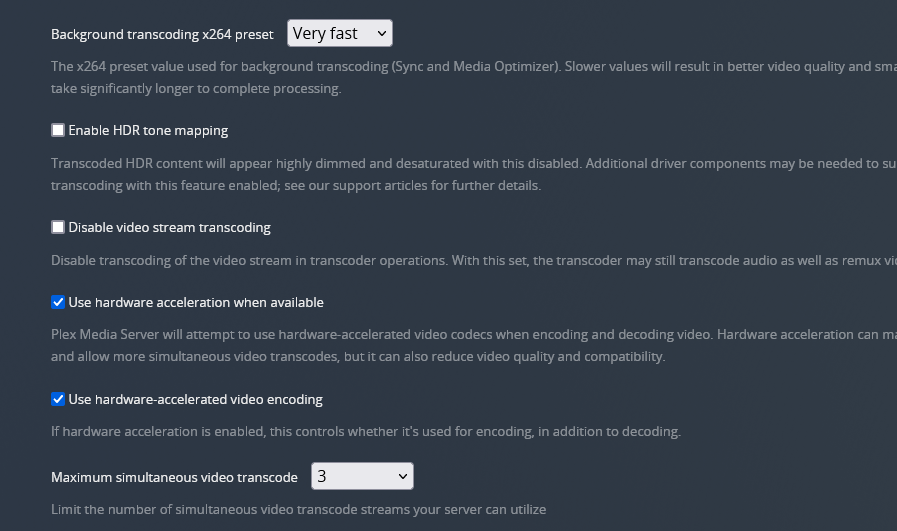

  13. I can report that my unraid machine has now been online for 4 days with no crashes. The culprit seems to have definitely been the /dev/dri being added as a device to the Plex container. I can confirm that I have HDR tone mapping disabled: So I don't think HDR tone mapping was the cause of the crashes, at least not for me because it was not on when I had the /dev/dri device added to the container. I still suspect it has something to do with docker or the container moving threads across the efficiency cores and the performance cores. I'd like to re-enable the hardware transcoding and test it by pinning the container to only the performance cores of the CPU. But before I do, I want to ask if anyone else has had similar problems? It seems that others have had no crashes when they add the device to the container so long as they have HDR tone mapping disabled, but that was not my experience.
  14. I can report that I have now been online for 1 day and 20 hours with no crashes since I removed the device /dev/dri from the Plex container. If it remains stable for a few more days, I may re-add the device and pin the Plex container to the efficiency cores of the CPU. It's possible threads moving across different types of cores is what causes the crash, but this is pure speculation on my part so I'll have to test it out. Thanks for this tip! I actually worked late last night so I never attempted the memtest. I'll have to do it this way to save me the trouble of switching to legacy boot. I've never even tried to do GUI mode. I've only ever connected remotely or through command line directly on the server.
