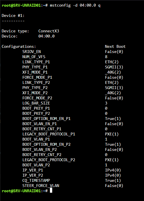

  7. Hi, yep I've got it working now. Had to use PHY_TYPE_P1/P2 to set the physical type first, then reboot and you can then set the link type via LINK_TYPE_P1/P2 and reboot again. If anyone comes across this, setting the PHY_TYPE_P1/P2 to SGMII(3) seems to result in best performance, though I still have some testing and tuning to do. You can use mstconfig -d 04:00.0 query to show the current settings and options as below. You may need to change "04:00.0" depending on what your Mellanox card reports via lspci.
  8. Hi there, I'm using the Mellanox Firmware Tools plugin and I'm having some issues getting my ConnectX-3 card out of VPI and in to Ethernet mode. When running the command "mstconfig -d 04:00.0 set LINK_TYPE_P2=2" (same on P1) I get the message after confirming to apply config -E- Failed to set configuration: illegal Phy Type value (shold be 1|2|3). Any suggestions. These are IBM branded versions if that helps. Not sure if they need a specific firmware flashing. Specific model is 00D9552, which I believe is the MCX354A-FCBT. I updated to the same/latest version for both adapters on a Windows machine EDIT: Right, so you need to set PHY_LINK_P1/2 to 1(xaui) 2(XFI) or 3(SGMII) before it will allow you to change the link type. No idea which one of those is appropriate and can't find much about it really. Removed the network and network-rules.cfg files and rebooting to see what happens. It did pick up more NICs but all were showing the same MAC address at first
