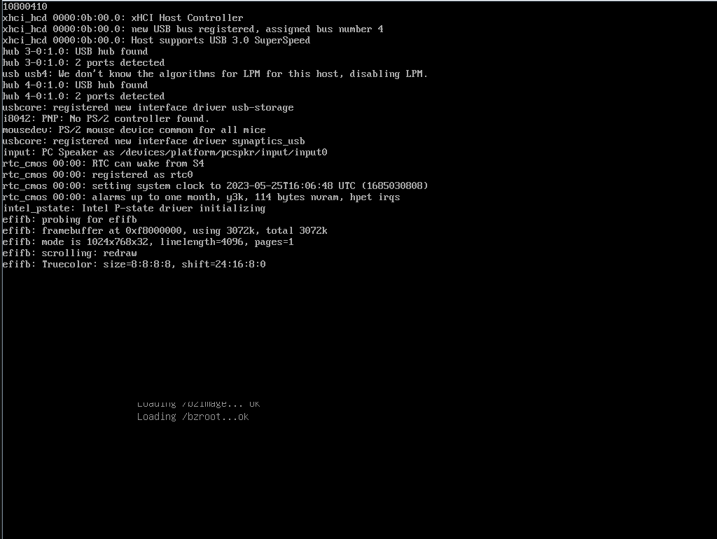

Hi, I'm having an issue with unRAID hanging on boot after changing CPU. It loads part way but then will just hang with no further progress. System is booting from UEFI, as it did before the upgrade. It seems like it outright freezes rather than hanging to be honest. Sometimes it will freeze at different times. Booting into safe mode makes no difference. Suggestions welcome
It sometimes gets a weird graphical error where the loading /bzroot...OK stays on the screen when it freezes
System specs:
Intel Xeon E5-2697Av4 (old CPU was Intel Xeon E5-2690v3)
Asus X99 WS IPMI
128GB 2133MHz ECC RDIMM
LSI SAS HBA
Mellanox X3 Connect
See attached image for where it gets stuck. It's not always in the same place

Found it to be a faulty core. Narrowed it down to core 11 being defective. System boots with core 11 disabled but fails with it enabled.

On mine, it was reporting MCE errors for core 13. Though the way the Linux kernal and the BIOS sees cores is different it seems. I went through each core until I found that core 11 was causing the problems. If I disable core 11, system boots fine. As soon as I re-enable it, system will fail to boot.

That was during booting into unRAID, yes. I control my server via an IPMI interface over the network, but having a monitor plugged in while it's booting would accomplish the same thing
