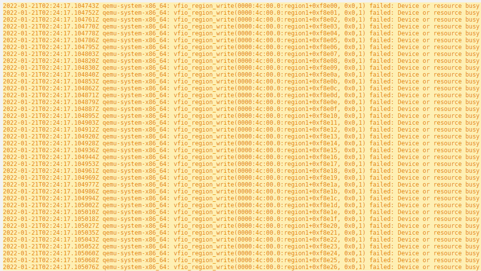

  2. I believe you are right, as the monitor displays the unRaid command line interface indefinitely regardless of the vfio stating its taken over or not. Sadly passing the vBIOS doesnt work either, so im wondering if maybe this is just an NVIDIA thing? I know in the past that NVIDIA gpu were hit or miss with passthrough if they were the only card present, i just figured that would have been fixed by now. Idk where to go from here really except buying a 2nd gpu sadly
  3. well its still using it at boot to display unraid terminal and wont let me use it for VM so im confused.
  4. Okay, it appears if though unraid believes its binding it, but then doesnt bind it...
  5. The only option i see there is to select both the vga and audio and "Bind Selected to VFIO at Boot". Would that not force unRaid to use it on boot?
  6. I am currently working on passingthrough a GT 730 and having trouble getting unRaid to stop using it. I have previously passed through this gpu without any vbios or issues, but that was with x2 GPU installed. I know it is possible to stop unraid from binding the GPU on boot but it doesnt seem to be working. What am I doing wrong? syslinux config: kernel /bzimage append vfio-pci.ids=10de:1287,10de:0e0f pcie_override=downstream,multifunction initrd=/bzroot

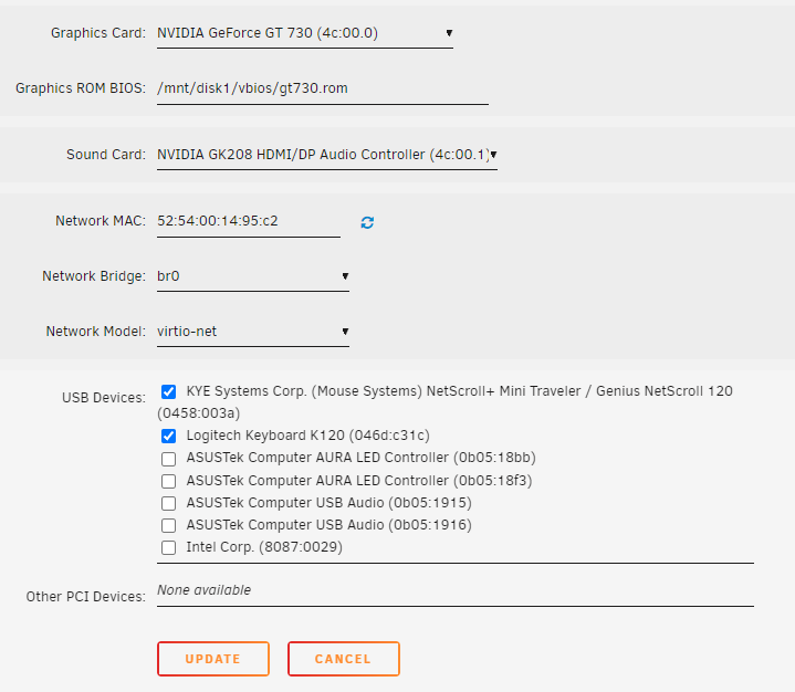

  9. When using VNC the windows 10 vm boots normally without issue. However when trying to passthrough my gt710 it gets on a loop of displaying the tianocore logo for 15sec, then showing no input on monitor, and then showing the tianocore logo again. I dumped the proper vbios and have both the gpu and gpu audio selected. the gpu is also in the 4th pcie slot and i have a different gpu in the 1st slot not currently being used for any sort of passthrough. What am i doing wrong?
  10. I am trying to passthrough an Asus GT730 and need the vbios for it. The model i am using is GT730-SL-2GD5BK. The only vbios i can find is for the older Asus GT730 model with DDR3. Will this still work? Edit: Dumped the vbios for my GPU using a user script.

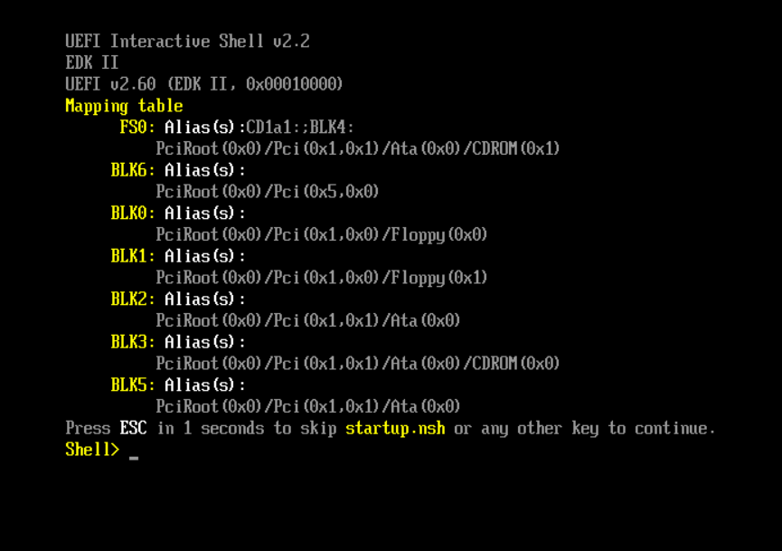

  11. Trying to create a windows 10 VM and getting this page? Ive never seen this page and have no idea why its randomly appearing. Using unraid 6
  12. OMG i feel so dumb . Thank you so much that worked.
